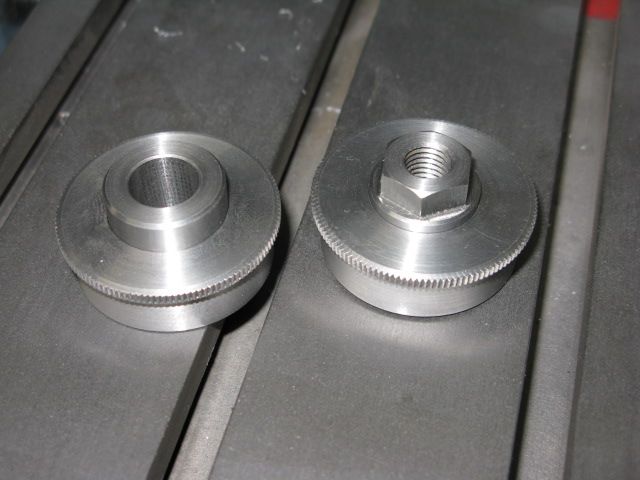

          I'm in the middle of making a pair of these dials using the W61510 wave washer from Bearing Boys, The wave washer supplied must be slightly different to the ones it is designed for. The wave measured .100" instead of the .125" stated in the article, and my impression is that the washer is a bit less wavy and a bit more weedy than the design one. After a bit of experimentation on a dummy hub I've made the .220" length on the hub drawing .260" and the step that the wave washer fits over .040" long instead of the specified .080". This gives what I feel is the right amount of resistance whilst adjusting ok, might have made the adjustment a little stiffer than some might like but in this case I think it suits the application. It's to fit a shaper rather than a lathe, so some of the hub details have been altered, but otherwise everything else is to the published drawings and it all goes together well. Just something to bear in mind if using the wave washers supplied by Bearing Boys. Their service was excellent, washers and circlips arrived morning after ordering. Graduation and stamping next, I made some spare dials, just in case!

            img_0407.jpgJust been out and reassembled both dials with their respective hubs, washers and circlips, just to check the feel of the adjustment, and found the action to be pretty much the same as the factory dials on my 254, so I don't thnk the dimensions I've given above are too far off. couple of pictures of both the dials fitted together and of one fitted to the cross feed on the shaper. img_0405.jpg

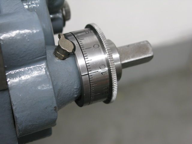

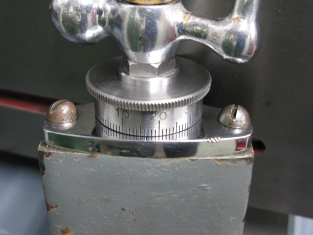

                      img_0416.jpgFinished making and fitting the dials from Hoppers excellent article in MEW, adapted slightly to fit a shaper the basic design follows the published drawings. Indexing of the graduations was done using the hacksaw blade ratchet detent from the article. I had to fiddle about with the change gears a bit to do it on my 254 as the changewheel arrangement is different, but with a couple of idlers in there it all worked out fine. The ratchet idea was so much easier than the fraught time spent graduating a small rotary table with a dividing head. Numbers were stamped in a GHT pillar tool as the fittings for stamping were already made, one great tip in the article is using masking tape for initially setting up the stamping, a very slight but seeable impression can be made in the tape.There was one bozo moment when I put the stamp in the jig 90deg out, but a drop of soft solder and some filing and it can't be seen easily. Pictures show the dials fitted to my Acorn shaper which is undergoing a rebuild, had to make a narrow ring to carry the fiducial mark for the cross feed, the only modification needed was two small tapped holes to retain this. The downfeed dial is tapped 3/8 BSF as was the original. Altogether a very interesting little job that was a pleasant change from all the cleaning and painting. Well done Hopper!img_0412.jpg

                        If you don't have a bozo moment every once in while you're not doing anything, nice job by the way.

                          Thanks Dave, it looks good. Great to see my design in use. I like the tip about filling the duff number with solder and restamping. I might have to give it a try on that misaligned 0 on mine where the cheap number punch was made off-centre. Yes I liked the hacksaw-blade ratchet idea a lot too. I think I picked the basic principle of that up from one of the old books by Ian Bradley (Duplex) and it certainly works well.
