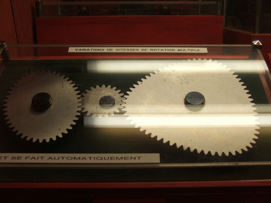

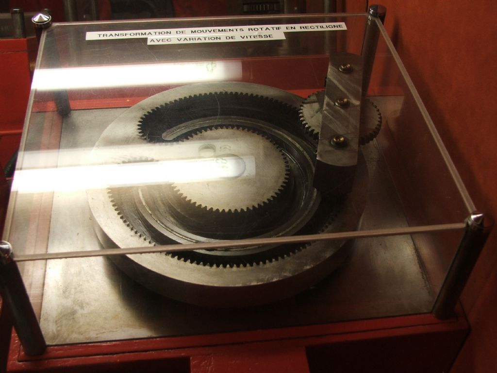

                    Nimble
                      @nimble
                      Seeing this posting I thought I would post some pictures of odd gear sets that I photographed in a Renault Museum in parisodd gear.jpg
                      Edited By Nimble on 26/05/2020 03:05:29
                      Edited By Nimble on 26/05/2020 03:06:46
                      #474965
                      Nimble
                        @nimble
                        #474967
