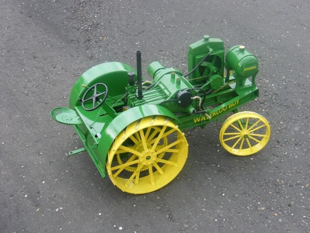

        waterloo boy 003Hello All I thought I would take this opportunity to thank you all for you help and suggestion over the last year. I thought you might like to see some photos and a video of my completed model.
        It is a lookalike of the Waterloo Boy which was built in US around 1914/20. It was the forerunner of the John Deere tractors that are so common today.
        My model is a 2 cylinder 4 stroke petrol engine with one forward and 1 reverse gear as was the original. however my one was all built entirely from bar stock, I also cheated a bit with the ignition using modern electronics As an afterthought I fitted it with RC operating the Steering, Clutch/ Brake , Gear change & throttle. Some of you will remember I asked for advice about cutting internal tooth gears for the drive wheels as were correct on the model N, but as this was beyond my capabilities I used external toothed gears which were correct for the earlier model R.
        Thanks again Farmer Dave
        here is a link for a video **LINK**

                Wow Dave that's a great model, what scale have you built it to just to give us some idea of its size.
                Stew

                        Andy, at the moment I am revisiting a 4cylinder 4 stroke I built last year making a fee mods.
                        Stewart, Its around 1/8 scale 400mm x 220mm rear wheels 200mm dia.
                        Jason, you will need to wait till tomorrow for your photos Its raining cats & bogs at the moment.
                        Neil , showing my ignorance what is NASCAR, I built it for my own satisfaction just to see if I could . I started with a photograph of the full size tractor and worked from there with the help of a fag packet and some head scratching.
                        Olballie, Its a 2 cylinder 4 stroke of my own design, 24mm bore x 25mm stroke ,Ill leave it to you to calculate the C.C., water cooled petrol engine, with Rexel electronic ignition through a distributer, and drip lubrication to the crankshaft .
                        I thought a driver would make it look more like a toy than a model. just my opinion.
