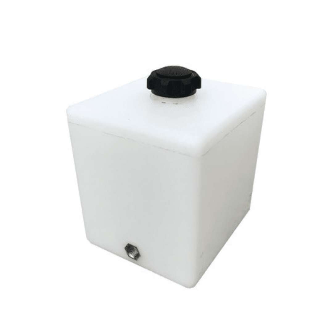

      I need to make a water feed tank for my Speedy loco which would be housed in the driving trolley.
      For choise of materials, I could use zinc sheet (Brass/copper a bit expensive in comparison)  or some sort of plastic.
      If Zinc, would this affect the boiler water (water temp would be ambient in the tank).
      If plastic, what sort of plastic could I use which is solvent “joinable” and what plastic would I use for the water connection bosses which is easily machinable.
      Tank volume about 8 litres.
      thanks in advance
      Bob

              High Density Polyethylene,  HDPE, is a suitable material for making a tank.  It as available in sheet form and can be thermoformed with a hot air gun and welded with plastic filler rod. One source, but normally in thick material, is kitchen cutting boards. Another option would be to reshape a 20 odd litre existing container. This could have filler and outlet bosses pre-moulded. Lots of AdBlue containers around.

                      Thanks for all suggestions, I think I will research the plastic pipe idea, perhaps a double bubble (two pipes, one on top of the other). As others have said, even the fittings are easily available.

                          A 100mm dia pipe will give me approx 3.8 litres which is more than enough. I don’t need to “overload” as it all just gets heavier to to lug around.  I was lucky to find an oil central heating boiler vaporising head which has a sintered pre filter which I have incorporated into the injector cold water feed.
