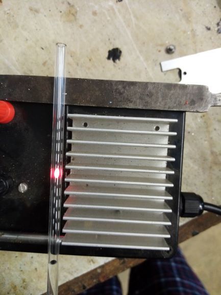

                                Although not explicitly stated in the original post, this is for the gauge glass on a model boiler, so it is hot, potentially 160C+. I think this rules out Martin's link, which quotes a max temp of 80C. Otherwise that seems very similar to the one I linked in the original post. I think it also rules out plastic floats. The glass is 6mm OD, 3.8mm ID, so SOD's idea of sonar would need to be very small and tolerant of heat. It's for a test boiler, so demand can vary from nothing to max, and it might not be driving an engine, or the engine might not have a built in pump, so John's fixed pump displacement won't hack it. It won't have a hot well, so that's a non starter
                                I've just spent a fruitless hour trying to find the slotted opto I know I've got. I've obviously put it somewhere safe. I'll have to wait until my opto transistors arrive.
                                As to why not just copy the original, well I wouldn't learn much doing that, and even at my advanced years that is a big part of why I set about things.
                                I'm beginning to think that Michael's idea of cylindrical lens might be the answer, if the water makes it splay out like a fan it would cause a step change in intensity, same amount of light in a wider beam. I'm going to rig up an LED facing a tube and have a play, but tomorrow, tired out by birthday festivities.
                                I quite like Noel's capacitance idea, but it's beyond my electronic expertise. Are we talking relaxation oscillator and phase locked loop chip? If so I've just bought some of those for another project, but I can't find them either!

                                  Posted by duncan webster on 04/03/2021 21:58:33:
                                  Using my arbitrarily chosen numbers: The empty tube splays it more than the water-filled tube; but yes, there would be a step-change in intensity.
                                  If you can give me actual diameter, bore, and refractive index … I can demonstrate.

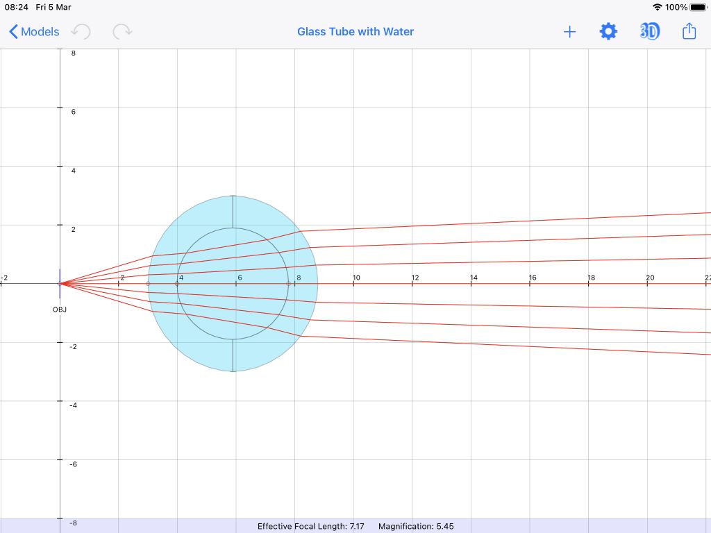

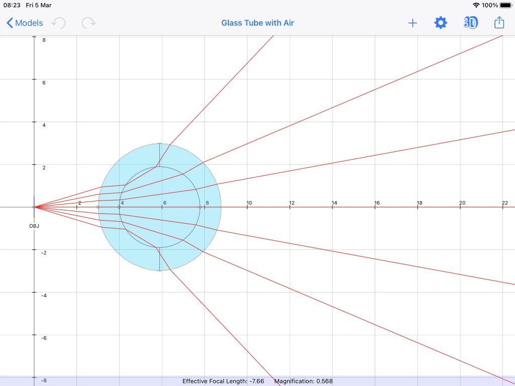

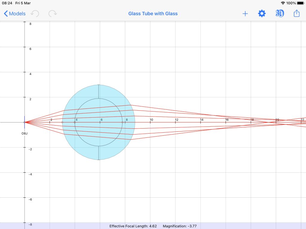

                                        #531762
                                        duncan webster 1
                                          @duncanwebster1
                                          It's what is sold for gauge glasses, I'd guess borosilicate but no evidence
                                          #531789
                                            Here we go, Duncan …
                                            Tube OD 6mm, ID 3.8mm, Material = botosilicate glass
                                            Red light from a point-source 3mm from the tube surface
                                            Tube filled with Air / Water / Glass
                                            Q.E.D.

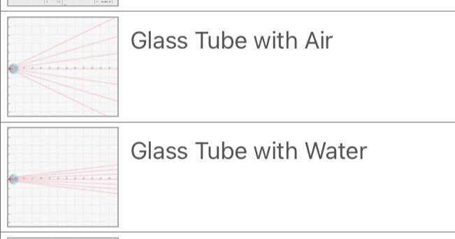

                                              #531798
                                                Posted by Chuck Taper on 05/03/2021 08:54:41:
                                                I'm intrigued – how, what etc??
                                                What software is that?
                                                Regards.
                                                Frank C.
                                                RayLab, by Kamyar Ghandi … Running on iPad Pro 9.7”
                                                **LINK**
                                                https://apps.apple.com/gb/app/raylab/id710190065
                                                … I gave it a rave review

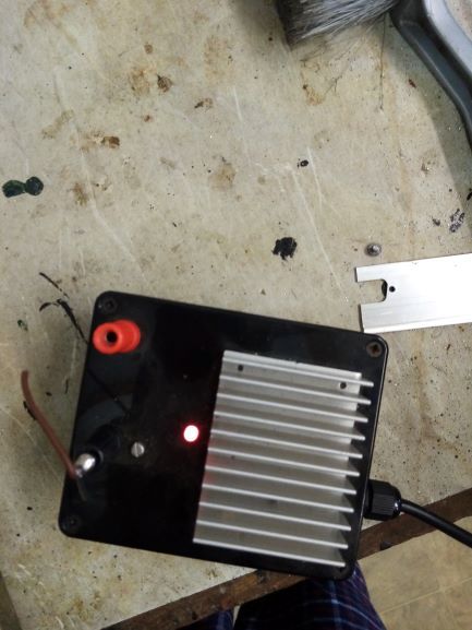

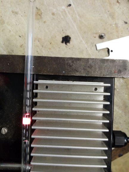

                                                    duncan webster 1
                                                      @duncanwebster1
                                                      Michael's ray plots are extremely interesting. While I get my head round them, I've done what I should have done right at the beginning, got off my backside and done some investigating
                                                      first photo shows a 5mm LED, no glass, just to get a baseline
                                                      then with just the empty glass tube, note how the LED appears much narrower, and there appear to be 2 red edges
                                                      Then with water in the tube, the image fills the tube and seems much brighter, at least to my eye
                                                      I'll have to wait for the phototransistors to arrive now, but at last I'm beginning to see what is going on. I have a feeling that if Michael widened the beam slightly on his with-water plot he'd get total internal reflection on the inner glass/air interface, which might explain the side bands on the second photo.
                                                      Now to delve into Andy's capacitor scheme.
                                                      Thanks to everyone who has contributed, quite a bit learned. And the good news is I've found the PLL chips, but not the slotted opto
                                                      Edited By duncan webster on 05/03/2021 11:31:46
