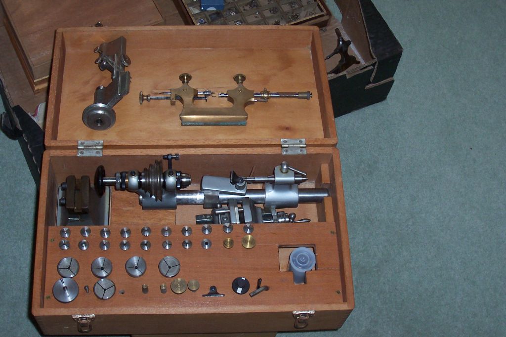

      Hi there watchmakers. I have been given (not yet received) the attached equipment. A little bit smaller than my Oxford lathe and mill drill. I sort of understand the lathe, but what is the rest of it called. What size electric motor would be required for the lathe (Speed/ power)Also, what basic books would help me master the use of them.

          Very Jealous excellent quality kit Donald De Carle is the author of the following very useful books
          "With the Watchmaker at the bench" would be my first choice
          "The watchmakers lathe and model engineers lathe a users manual" would also be helpful and much easier to find
          #179000

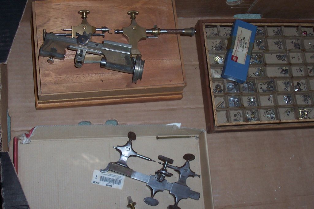

            Leaving the 'Geneva pattern' lathe aside [you will find lots of information on lathes.co.uk] … the Brass one looks like a Jacot tool, and I think the other may be a topping-tool.

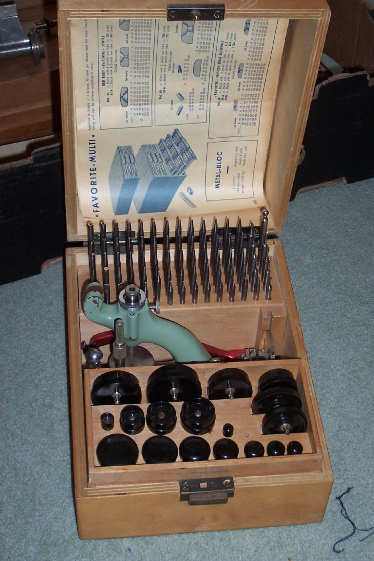

            The other big box contains a Staking Set; which is very useful … I'm sure you will quickly see how that works.
            Edit: the small "lathe"at the bottom of your picture is a Watchmaker's "Turns" … used with a Bow [traditionally a single hair from a Horse's tail] for turning very small work between dead centres.

                Just to add, not Just a staking set, but a Jewelling staking set, it has a micrometer attachment at the top for setting jewels into watch plates to a pre-determined depth – a Very desirable, less common and as you would expect, very expensive bit of kit indeed!
                If I’m not mistaken it also has a set of watch crystal (for acrylics) press tools in there, you’ll also see a chart for jewels in the lid!
