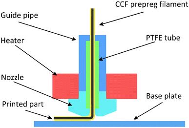

                depending on the make and model many 3D printers rely on the interface between the nozzle and the guide tube to make a leakproof seal. If the tube has turned and travelled upwards in the block it may be leaving a gap. Turning the guide tube in a half turn may fix the leak. The nozzle should contact the tube before the shoulder tightens onto the heater block.
                The diagram may help a bit. It's a matter of trying to stop the guide tube turning if there is room a couple of lock nuts on the tube can be utilized.

                  Ah, that could be it – it might be the guide tube. The old worn nozzle I took out had a longer body thread than the new one I have put in.
                  I was given this printer by my son, and I don't know all about them yet. There is a box of new nozzles he gave me with the machine.
                  I will have a look at the guide tube tomorrow, hopefully.

                    You shouldn't fit a washer. Journeyman above, has almost certainly identified the problem. The tubing can be cut back a little to give a cleaner better fit in the hotend.

                                  Journeyman's sketch didn't ring true for my Mega, so I dug out my spares to check and it is different to that shown.
                                  The sketch does not show theAnycubic heatbreak arrangement correctly – on the Anycubic print head the PTFE tube fits into a recess at the top of the heatbreak & the filament path through the heatbreak to the nozzle is not via a section of PTFE tube. The heatbreak screws into the top of the heater block part way & nozzle screws into the underside of the heatblock as the sketch shows. The amount of insertion of the heatbreak has to be such that the nozzle firmly abuts the end of the heatbreak within the heater block when it is tightened – it is this abutment that makes the seal – there is no PTFE tube section between the heatbreak and the nozzle. Final tightening has to be made at operating temperature !

                                    The hot-end on my printer is similar, except that referring to Journeyman's diagram, the light and dark blue parts butt together inside the heater block and the PTFE tube goes down to butt onto the top of the nozzle – but not into the nozzle itself.
                                    I have a brand new spare hot-end assembly, and looking at this, I can see that the PTFE pipe butts onto the top of the nozzle, but doesn't go into the nozzle. I am doing a 2 hour 45 min print now, so I will see if the seal is better after everything has had a chance to get fully heat soaked – which is when the problem arose before.

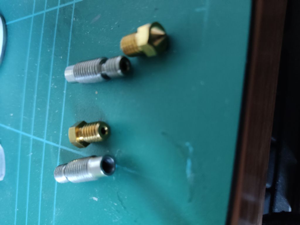

                                      Not a great picture, but hopefully you can make out the recess for the PTFE tube in the top of the heatbreak & see that the hole through the heatbreak & the entrance to the nozzle is only big enough for the filament – no room for an internal PTFE guide to bridge the gap.

                                            Lots of stuff talked about but little seems to relate to your initial problem.
                                            Leave the tube out of the head and insert the nozzle finger tight until it bottoms out.
                                            Then back it off half a turn.
                                            Make sure the end of your PTFE feed tube is cut perfectly square , there are specialist cutters to do this if you can not sort it with a scalpel.
                                            fit the tube to the head and push it down as hard as you can against the nozzle.
                                            Make sure the pipe locking flange is pulled up tight and fit a micro clip to stop it moving.
                                            Tighten the nozzle fully up to the head and this should give you the good seal to stop the blow by you were getting.
