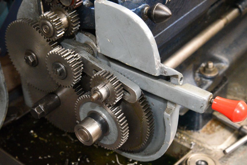

                      It was fascinating to read the patent application, thanks Michael for tracking it down. Unfortunately no clues about using the smaller gear, metric seems to get only one brief mention.
                      Below is a picture of the stud/sleeve/key arrangement. It might be possible to make a stepped sleeve that would allow the use of a gear with a reduced bore.
                      Still going to be tight, but worth investigating. Rod has very kindly made a couple of 17t gears, one of which is un-bored so could be adapted for use on a stepped sleeve, so I may now have a potential solution that would retain the originality of the unit.

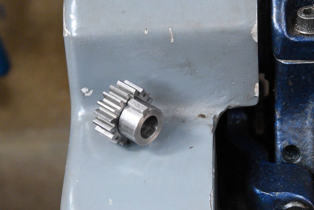

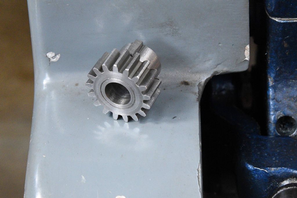

                              Some photos below of the solution that I arrived at, using the 17T gear that Rod very generously made. The mounting stud is 0.375" and the standard Myford change-wheels are 0.625", so I bored the 17T to 0.500". This was then Loctited and pinned to a stepped sleeve, the other end of which was milled for a keyway to take the standard gears as required. Seems to work fine, usable on Stud 1 and Stud 2. Thanks to Brian's mathematical prowess I also have a set of alternative gear combinations to make finding a suitable set-up even easier.
                              Thanks to all for your help, the generosity of Forum members is amazing. I hope to be able to make a similar contribution at some time.
                              Philip
