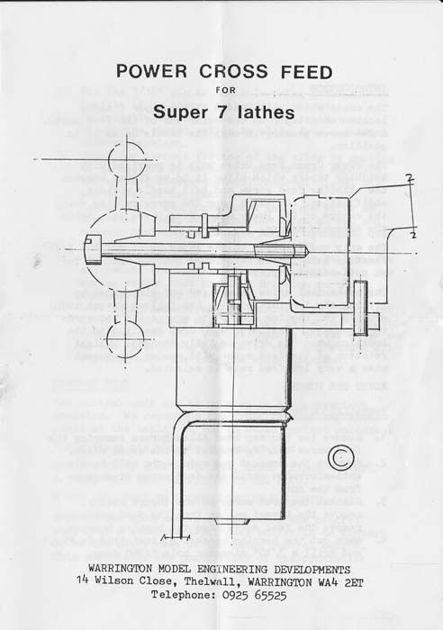

          Didn't they make a power cross feed attachment [electric motor] for the Myford 7 lathes a long time ago?

              Intriguing. I've got a WMED power cross feed but have never heard of the Easychange. Is it possible to get a picture of the unit from the VMCC poster? Is the 17t gear the standard 20DP 14.5 degree with a 5/8" bore and 1/8" keyway?

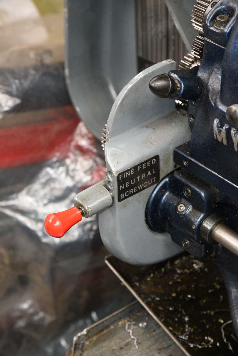

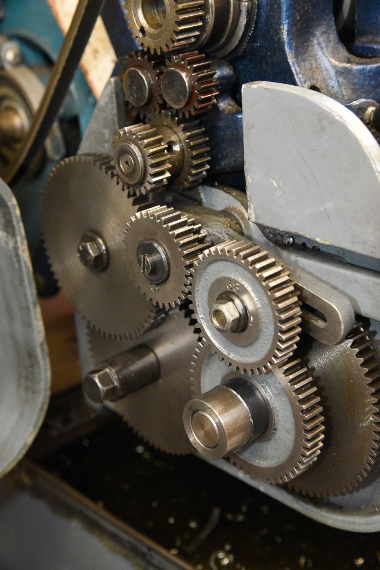

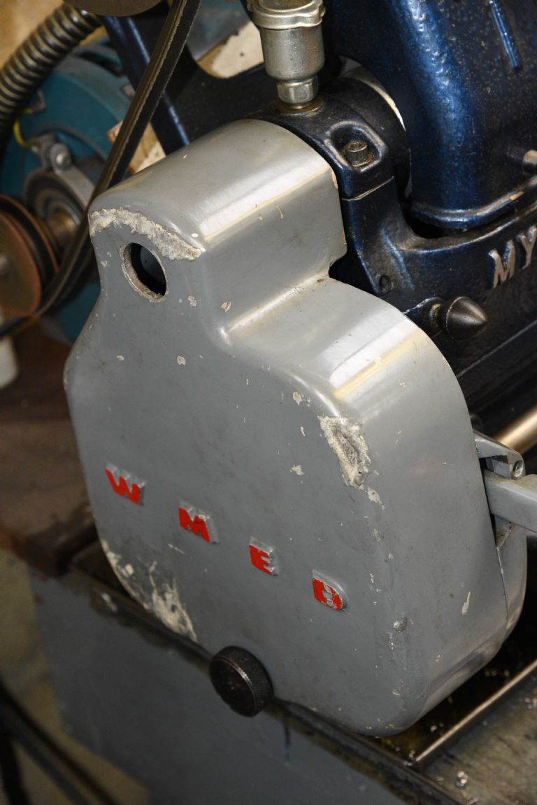

                              Please see below a few pictures of the unit:
                              As can be seen from the above chart, the change wheel combinations differ from the original Myford suggestions. This may be because the increased complexity limits the gear combinations that can be accommodated. 1.25mm pitch can be done using 30:38 + 25:50, but none of the recommendations for 1.5mm (at least, those that I've tried so far) will fit. Finding a 17T gear would be the ideal solution.

                                Wow. That's quite the set-up with its own cast cover and handle and all. Thanks for posting the pics. Much appreciated.

                                        I am curious about the second set of gearing visible behind the change wheels for screwcutting, I assume these are for the fine feed, to be brought into operation only when that option is selected.
                                        It is a neat concept and it has some similarities to the DAG Brown system for metric gearing via a second set of parallel gearing for lathes equipped with the screwcutting gearbox. Perhaps the rather essential 17 T gear was supplied with it as part of the package when it was bought originally since without it, much of the table for metric pitches is not available for use

                                            Thanks for your comments. You are correct, the second set of gear wheels are bought into use when fine feed is selected.
                                            I unfortunately don’t have any more information on the unit, it was fitted by the previous owner, a friend who was selling due to ill heath. I suspect that he bought it secondhand, as he meticulously documented all aspects of his workshop but I can’t find any reference to WMED. As you suggest, supplying a 17t as part of the kit would have made sense.

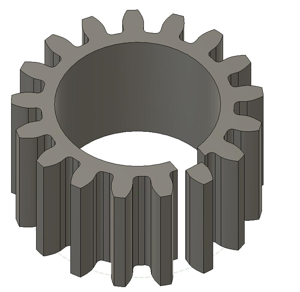

                                              If you get really stuck I could make you a 17 T gear in steel but it might also be possible to calculate a new set of gearing about a 34 T gear which would I think be a better choice. Apart from any other consideration, the tooth loading is much lighter and gears in that size are available from the usual suppliers from time to time

                                                There does seem to be a bit of a problem here: You can't actually mount a 17 Tooth gear on a standard Myford stud and keyway:
                                                Rod

                                                  Unless it used a non-standard key that did not stand up so far above the stud?

                                                    Hmm, I did wonder if it might be a bit tight, the smallest standard part is 20t.
                                                    Rod, many thanks for looking at this, I appreciate you taking the time. I’ll play around with some of the combinations that have been suggested, plus those from the Martin Cleeve book on screw cutting. Most of my metric stuff Is just a few standard pitches, so I should be able to find some workable solutions.

                                                      Thank you for taking the trouble to check that point, I too had wondered about it but dismissed as I assumed the seller of the kit would surely have considered that point, having made the metric table almost completely dependent on having a 17T gear in the chain.
                                                      You will perhaps have seen my offer to Philip to recalculate the table using other gearing, so it might become academic anyway.
                                                      And in answer to Hopper's thought, the key might in the end be too shallow to sensibly drive the gear without either the key being plucked from the slot or the gear fatiguing at one or both of the keyway corners in the wisp of material left to contain it
                                                      I think in the end that mystery will not be solved and other means will be needed to get round it anyway.
