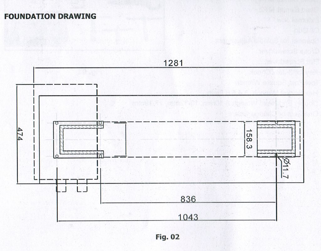

      Hello, I am thinking of buying a Warco WM280VF and wonder if any of you know the foot hole dimetions. Width of foot bolt holes and length, left foot to right foot. This seems a lot of lathe for the money. I have a 2-speed Myford Tri-Leva at the moment but it is 60+ years old and very worn.

        Mounting Dimentions
        #138895
          This should give you what you need, click to enlarge.
          I'm quite happy with mine

            Thanks JasonB, thats just what i needed.
