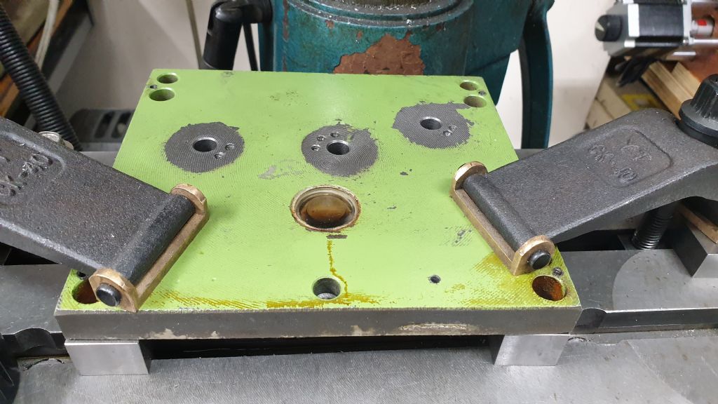

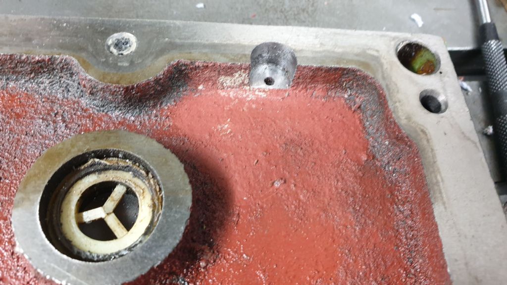

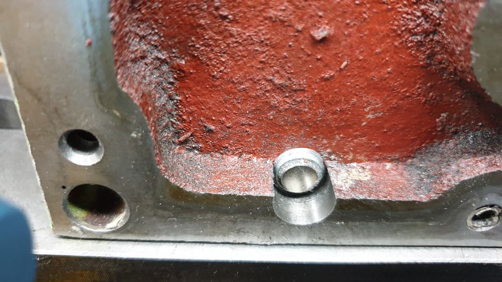

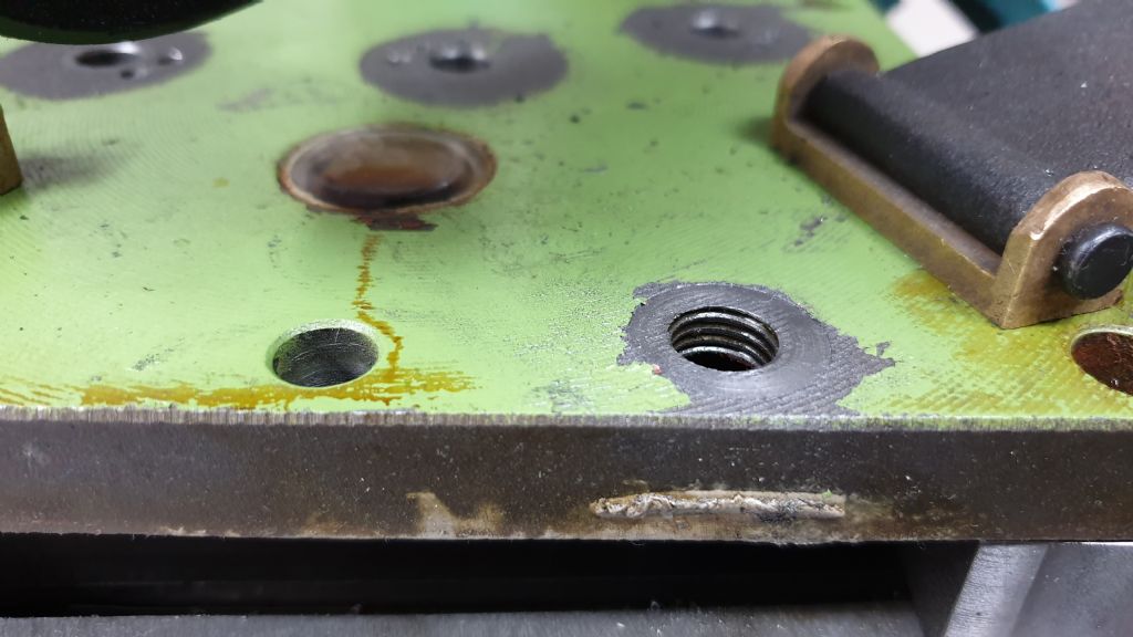

          Next Installment

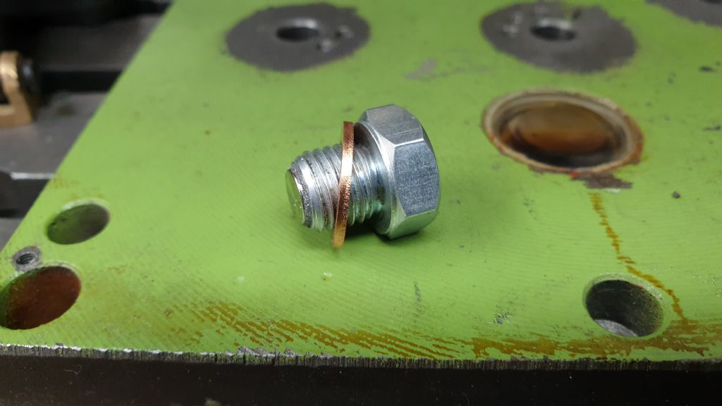

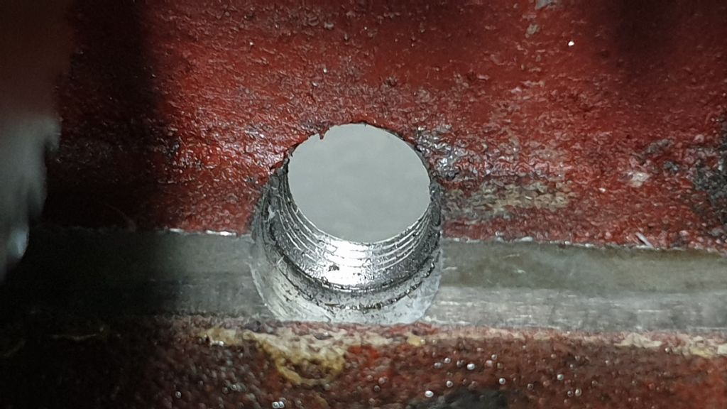

          Although I had read it elsewhere, I was surprised at just how ineffective the gearbox drain plug was. It is around 20mm ABOVE the level of the inner casting. This results in a large amount of residual oil cascading out when the front panel is removed. Someone had suggested adding a drain hole at a more appropriate position, so that formed part of my project. I decided to fit a magnetic drain plug and sourced one from eBay. It required an M12 x 1.5mm tapped hole. After some deliberation I drilled a pilot hole 19mm up from the bottom of the front cover in the mill. The panel was turned over and a 14mm mill, centred on the previously located pilot hole, used to produce a clearance for the M12 tap. The panel was again turned face up and a 10.5mm tapping hole drilled. The hole was then tapped perfectly square whilst still in the mill. The finish on the front panel although adequate for a panel face was not deemed good enough to guarantee a good tight fit when the magnetic drain plug crush washer was compressed, so a light skim with a 20mm end mill improved that area. I used a 20mm ‘Q’ cutter to produce the hole in the front aluminium cover plate, the centre of which had also been located using the pilot hole..
          The last photo shows the reworked gear to the left on its keyway and the now smooth triple gear assembly on its shaft & keyway

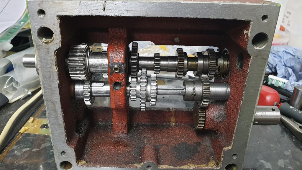

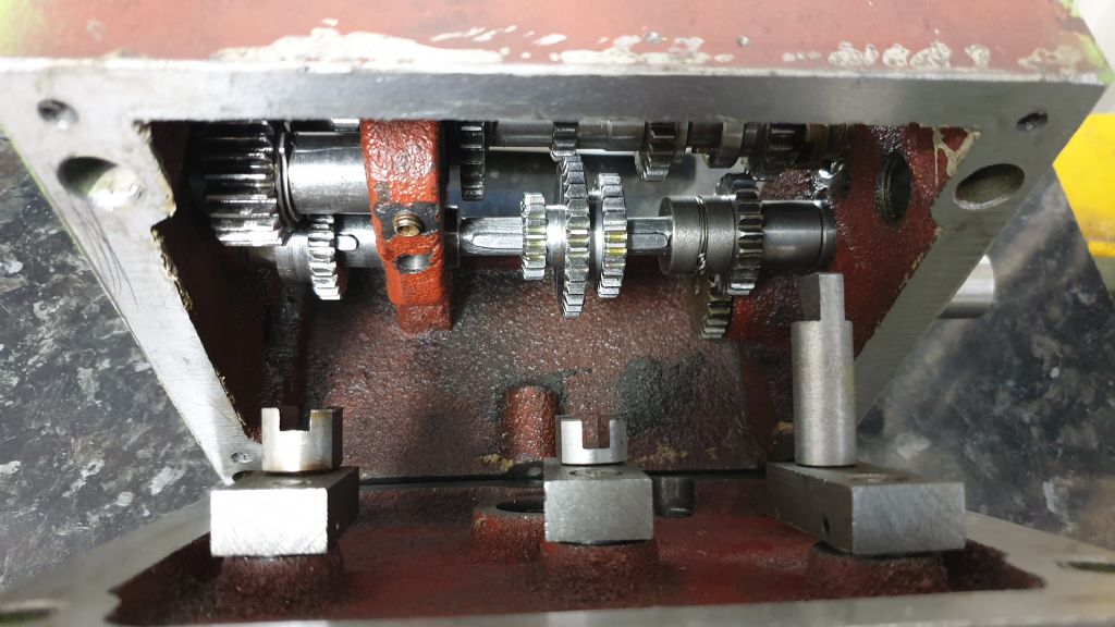

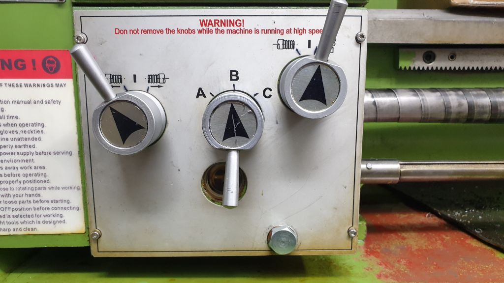

                  Next Installment

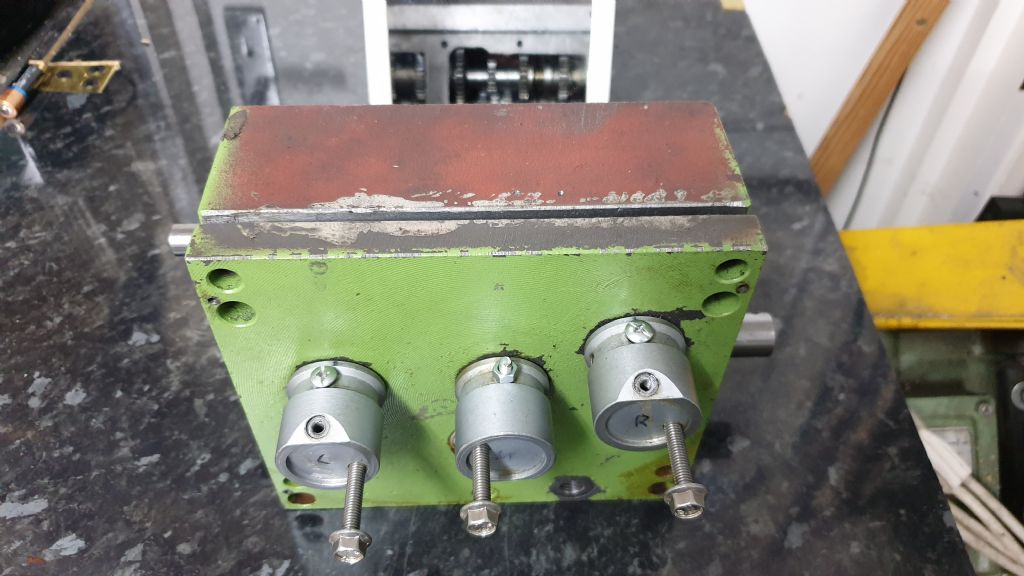

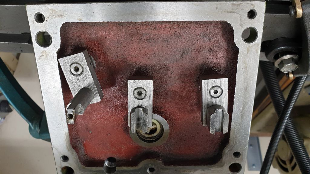

                  Refitting the front panel. I had removed the three knobs to give them a good clean. Each knob has TWO balls, a spring and a tensioning grub screw so care must be taken not to lose any part. These were removed before driving out the roll pins securing the knobs to their shafts.
                  I used some M4 nuts and bolts in place of the roll pins to position the gear selectors such that the selector arms would line up with the gear trains. The selectors were very loose, so to keep them vertical I inserted some 15mm lengths of bamboo skewer and slightly compressed them against the front panel with bolts screwed by hand into the tensioning grub screw holes. This method worked well.
                  The technique I found worked was once the arms were vertical it eventually becomes possible to get the actuating cams to engage whilst pivoting the front panel against the bottom of the gearbox housing. Full engagement could be confirmed by looking in a mirror positioned behind the gearbox (as in the last photo) then moving the selector knobs in both directions. Once comfortable with the positioning it was a matter of applying gasket compound to the previously cleaned surface of the gearbox, repositioning it in front of the mirror and repeating the pivoting motion and confirming again that the selectors worked correctly before refitting and tightening the 5 front panel retaining bolts.
                  Loaded by Steve for Barry

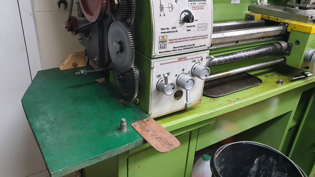

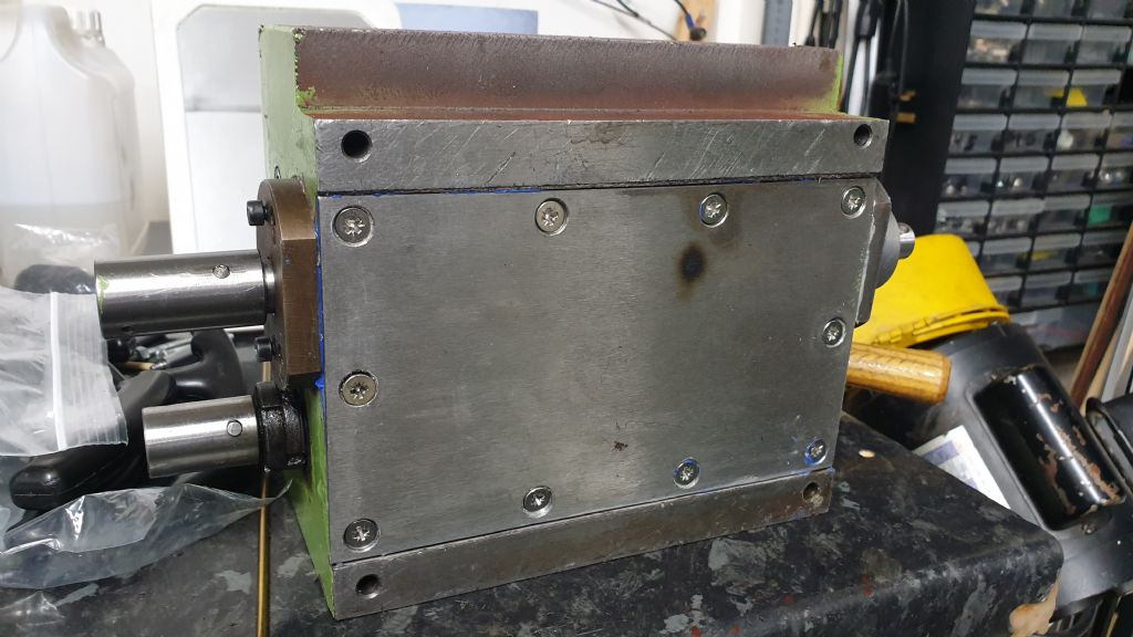

                    And the last part of Barry's journey back to a working lathe.
                    After final confirmation that the gear selectors were engaged and working properlye gasket sealing compound was applied and the rear cover panel refitted. Where the missing screw had been (original hole filled with sealer) I managed to extend the tapped portion of what was left in the casting and fitted longer screws which gave some purchase.
                    Gearbox and shaft taper shear pins refitted. Note table used for changing gear wheels. Corner removed to allow door to open, override block top right engages with safety cut out switch for testing, and banjo rests on the extended piece when pivoted forward. Final photo shows everything panelled up and ready for testing.
                    Posted by Steve for Barry

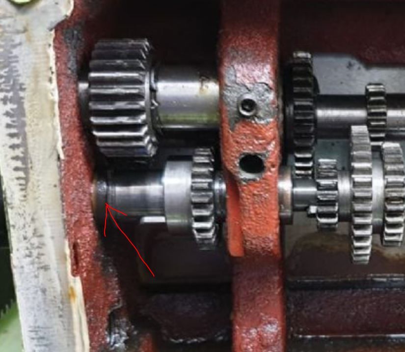

                      Is there a Circlip missing from the groove?
                      One of the interesting things with Barrys stripdown of the gearbox was the the O ring grooves, as the dimensions were decidly odd Barry sent me the dimensions and asked for my view on the circlips to use.
                      The dimensions were:-
                      Shaft :19mm Groove 18.5mm Width 1.3mm old circlip 1.0mm thick
                      Shaft: 18mm Groove: 17.0mm Width 1.3mm old circlip 1.0mm thick
                      Shaft: 15.74mm Groove: 15.36mm Width 1.22mm old circlip 0.94mm thick
                      The only one that is std that I could see is the 18/17 and that was after checking the imperial ones as well.
                      In the end I sugested the following sizes and comments.
                      Well all I can say is what a dogs dinner
                      D1400-019
                      D1400-018
                      D1400-016
                      I would get 10 packs as they are only a bit more than 2
                      If they don't look as if they will stay In place make a tapered mandrel out of steel
                      and lap the ID of circling with valve grinding paste.
                      Hopfully now that everything is sliding properly the circlips will stay in place.
                      Steve

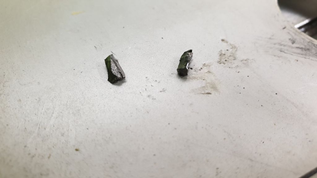

                          In response to earlier queries, all I discovered inside the gearbox were these two broken teeth.
                          Photo uploaded by Barry – at last! Many thanks to Steve for earlier uploads!!
