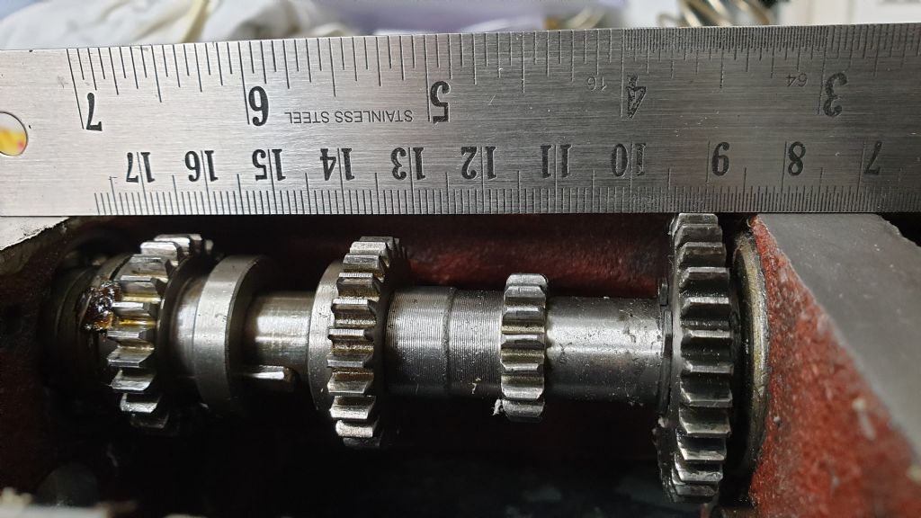

          Update – I really have to apologise because I am totally unable to select and upload images for some reason. Perhaps Steve will put up my latest images which show the rearside of the removed gearbox. I have tried to select images on 2 PCs and also this, my smartphone, so seems to be an account problem.
          I have been thinking about the various helpful comments that I have received so far and on reflection agree that I have been over enthusiastically changing direction before the machine has stopped. This would explain the damage to the mangled gears.
          The original ( and continuing) problem of a stiff ABC selector appears to be down to the triple gear assembly not being free to slide along the shaft. By the look of things could well be debris below the shaft key which is restricting travel. Should become clearer when disassembled.

            Posted by Barry Chamberlain 1 on 15/03/2020 23:02:17:
            More pictures from Barry via his IT attachment support engineer (Ongoing joke with Barry as he keeps losing email attachments due to an antiquated email program he loves winkyes)
            Barry is going to look and see if he can find circlip debris later today.

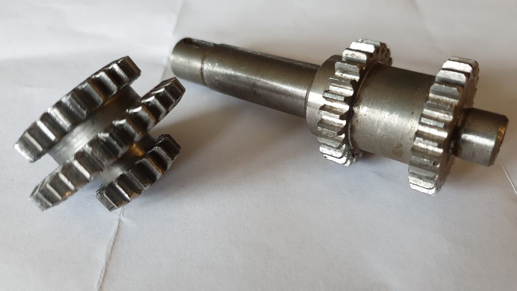

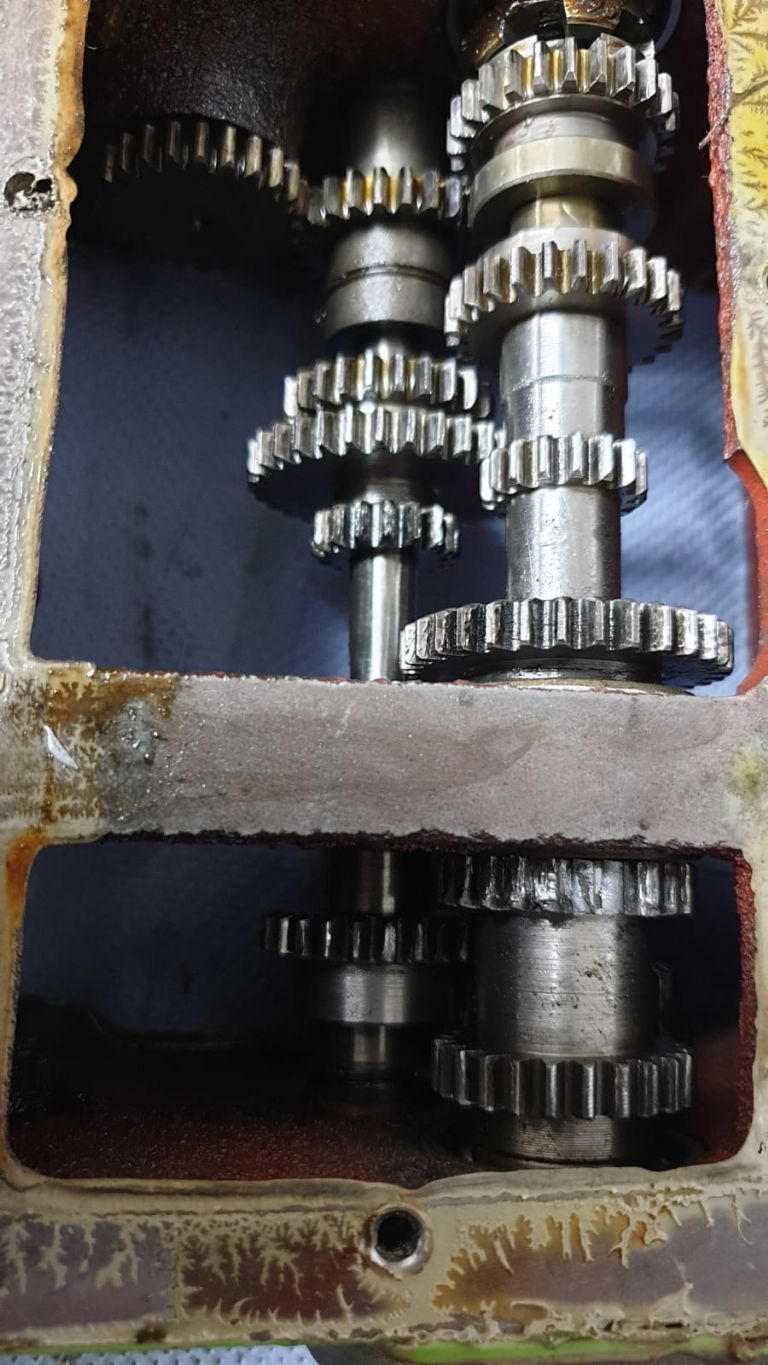

              I missed adding this photo
              See damage to gears at bottom of photo.
              Steve for Barry

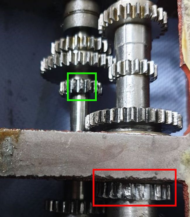

                #457541
                  For the purpose of elimination, would Barry explain how he changes gear please, both now and in the past? The symptoms could be explained by either forcing the box under power, or by a mechanical problem, or by a failed tooth due to earlier damage such as absently mindedly changing gear at high-speed.
                  Also, is it just the obvious missing tooth and other mangling in the red box, or is there a problem with the gear in green as well?
                  Lots of possibilities still:
                  • Operator error
                  • Faulty gear causing tooth to detach and get caught at speed
                  • Whatever caused stiff selecting broke and fell into the works.
                  Unless the gear was cracked during manufacture, it would take a fair amount of force to break a tooth and do the other damage. Only the lathe motor at speed plus centrifugal energy stored in the chuck would be powerful enough to do that much damage I guess? I don't think it would be possible for the operator to break teeth by turning the gear selector knob on his own. But maybe a damaged gear when the lathe was built has gradually worsened over time.
                  Would missing or damaged circlips or a faulty selector explain the damage? Maybe if the gear pair was run with only their very edges engaged, but wouldn't that damage both gears?

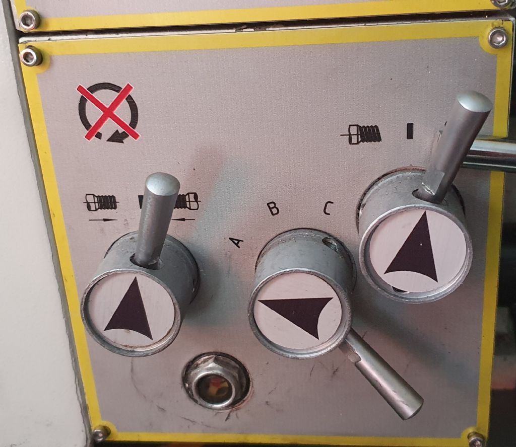

                        On my Wm280, I can move all three knobs on the go at minimum speed – without any strange noises, in fact it's easier with the lathe turning than stationary. The warning on top of the knobs say not to change gears with the lathe in high speed, so the cause of the damage could have been that, but it sure is fine to change at 150rpm,

                          With sliding mesh spur gears, changing whilst in motion is inadvisable.
                          In a vehicle, you can double declutch and use you fine control of engine speed to ensure that gears mesh at bthe correct speeds. Try changing gear, on the move, with an old tractor, truck, or bus and you will soon find the difference in technique!
                          With a machine tool, the prime mover is fixed speed, so you do not have the facility (or luxury)
                          Other than machines like the Herbert Preoptives, gears are changed with the machine stationary, with the motor stopped, or the clutch disengaged.
                          Unless you enjoy stripping and rebuilding gearboxes?

                                      My son's Chester has a similar (identical) gearbox and the warning at the top left is enough to stop me trying to change gears when moving, especially as it is his machine and may have to last another 60 years. No problems changing gear when stationary as long as I turn the output coupling whilst moving the lever.
                                      Brian G

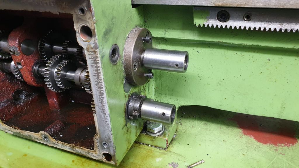

                                        Having removed the gearbox cover it is clear that the triple gear does not slide freely over the shaft key and jams when moving to the left. I suspect debris in the keyway.
                                        I have not commented for a while as I am waiting for spares prior to stripping the gear box down. I still have no idea why I am unable to post jpg images, but will continue to add pictures via Steve.

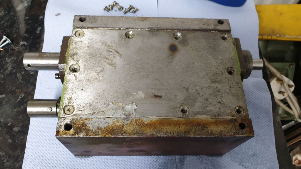

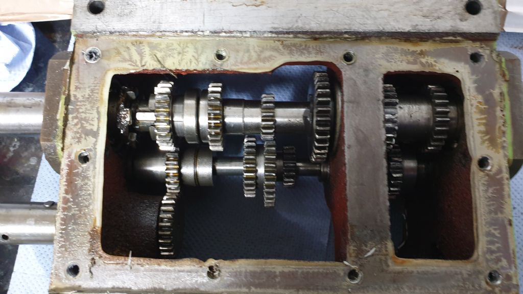

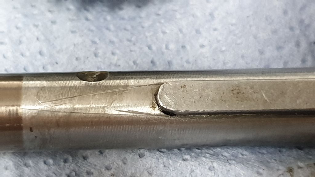

                                            Hi

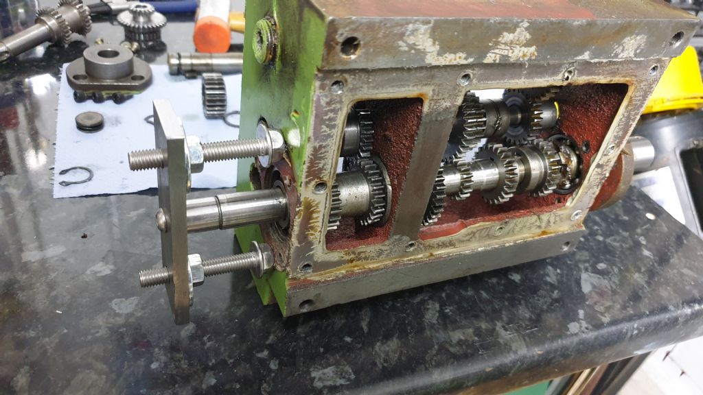

                                            Barry has been busy stripping his gearbox down and repairing and this is the first in a series of posts showing the cause and the repair.

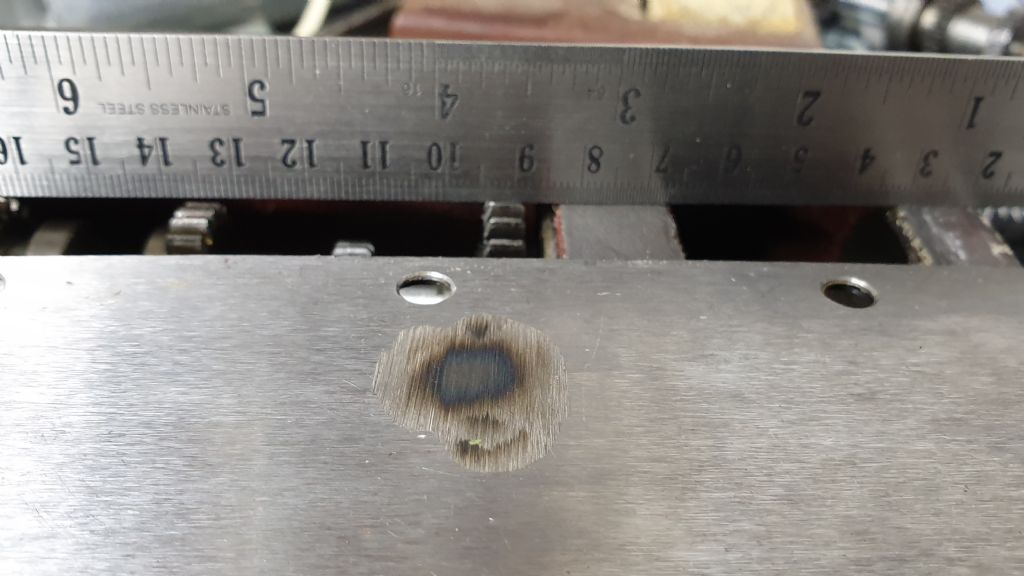

                                            At last I’m able to finish this Gearbox strip and rebuild report. Although I had two gears from Warco (the double and triple gear assemblies) the third gear was on a 12 week back order from China. THEN lockdown arrived and things slowed considerably, so I decided to get as much done as possible prior to the third gear arriving. First surprise, on removing the Gearbox from the lathe body, was when I was removing the rear cover to gain access. After removing 7 of what should have been 10 screws I realise that there was NO screw fitted at the second location in from the left on the bottom row, and the hole had been filled with sealer! When the sealant was removed it was apparent that the hole had been drilled way off centre leaving little thread in the casting.
                                            Inboard of the top row of holes there was a burn mark clearly visible on the rear cover plate. When released it was obvious that the inner face of the cover plate had been ground down – to give clearance between the cover plate and one of the gears! See photos showing the teeth of the larger gear clearly above the ground rear face of the casting…………!
                                            I am still unable to post photos onto this Forum for some odd reason, so Steve has again kindly stepped in to post on my behalf.
                                            Posed by Steve Larner for Barry

                                            Dave Halford
                                              @davehalford22513
                                              Looking at the first photo it appears that the recess for the plate is slanted. Hopefully the shafts are parallel to the mounting surface and the two shafts are parallel to each other.
                                              I'll leave the rest unsaid.
                                              Apologies Barry, I assumed the worst on your gear shifting.
                                              Edited By Dave Halford on 01/07/2020 10:40:01

                                                Hi Dave. Thanks for your comments, I hadn't noticed the slant but looking at the photographs again you may well be right. Would explain the requirement to provide clearance for the gears by grinding the cover panel. I didn't check for parallelism of the shafts. The gear trains were easy to rotate by hand in all positions on re-assembly so no cause for concern.

                                                  Hi Barry,
                                                  The issue I was thinking about is if the two shaft bores are diverging you may get enough clearance to hammer the righthand gears. I think you ought to talk to Warco and share those photos with them.

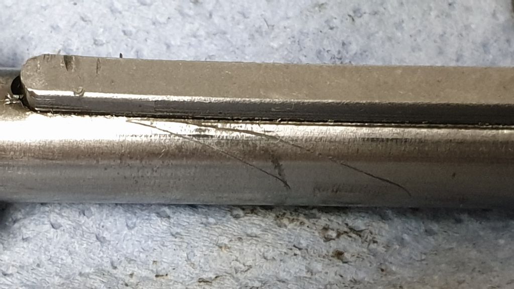

                                                    Hi

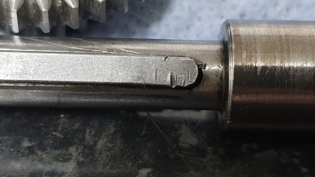

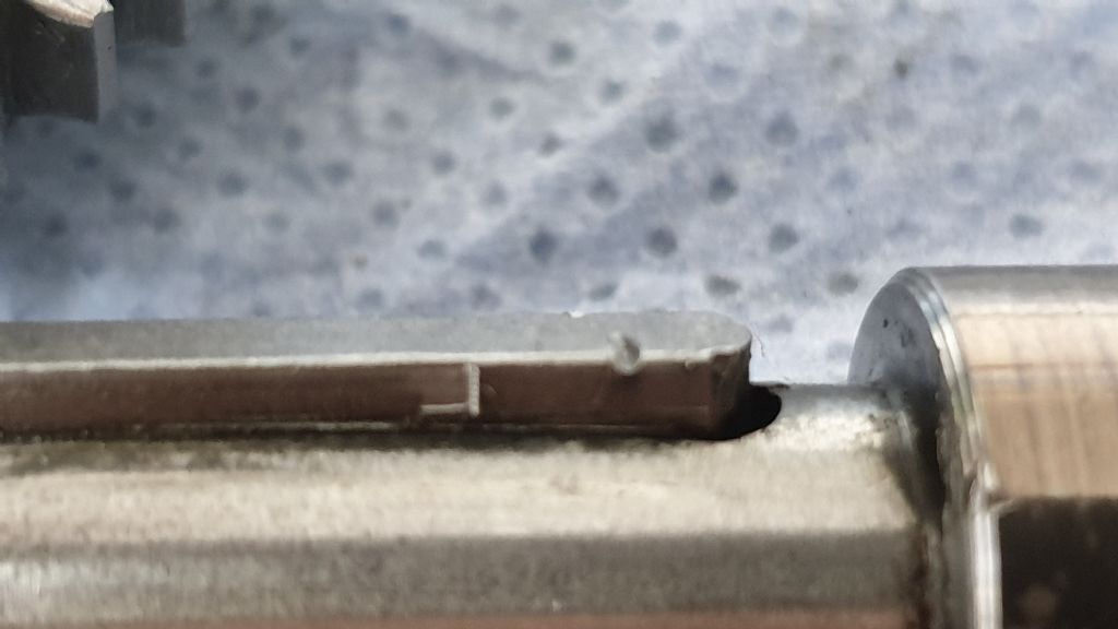

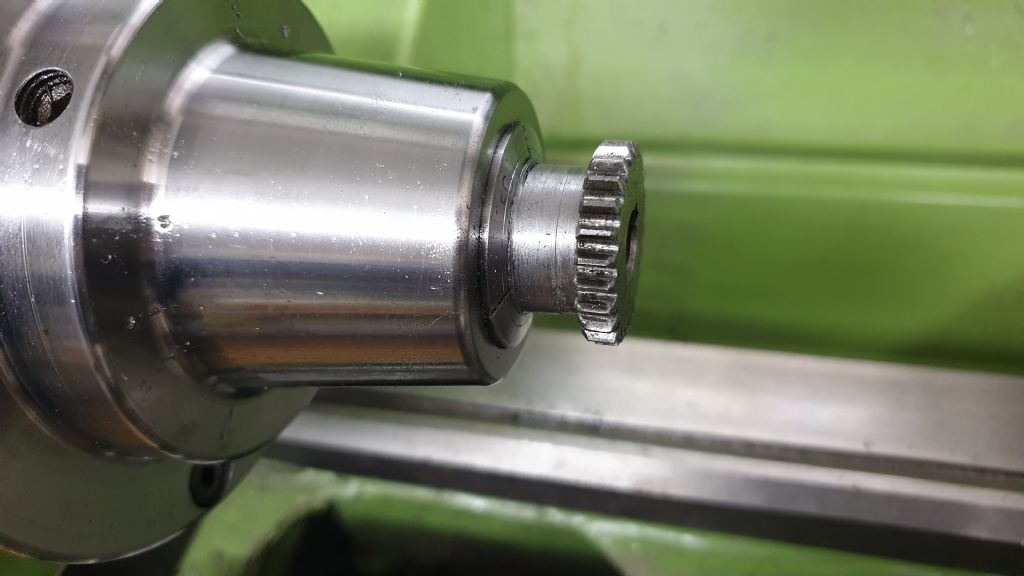

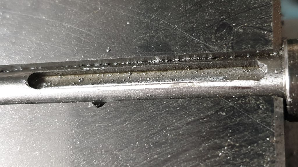

                                                    Next set of Photos and text from Barry
                                                    In order to disassemble the gear trains I manufactured a simple gear puller as shown for the roller bearings. It may be recalled that when I complained about the stiffness in the gearbox Warco (who had the lathe back for rectification under Warranty) attributed it to ‘swarf’ under the gear selector knob. As can be clearly seen that was NOT the case at all. Someone at the factory in China had obviously struggled to get the triple gear assembly to smoothly slide along the gear shaft and had resorted to agricultural means of persuasion in attempts at achieving free movement!
                                                    I was not impressed with this at all and will let the photographs tell the tale. It was obvious that the key had to be replaced. The original key was wedged in place so I had to mill it out. As can be seen in one photograph there were several nicks along the edge of the keyway itself which I dressed prior to fitting the new key. I purchased a 4mm square length of keyway bar from Simply Bearings, cut to length and ground the ends to suit. Fitting this was not straightforward and I sensed that the key slot itself was slightly offset and found the new triple gear assembly was binding along the shaft. I resolved this by lightly scraping the shaft either side of the key with the square end of a small flat file. Eventually this resulted in a smooth sliding action along the keyway.
                                                    Posted for Barry by Steve.

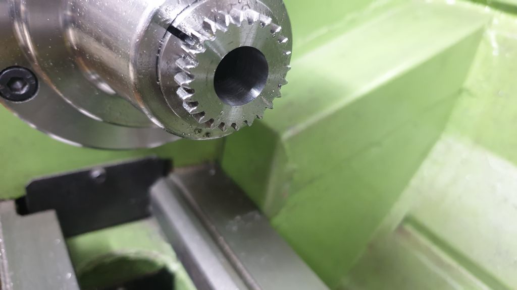

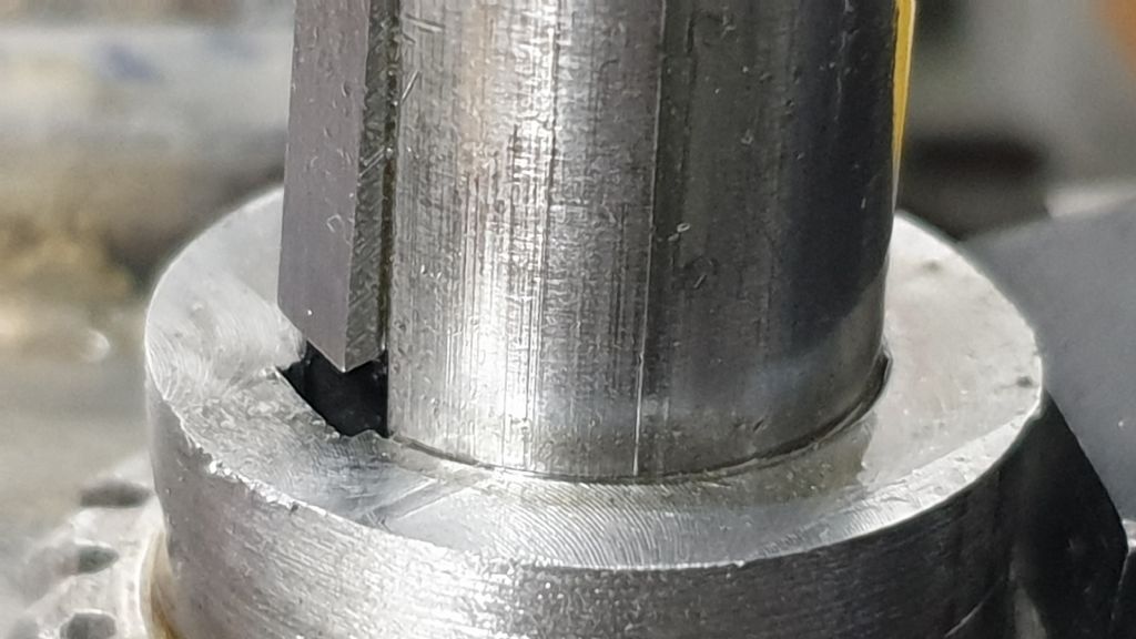

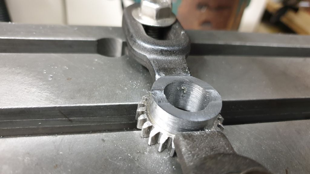

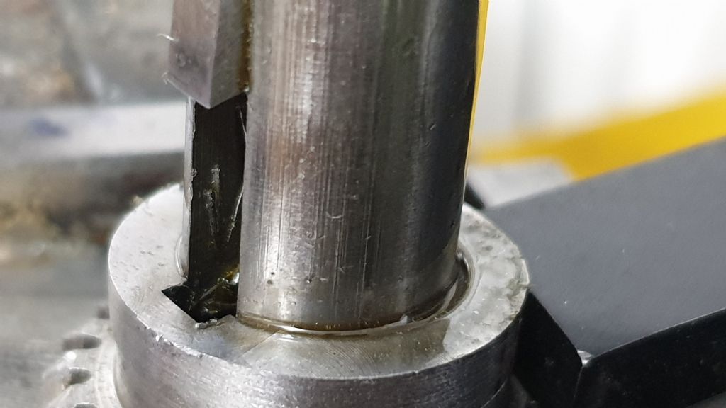

                                                      Making the missing gear
                                                      Whilst waiting for the outstanding gear to arrive it dawned on me that there was a perfectly serviceable gear on the old triple gear assembly with the correct number of teeth. It would require removal of two of the three gears from the shaft, boring and reaming the hole to 16mm diameter then milling to the correct overall width. The lathe was perfectly useable without the gear box, but I did miss the power fed when boring the hole out. These stages are shown in the photographs. Although it looks otherwise, the shot where the gear is being milled is actually ‘finger nail’ smooth and not scored across the diameter.
                                                      There only remained the lack of a keyway …. At last, an opportunity to use a broaching tool inherited from a former club member’s workshop for the first time. After a bit of research I found Michael Cox’s article on making a simple internal keyway broach (MEW Issue 184, page 47) and set about modifying a length of 16mm silver steel. The broaching tool travel was pretty limited so the tool had to be customised. I milled a 4mm slot into which I set a length of 4mm square HSS tool steel. I didn’t grind the end, but used it as purchased. An M3 grub screw approximately 20mm from the end of the tool steel is used to progressively advance the cutter into the work in minute increments. After a considerable amount of time, copious amounts of cutting fluid and two blisters, the task was completed. It was slow, hard work but well worth the effort in the end.
                                                      Posted by steve for Barry
