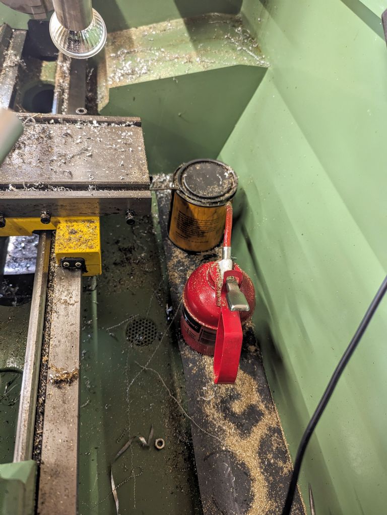

      My previous 1940's Sheldon had a removeable steel tray between the two sets of feet and the tray caught 99% of the swarf and chippings, so cleaning was easy.
      The Warco sits in a tray and is bolted down through it. If I was only cutting mild steel then I'd use a magnet, but stainless steel and brass in particular are a right pain to clean up. So my questions are:

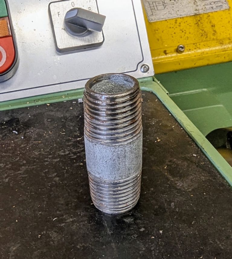

      1) The tray does have a drain at the back with a course gauze as part of it. Underneath there is a flange with an internal threat. Does any one know what thread this is please?
      2) If I can attach a hose to the thread in 1), what fluid should I use to wash down the lathe and tray?
      3) Any other tips for cleaning up sharp swarf without wrecking the paintwork?

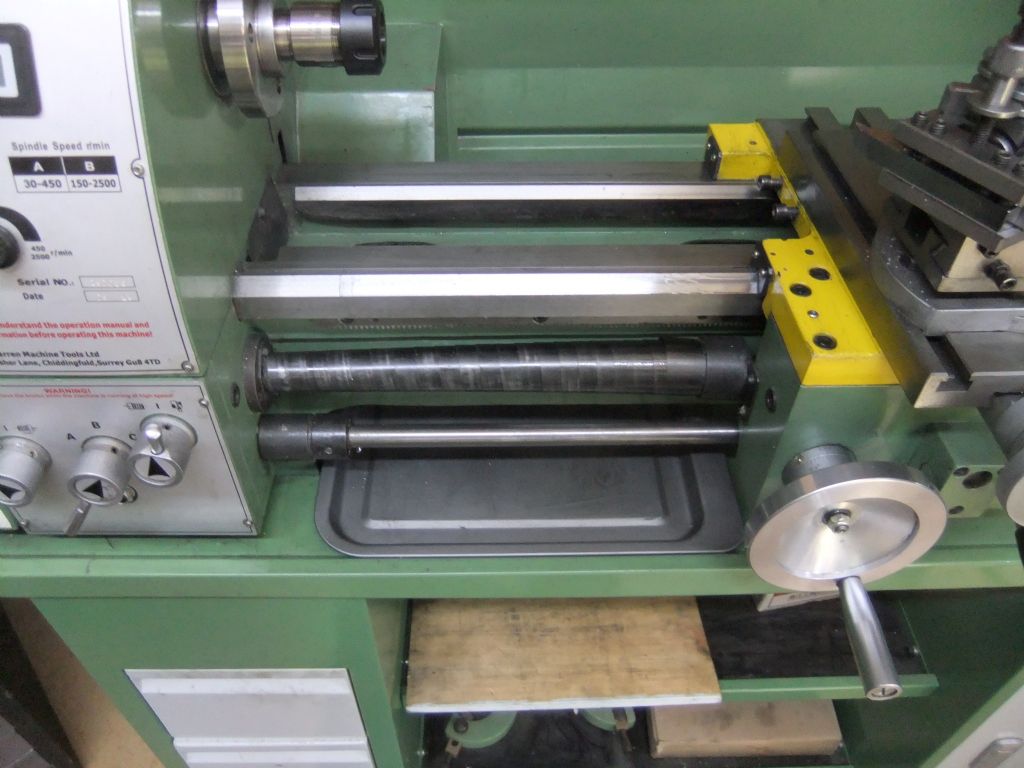

        #657331
          I've a couple of old flat baking trays that I slip under the bed of the 280 and slide them out to empty fine swarf once in a while.
          Washing down is a bit too far for me anything that misses the trays I just use an offcut of 6mm MDF to rake out the worse but don't go as far as trying to keep it spotless.
          #657332
          Dalboy
            @dalboy
            Like Jason I use a shallow tray but only one as I find that is where most of the swarf ends up. I can just slide it along for jobs which are longer. Any loose small swarf that misses the tray I just vac up.

              I can screw an M20 x 1.5 thread several turns into the tray drain on my WM250V. If it was anything different I don't think I could do that.

                  Thanks for the thread size. Do you use the drain?
                  I also have a tray at the headstock end of the bed, but brass goes everywhere!

                    The thread in my WM280 drain appears to be M20x1.75, which is odd for a hose fitting. Might be 1/2" BSPP and 14tpi, which is close to that size.
                        If it is clearly a drain point, meant for coolant, the most likely thread is that used in conjunction with pipework, i.e. BSP.
                        M20 x 1.5 is a standard thread on electrical conduit, which generally is not used to carry liquids. That thread would be found on an electric motor, for a cable gland in the same way that a BSP thread would not be found on a motor.
                        M20 x 1.75 is extremely unlikly as 1.75mm pitch is not used anywhere in metric threads other than standard M12 coarse.

                          I don't disagree, and I know of the conduit application, but I can screw the M20 x 1,5 thread in 6 turns before it sticks, and the drain's position and its welded-on strainer make it practically impossible to tell whether the thread runs out or gets jammed with paint or crud at that point.
                          The only standard BSP thread that's *anywhere near* the same OD is 1/2", nearly 38 thou bigger and 14 TPI or ~1,8143 mm pitch. Can't see an M20 x 1,5 male thread fitting that even for 1 turn.
                          I've seen some evidence of variation in some parts used in lathes believed to be from the same factory. I don't know whether these are properly-documented Engineering Changes in these factories, or casual pragmatism to use up whatever they happen to have at the time.

                              I thought M20 x 1.75 was extremely unlikely too, except the thread is a perfect match to 1.75 on my thread gauge and the male is very close to 20mm.
                              And, although M20 x 1.75 isn't listed as a fastener thread, it must be used for something because taps and dies can be bought for it.
                              I always assume all metric threads must follow the fastener standard, but it's not true. As the thread I measured is for a pipe fitting, not a fastener, possibly it's right. Maybe M20 x 1.75 and M20 x 1.5 are legal in some 'not a fastener' standard we've never heard of.
                              It is odd though! I'd expect a drain-plug to have one of the usual threads, yet mine seems to be a weirdo.

                                  Bizzarely ISO metric pipe threads are actually BSP sizes and are specified as such. So the thread in question is probably 1/2 inch BSP exactly (0.825 inch dia.[20.95 mm dia ] x 14 tpi [1.814 mm] pitch).

                                        I bought this 1/2" BSP coupler from my local hardware store today…..it fits perfectly.
                                        Thanks for all your help.
