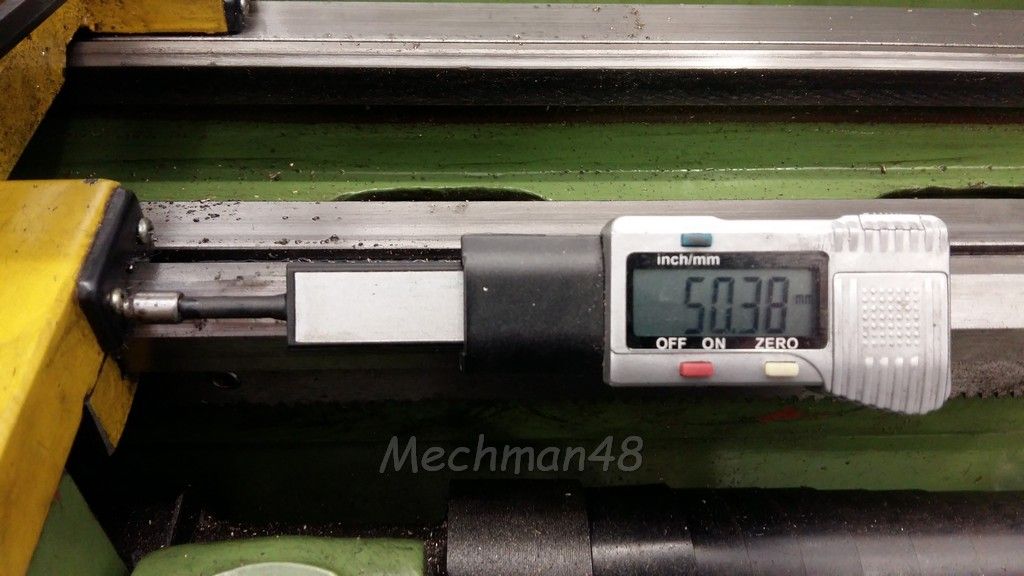

      Hi George,
      How are these gauges attached to the machine and where can they be bought?
      Many thanks,
      Ian
      #357149
      Ian Skeldon 2
        @ianskeldon2
        Can't edit my previous post but I have re-read that you use magnets glued to the scale, so if you can offer advice on where to buy these type of scales.
        Thanks,
        Ian
        #357206
        Ross Lloyd 1
          @rosslloyd1
          Posted by mechman48 on 10/06/2018 18:00:32:
          Ross
          Whilst I was in the man cave today I did a check on the tyre gauge digi read out travel on the saddle travel position, can get 50mm safely before scale comes out of read head… sufficient travel for finishing off with just a 'tad more', & when you're done just unclip it & store it back on the tail stock, or wherever…
          ​George.
          Thats really quite ingenious. I dont fancy a full DRO setup on the lathe at this time, but those might just be a nice compromise.
          #357229
          mechman48
            @mechman48
            Bought off eBay… cut the lugs off, super glue / epoxy 4-6 neodymium magnets onto back… voila! … usual disclaimer applies.
            **LINK**
            **LINK**
            George.
            Edited By mechman48 on 11/06/2018 09:29:41

                Posted by mechman48 on 11/06/2018 09:27:32:
                **LINK**
                **LINK**
                George.
                Thank you George, very helpful links and very cheap gauges. Will give it a go.
                Thanks, Ian
