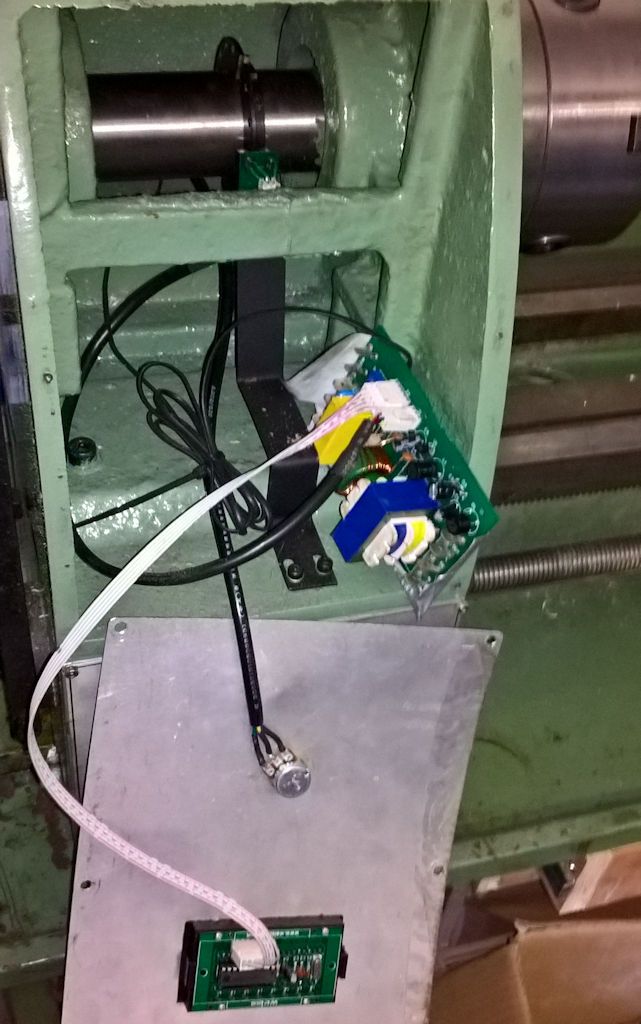

      Here you go Jason, this is what the drive looks like on the WM250V.
      It is currently set up in the high speed range, for low speed, the belt to the spindle is removed and a second belt i added from the idler/reduction pulley on the left to the spindle.
      Drive
      Edited By Graeme W on 09/02/2017 20:23:59

            Just seen your posting Graeme, that looks nothing like mine.

              Dusty, The photo does show how Warco are now able to get a low speed of 30 and still keep the torque reasonable as the the twin pully setup allows the motor to still spin at a reasonable speed even though the spindle speeds are now lower.
              The disadvantage is that when in low range you have less of a spread of speeds, maybe Graeme can confirm but I think low is something like 30 -500 and high 150- 2500 so you would probably end up having to change the belt more often whereas our old machines can do most things when left in te low range of 50-950.

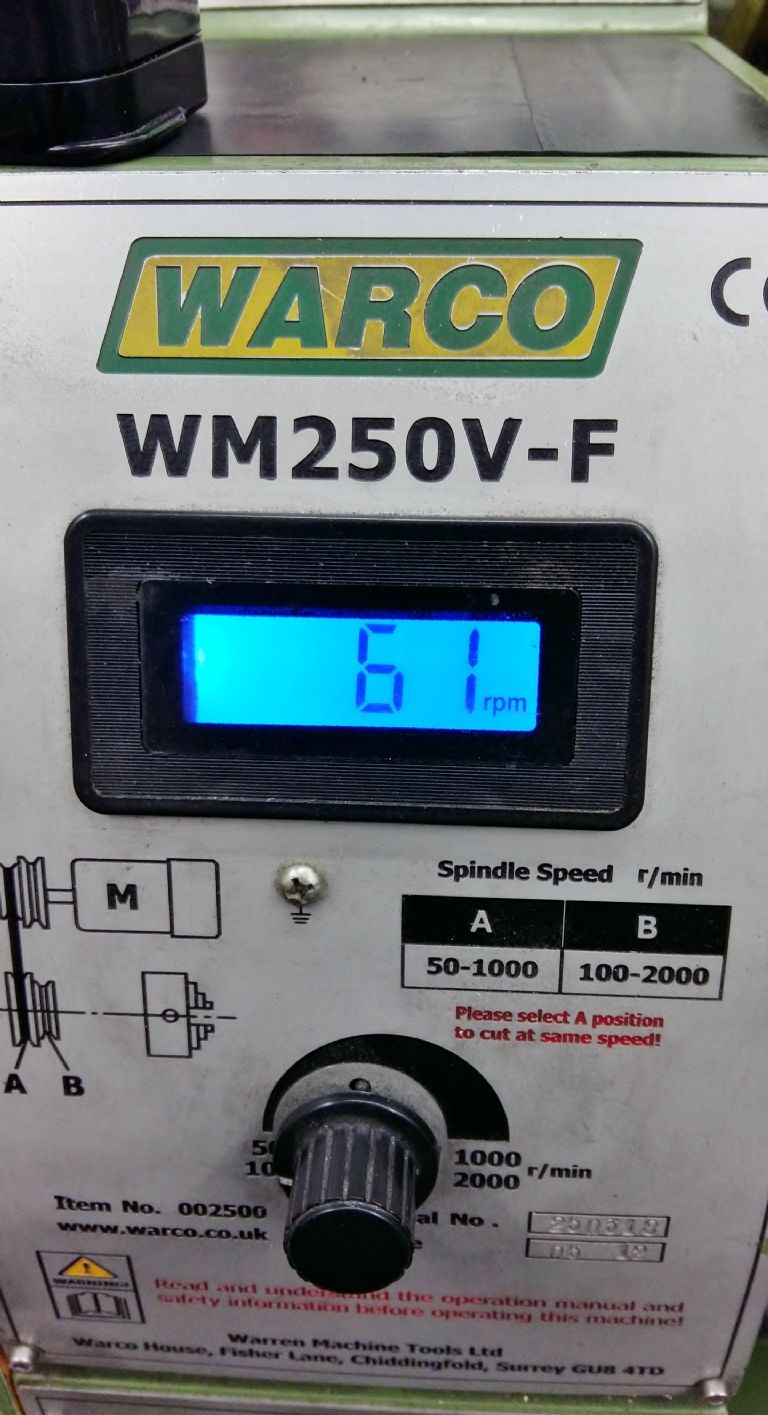

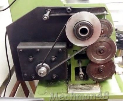

                        Ahhh that explains it; I think I'll stick with what I've got at the mo' … so far it's given me good running, fingers & toes X'd, touch wood & all that…
                        My lowest speed…
                        George.

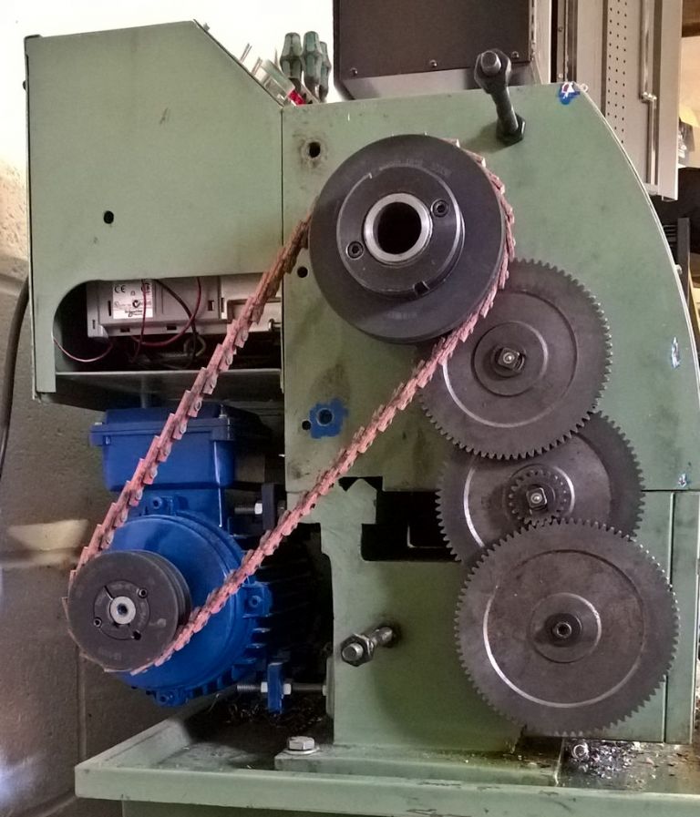

                          Out of interest for those who may be faced with having to convert at some time I snipped these photos off the "bluemachining" yahoo group which show a 280 with Weiss factory fitted 3-phase and VFD as they are not much different to teh 250s
                          Still used single belt to spindle with two pully options but spindle pully is smaller, notof fitted to back of bed via standoffs and teh tensioner wheel is needed as the motor can't be moved on its mount.
                          Clicky for a bigger picky.

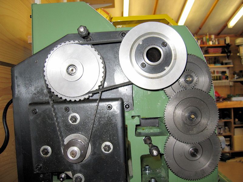

                            George, bit of variation over the years. This is my 2007 vintage WM250.

                              That sounds like the "toothed belt" Dusty is talking about having.

                                  Hello. My machine is a few years old now.It looks the same as Mechman48 shows.
                                  My original motor didn't last too long but to be fair I abused it cutting large diameter steel.
                                  There are some photos in my album listed as '3 phase'
                                  Really could do with a proper Gates belt to fit the spindle pulley.
                                  Hope it helps.

                                    Jason, yes pretty sure it's the same. Mod to fit new motor "could" be fairly straightforward. The 1/4" black plate basically supports everything. Remove that and the motor, intermediate pulley and control box all go with it. Just the small matter of reattaching the new onewink

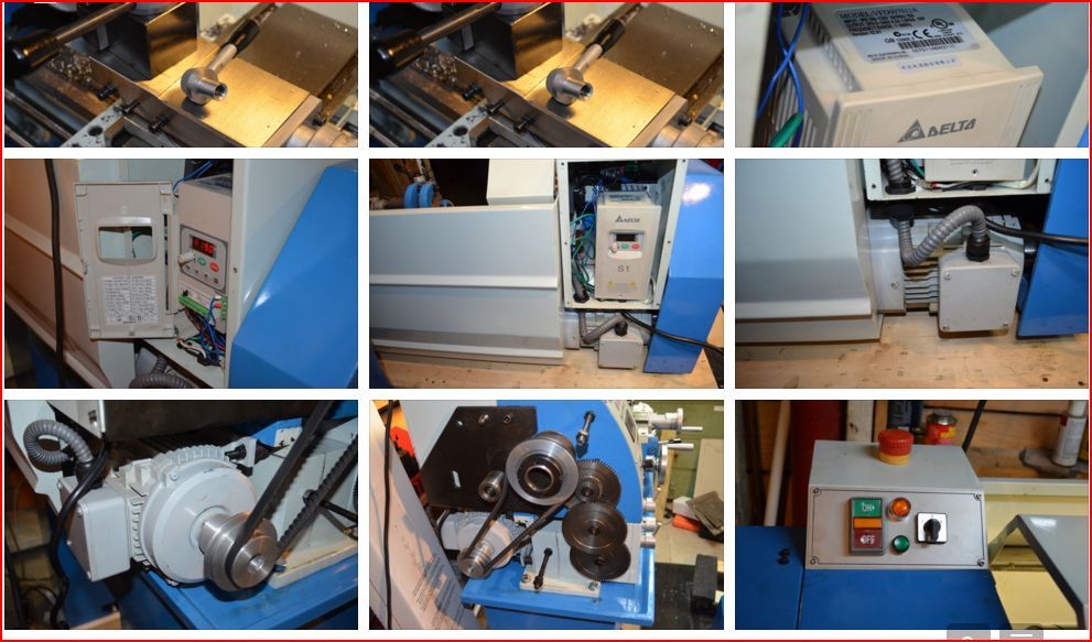

                                                    Posted by Dusty on 13/02/2017 19:53:52:
                                                    Whilst waiting for my new motor to arrive I have been stripping some of the parts from my lathe ready for modification. I spoke earlier about the tacho, you were right John it all seems to run from the filter, if my understanding is right I only need to connect that to power and its all systems go. If I use the existing NVR in the power lead can I connect the filter power to the out side as well as the VFD or is there a problem with that?
                                                    I can relay my experience with a warco 280 if that would help. I was unable to juice the tacho board on the back of the display unit so that it would run of its own accord. I was unhappy about running mains voltage wires into the front of the headstock just for the sake of the tacho, so I butchered a phone charger and wired it into the fused supply in the control box, then ran the 5V cable through and patched it in to the power supply board after some testing to work out how far back up the circuit I needed to put it to get it all working.
                                                    You can of course use the VFD display to show speed, but I preferred the VFD to be properly enclosed in the control box, and the tacho to come from measuring the actual spindle speed, in case I alter the pulleys.
                                                    As for the motor fitment, the 280 has threaded holes in the bed, revealed when the rear control box is removed, the 250 may well be the same?
                                                    So I cut off the lower half of the control box, and mounted the VFD in the upper half.
                                                    The threaded holes were at the spacing for an 80 frame motor, I chose the higher power option at 1.1Kw, and just mounted it on threaded bar and nuts, which allows for tensioning the belt (if a little rudimentary).
                                                    I then used nutlink belt and a pair of taperlock pulleys to finish the job, obviously they go straight on the motor, but happily the 280 spindle is a simple M40 thread so the old pulley was spun off and easily replaced with a taperlock one.
                                                    The whole thing was so easy that I was able to get the lathe going without needing a working lathe to make parts, obviously I could refine the setup a little now, but it works well enough as it is.
