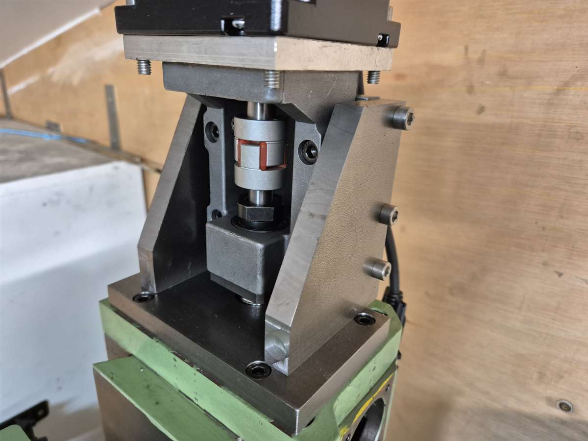

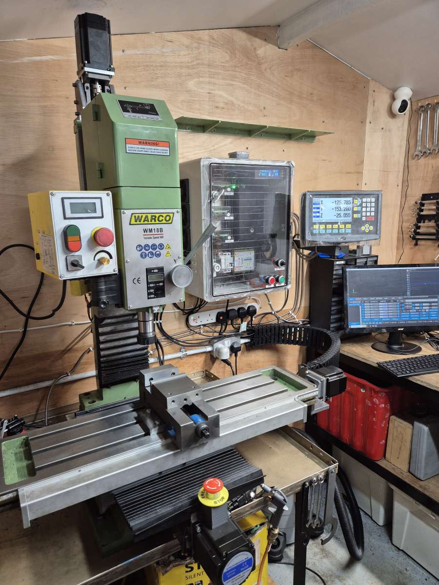

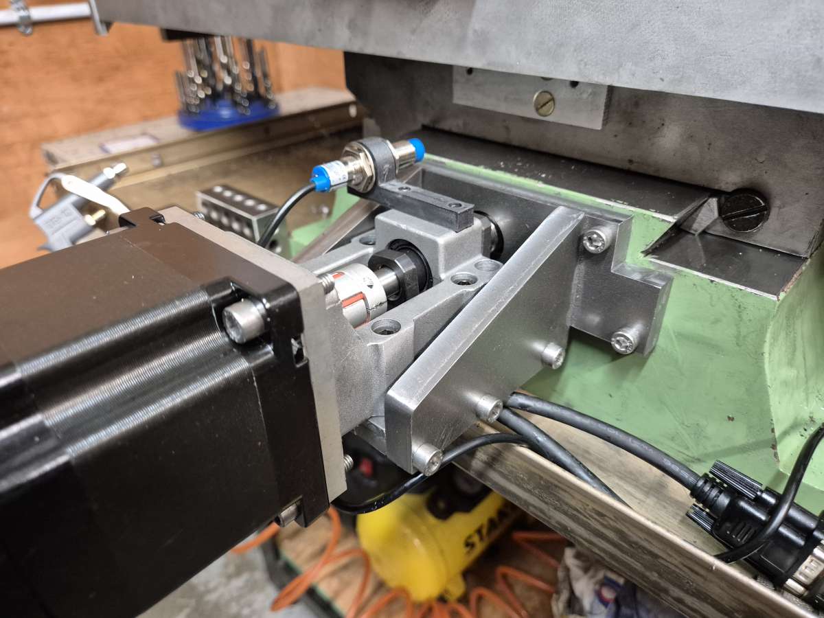

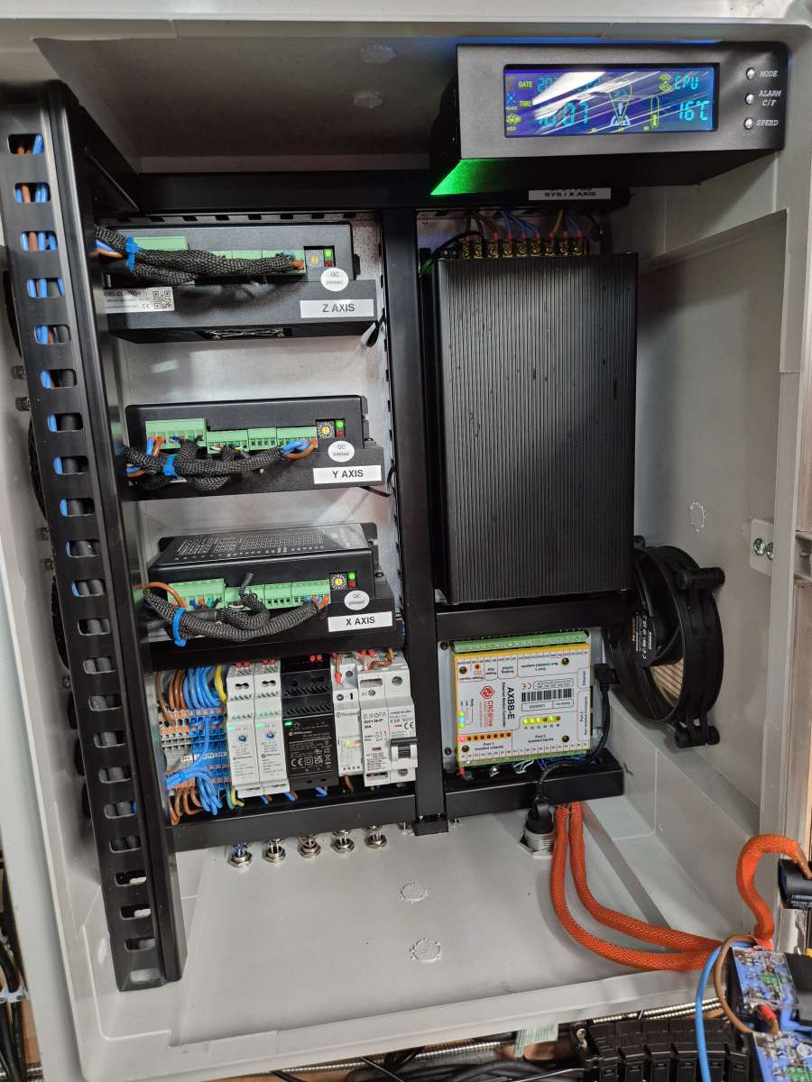

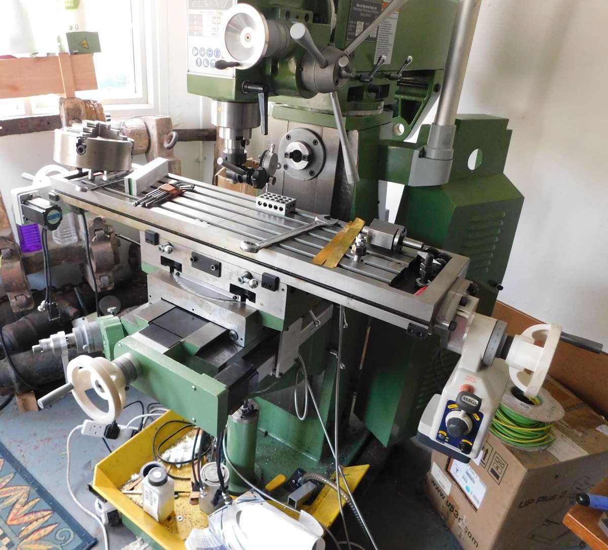

      I would like to share few photos of my Warco WM18B cnc conversion.
      Screws on all axis has been replaced with a 20mm double nut ballscrews.
      4.5Nm 34nema steppers has been used on X and Y and 9Nm on Z axis.
      As a controller I chose AXBB-E and UCCNC as a software.
      There’s still a lot to learn in terms of speeds and feeds as well as generating a tool paths, but I’m happy with a results so far, and machine proved to be very accurate.
      There’s a lot more photos and couple of videos taken during conversion if anyone is interested. Youtube link: https://youtu.be/L9Qk7GP5DVo?si=kFiIhgAOKMzStSVb
      Tom

            Clive Foster
              @clivefoster55965
              I like the nice solid built up motor brackets.
              How did you ensure that the casting surfaces the brackets fixed to were sufficiently true to the screw axes to avoid binding and poor running?
              Were they good enough as supplied or did you have to operate on them?
              Clive
              #786693
              Tomek
                @tomek
                Thank you all for those positive comments!
                Clive, castings were pretty much fine out the box when I checked with a square and didn’t require any work on them.
                No binding has been noticed on tests so I assume it’s all good.
                Tom

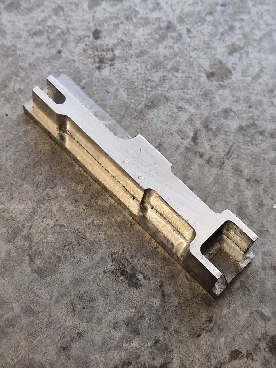

                  I just finished my first CNC made part for a Duchess!
                  It’s a valve rocker.
                  Mild steel has been baked in the wood burner prior to machining to relieve any stresses in material.
                  Well happy with that!

                    I am so envious, I CNC’d my Warco Major, probably 3 times, while I figured out how to do it proper.
                    Much too late to make it look nice now.
                    Having that Z axis on a dovetail, where I have a round column, should allow you to have the stepper motor and keep the winding handle, but you have chosen not to.
                    You have chosen to put a DRO on the Z and a stepper. This will give a second opinion on the position?
                    Don’t lose the handles x) x)
                    best
                    Robin
                    #787012
                    Tomek
                      @tomek
                      Hi Robin.
                      Dro was fitted couple years ago, right after I bought a mill. I’ve decided to keep it as it’s not in the way, helped with calibration, and always good to have as a reference.
                      It wouldn’t be possible to keep Z handle on as screws has been replaced with a ballscrews and bevel gears were removed.

                              Julie Ann
                                @julieann
                                That’s a very neat and professional looking conversion. I am suitably impressed!

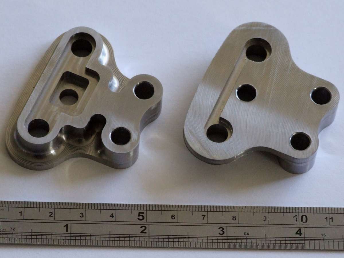

                                Bit of a shame about the finish on the parts though. This is the sort of finish I would expect to get straight off my hobby CNC mill:
                                Spectacle_Plate_Bushes
                                I expect the poor finish is down to some/all of the cutters, toolpath and feed/speed values. I prefer to use quality cutters; either the carbide K2 series from Cutwel, or the premium carbide range from Arc.
                                I do not have handles on my CNC mill, no need for them. Also if they are not there then there is no danger of being caught in a painful place by a handle rotating unexpectedly.
                                Julie
                                #787106
                                  It looks a neat and tidy conversion
                                  As Julie says the finish could be improved and there may be several causes, from the video I would say:
                                  From the first attempt at the part it looks like you are taking small cuts with a stepdown of maybe 1mm and a similar step over. This tends to blunt the coner of the cutter and could be the cause of the burrs which usually are the result of a cutter that has lost it’s edge. I would suggest going the full depth less 0.3mm and a stepover of 10% cutter diameter to rough it out to within 0.3mm of final profile. Then a finish pass or two at full depth.
                                  The second attempt that was on size the feed seems very slow which can also blunt the cutter prematurely. The small crumbly chips are an indication of it not cutting at its best.
                                  Now you have ball screws I’d suggest climb cutting. I use it for almost everything but maybe try it for the finish passes first and see how you get on.
                                  Again as Julie says Good or reasonable quality carbide, I use a mix of New Century from Cutwel, APT’s own or ARCs premium and keep them small so motor is running in its sweet spot at speed. Most of what I do is with 6mm 3-flutes or 4mm for smaller items.
                                  Are you writing G-code or using CAM?
                                  No handles on my CNC either, if I want to do something simple then the jogs are really just like a power feed on each axis. I’ve other manual machines with handles that satisfy my need for knob twiddling.
                                  #787118
                                  Tomek
                                    @tomek
                                    I’m not planning on going back to handles either, just got xbox controller delivered yesterday and I found it very useful.
                                    Thank you for all the comments regarding finish. I know there is a room for improvement, and I’m sure machine (and myself) can do better than that. I will experiment with a toolpaths and feed speeds in Fusion and see what can be done.  It is a steep learning curve, but I’m enjoying every minute of it.
                                    <p style=”text-align: left;”>Julie and Jason, thanks for the advice, I will invest in a good quality cutters and make sure to tick finishing passes in Fusion.</p>

                                    #787127
                                      If you are doing it in Fusion then my usual method is 3D adaptive leaving the 0.3mm as I mentioned above. Then for a shape like that do a 2D contour – 1 Roughing pass at 0.2mm and a finish at 0.1. All climb cutting, dry with a bit of air to clear the swarf.
                                      I’d be running a 6mm 3-flute at 5000rpm and feeding at 500mm/min. You may only have half that spindle speed so also halve the feed.
                                      #787135
                                      Tomek
                                        @tomek
                                        Thank you Jason, it is very helpful, I will try your method next time.
                                        My spindle can only go to 3300rpm, so I will probably feed at about 300mm/min
                                        The air nozzle mounted near the spindle will be next on  to do list.
                                        Tom

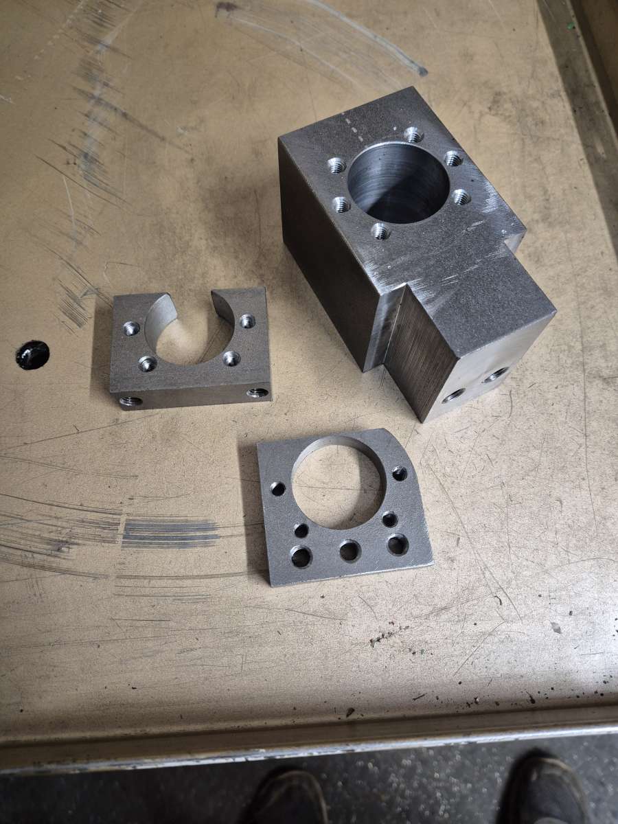

                                              Hi, only new nut mounting block has been made and top casting opened up a bit to fit a new screw in. Not a lot of work. There’s a photo of all mounting blocks, including one for Z axis.
                                              I could send you a private message with links to the parts if you wish.
