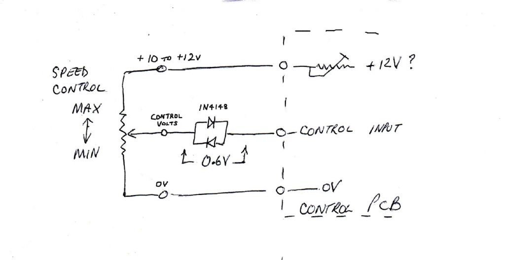

              have a look at the control board
              If your lucky the speed control board will have preset’s for  the maximum and minimum speed marked on the pcb
              (make a note of the position before adjustment of the minimum speed)
              if not and you have the wiring diagram for you machine
              you could disconnect the +10v or +12v supply form the speed control to prove
              that with a control voltage of 0v the speed is 0 rpm
              two diodes can be used to give a 0.6v volt drop to the control voltage to give a small reduction in speed
              I’ll post a diagram
              Edited By john swift 1 on 28/10/2010 17:48:41
              Edited By john swift 1 on 28/10/2010 17:49:22

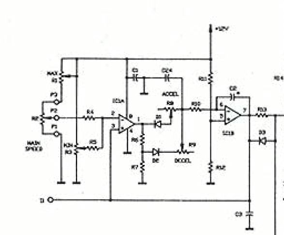

                    found a low res circuit that may help
                    the max speed preset pot sets the voltage across the speed control
                    the min speed preset adjusts a bias voltage to the first op amp
                    it may be worth checking all the electrolytic capacitors on the board
                    ( if you can measure the ESR )
                    Edited By john swift 1 on 28/10/2010 22:03:27

                      Things are not quite like your circuit John. It turns out that the 3 pots, Max, User control and Min are all in series across the supply rails. So with the Min at zero volts I suspect there has been a change elsewhere in the circuit.
                      I shall go round with my Fluke and make sure that the zero setting is indeed zero volts.
