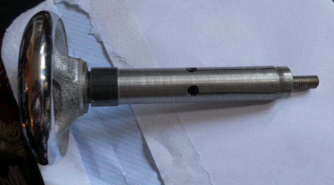

                  while I’m here has anyone made a crank handle for wm180
                  if so has anyone got a drawing they would like to share
                  cheers

                    Look for "How to make a quick release spindle handle for the chinese mini lathe"by Steve Jordan on Youtube,very clever chap.This gave me the general idea of how to go about making one,adapt to suit your needs.

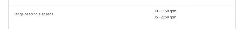

                              Yeah, just like advertising a minimum speed of 30 rpm, when I can barely get below 100 rpm.
                              #555177
                                Mine has been like it from new and so was the one I tested in Warco's warehouse which they plugged in for me. Like Mick mine is a brussed motor and the OP's second hand one is more than likely to be too. Brushless may be different, though the Brushless SX2.7 runs at 40rpm when start button pressed and digital speed control won't make it any lower than that.
                                Bo'sun, what speed range have you got it in as you will only get the minimum 30rpm in the low range.

                                    Posted by JasonB on 22/07/2021 11:16:04:
                                    The drive belt is in low range. When questioning Warco about it, I was told it's unlikely to go down to 30 rpm. If that's the case, then why advertise it as such? It's not been a huge problem, but that's not the point. I can, with a bit of dexterity, nudge it down to just over 80 rpm, but it's not happy.

                                        Watch the youtube vids and see if a drawing is really necessary. The only dimension that matters is the spindle bore which is apparently 21mm – I made one for my Sieg SC3 which like many other mini lathes has a 20mm bore so I used a bit of 20mm o/d x 2mm steel tube for the main body – you will probably have to turn something to fit;.

                                          my simple handle – 22mm OD cutdown to fit into bore – a 6mm threaded rod at one end thru the hole in the fixing of the wheel to the rod (so long ago can’t remember how but locktite probably involved ) and at other end a wedge drawn into the (crudely) split tube to jam it in the bore
                                          Looking at it in more detail looks as though I drilled a 12mm hole in wheel then locktited a top hat sized to fit into tube – I added a bearing between the tightening nut and the wheel
                                          Edited By Frances IoM on 22/07/2021 15:57:44
                                          #555216
                                          Frances IoM
                                            @francesiom58905
                                            forgot to add photo

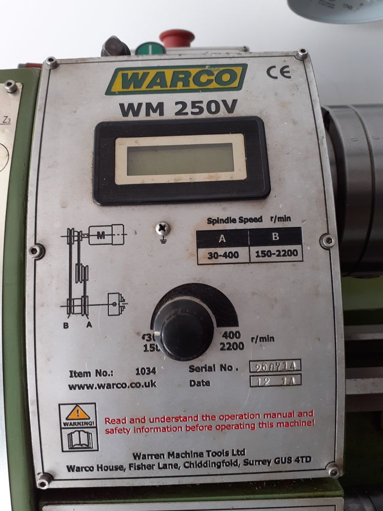

                                                  Mick B1
                                                    @mickb1
                                                    Posted by Andy Carruthers on 22/07/2021 22:01:27:
                                                    Mick – Belief or evidence?
                                                    Purely personal view – I would prefer my machinery to behave according to published specification which is zero rotation when pot fully ACW, anything else IMHO is a fault, and I would look to rectify
                                                    Others are free to have their own view – we don't have to agree, and I'm not after causing trouble
                                                    Promotional leaflet at time of purchase said it has an AC induction motor, so if that ain't so, there's a false trade description offence. There's no statement I've seen from Warco that describes whether the machine will run or not with the pot on bottom stop. However the two speed ranges are shown next to the dial, and there ain't no zero nowhere, so IMO it's reasonable to expect it to run at the low end of the range when switched on at bottom stop.
                                                    I really can't imagine how it could be any clearer.

                                                    Andy Carruthers
                                                      @andycarruthers33275
                                                      I agree
                                                      Your machine clearly shows rotation speeds at fully ACW pot position
                                                      Mine does not, horses for courses
                                                      Thank you for posting, I have learnt something about your machine
