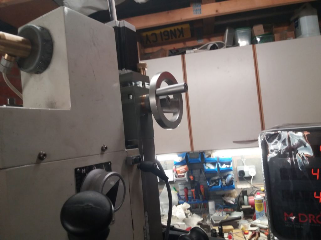

      I have a WM 14 and due to arthritis in my hands am finding it increasingly difficult to wind the topmost main vertical adjustment wheel on the z axis. The larger models have it coming out of the side. I am wondering if I can put a motor on it to make life easier. It is just to move it up and down to within range of the micro z-axis feed.

        Nigel Taylor 2
          @nigeltaylor2
          Yes you can – I have done it and wouldn't be without it now.

          Greg Smith 4
            @gregsmith4
            That looks just the jobby, well done
            Is that a Nema 34 you have used with a belt drive?
            Did you post a thread on how you did this, if not any chance of some specifics please?

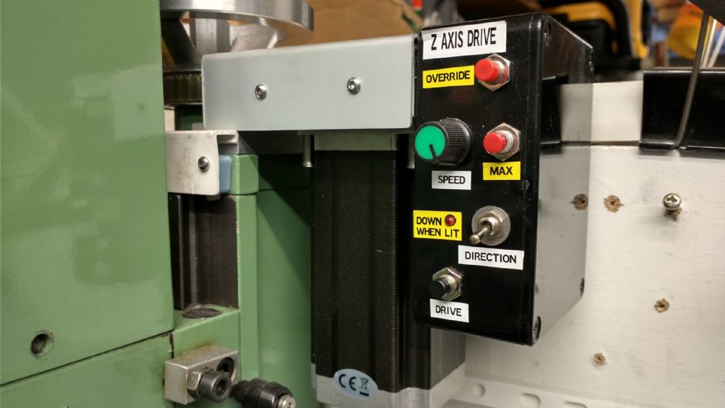

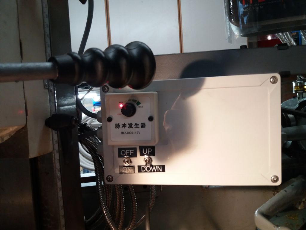

              Nigel Taylor 2
                @nigeltaylor2
                Greg –
                My setup has a NEMA 23 stepper motor driving the toothed belt, the pullleys are 2 to 1 ratio. There is a 24V, 6.3A power supply and a DM542T stepper driver There is also a PWM signal generator board in the black box, with the switches remoted to the outside. All the parts were sourced from eBay sites.There is a microswitch to stop the drive once the head of the mill is at the top of the column, the 'override' button disables this to allow the head to go back down. The 'max' button overrides the speed setting.
                I found a circuit diagram on the 'Myfordboy' website which helped with the wiring. I originally bought all the parts to fit to the x axis, as Myfordboy had done, but changed my mind as to which axis would be most useful to do first. I have still to do the x axis…
