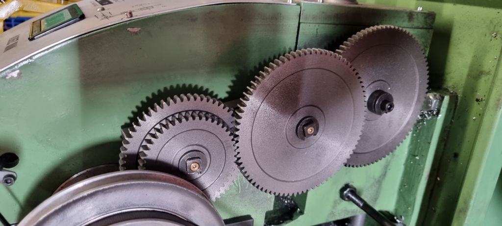

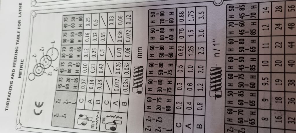

        Recently bought a used WM290V. Trying to set the feed and I can’t seem to get a fine feed. Setting up as the finest feed as the diagram it should give 0.0025” per rev. In use it is quite course and I have checked the gear setup twice and I’m confident it’s correct. I can’t see anyway of getting a finer feed, am I missing something.
        #660775
          Do you have the right hand of the three front levers on feed rather than screw cutting. leaning to the right. This should make the lower feed rod rotate and the threaded lead screw should be stationary
          Middle lever should be over to the left to give the finest of the three options position "C"
          Are you using the lever on the front of the apron to engage feed rather than the one on the right which engages the half nuts.

            #660792
              Post an image of the gear train from the front with the end cover removed and also one of the chart on the lathe, It's probably the same as my 280 but will be easier to check with the chart

                    Andy Shepherdson
                      @andyshepherdson55441
                      Hope the photos help. I'm going to run the lathe at 1000rpm and see how long it takes to travel an inch. Just incase it's my perception
                      Edited By JasonB on 21/09/2023 11:21:41
                      #660886
                        Thats a metric chart so assume you have a metric leadscrew. so th efinest fee dyou wil get is 0.07mm/rev (0.0028" )
                        Although I can't see the 20T gear on the inside the rest looks to be right if C is selected
                        Easier way to check is put a Dti against the carriage and wind the chuck say 10 revs after taking out teh backlash and see if the carriage moves 0.7mm
