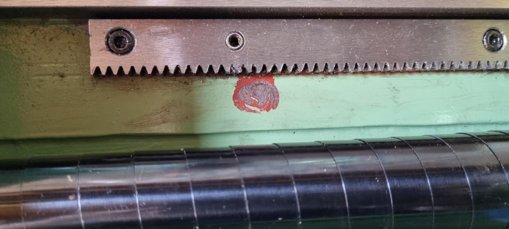

                                  #600528
                                  Bombardier
                                    @bombardier
                                    Interesting post. Just had a similar thing happen to my brand new Wm250V,
                                    after getting the lathe on the bench cleaning oiling and greasing I did two or three manual cuts on a piece of brass then tried a power feed, about 2 inches from finishing the cut the power feed stopped so I quickly turned the machine off. I struggled to disengage the power feed but did eventually mange it, I then struggled to move the carriage away from the chuck as it was really stiff until it got to the centre of the lathe where it freed up a bit.
                                    It seems that the shaft with a gear at the end (sorry not sure what I would call that ) has crashed into the side of the lathe (see picture) and bent the shaft, hence why it moves freely at the middle of the lathe bed but advancing it forward or backward 10cm tightens it up. It has also chewed up all the gears
                                    This is a brand new lathe and it also has a crack or hole in the casting of the power feed gear box and is leaking oil, I have contacted Warco so will see how good there customer service is.
                                    I was disappointed with this as it was my very first operation of a lathe and was hoping to get a good couple of days practice in.

                                          2) I ran out of travel on the crossslide once. The cross leadscrew shearpin did its job and bruk, but the broken end fell out into the apron gearbox, where it dropped into the toothgap of a pinion and jammed it solid. The oil was sticky enough to stop it falling out if I partially turned the mechanism. I had to disconnect the main leadscrew so I could remove the apron front and fish about in the gloom until I flipped the remains of the pin into the oil left in the apron – from where there was no prospect of it ever being picked up again as long as gravity still works as it now does. Then I replaced it with a new pin – very slightly bent to reduce the risk of part of it dropping out again. Problem fixed.
                                          But I see you've got a mangled tooth on your bed rack. It would certainly be best if the rack were replaced. In my case the main leadscrew shearpin (see issue 1) above ) was made of steel, not the usual brass. If this is the situation on yours you might make a case to Warco to replace it.

                                                #600629
                                                Bombardier
                                                  @bombardier
                                                  I hope to hear from Warco this coming week.
                                                  They need to address the oil leak but more importantly how this happened, I have revisited everything I did and I cannot for the life of me understand how this happened.
                                                  As you can see from my photo the teeth are mangled and although not shown in the photo the drive shaft that engages with those teeth is bent resulting in only about 10 cm of free travel left and right before it binds up.
                                                  #600635
                                                  Hopper
                                                    @hopper
                                                    Posted by Bombardier on 05/06/2022 08:24:22:
                                                    To do that kind of damage to the teeth on the rack and the pinion gear and shaft that engage with it, something must have prevented the carriage from moving along the bed as the power feed tried to keep it moving. Usually this is something like the toolpost hitting the chuck or headstock, thus preventing any further movement. Or possibly the carriage lock was on? Or the halfnuts engaged?
                                                    A pic of the lathe overall showing where the carriage and toolpost etc are in relation to the headstock would be helpful in working out what jammed up or crashed into what.
                                                    Edited By Hopper on 05/06/2022 08:52:42
                                                    #600675
                                                    Bombardier
                                                      @bombardier
                                                      Posted by Hopper on 05/06/2022 08:50:00:
                                                      I had only just completed 2 manual cuts and so the carriage lock was not engaged nor did the tool post hit the chuck or headstock. I am at a loss what caused it, hopefully Warco can shed some light on it for me.
