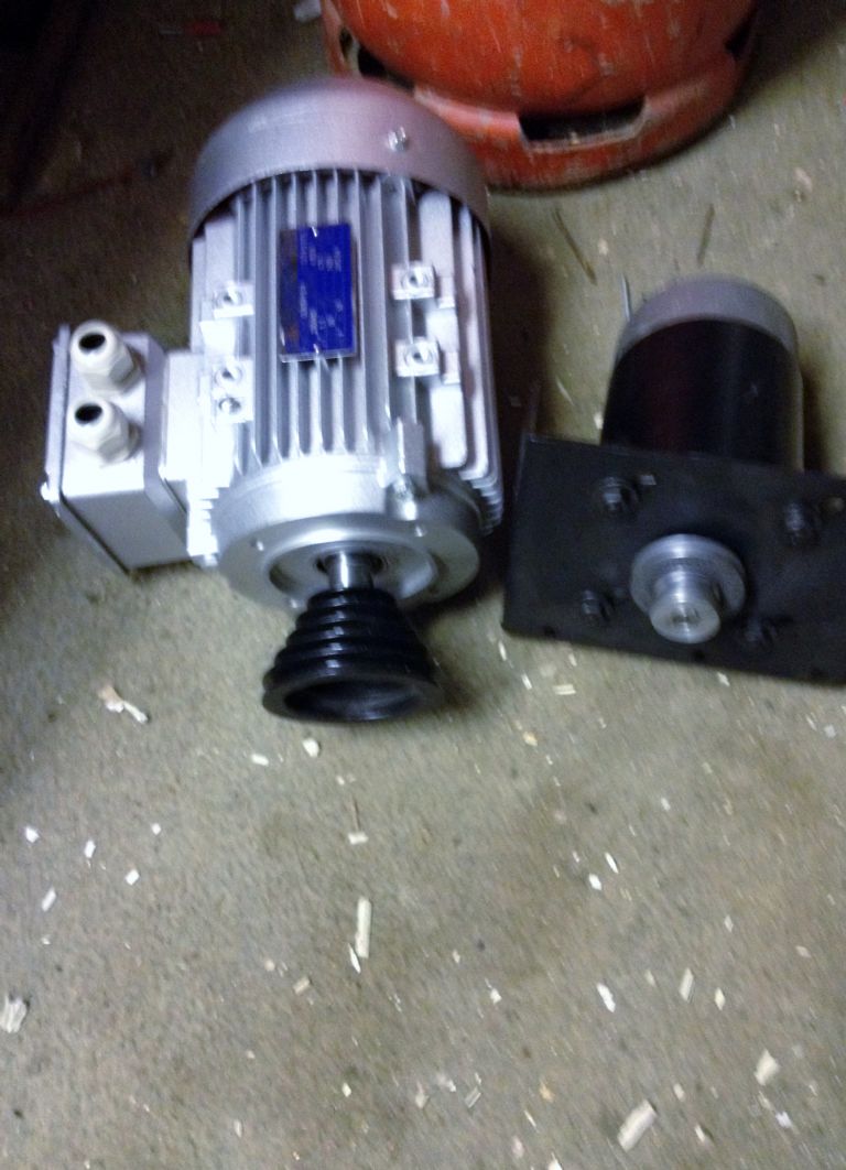

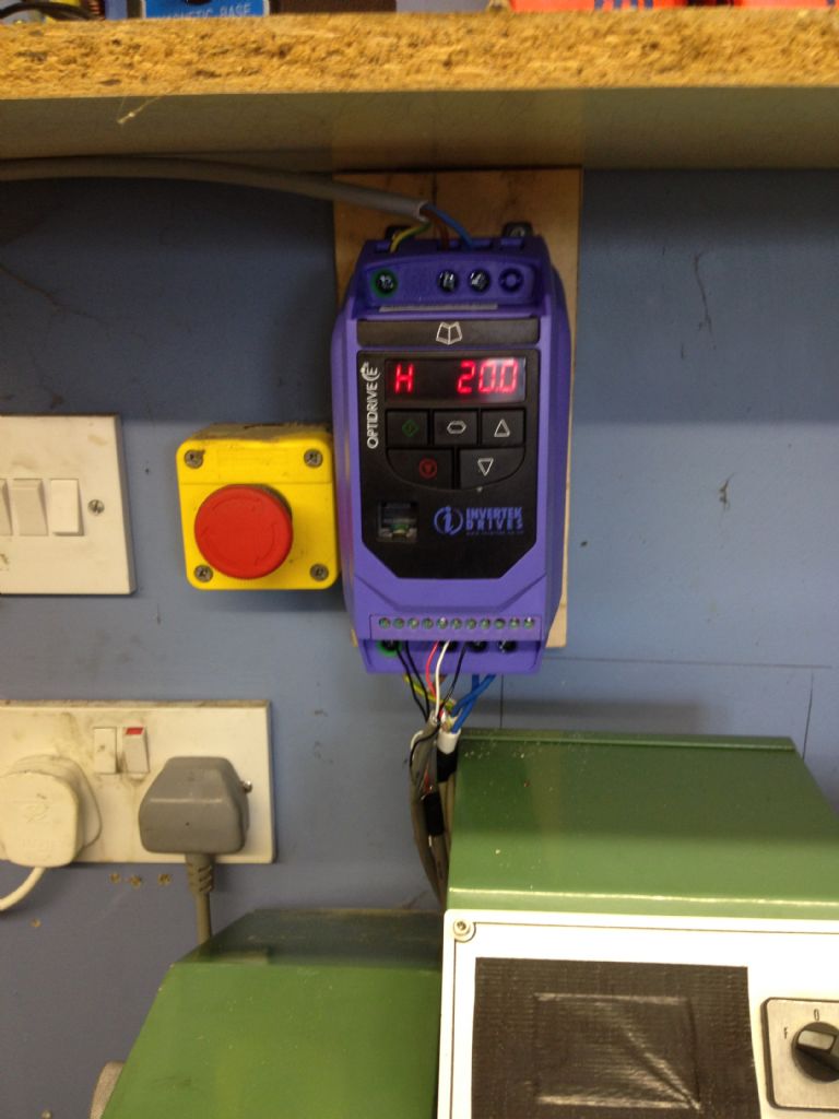

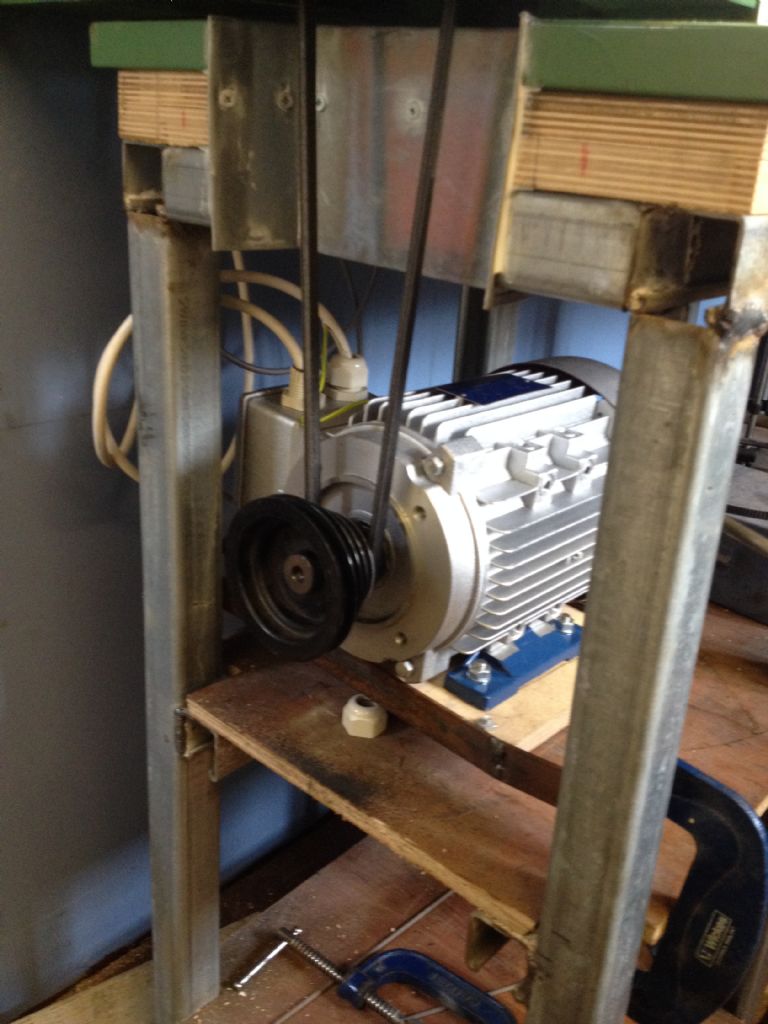

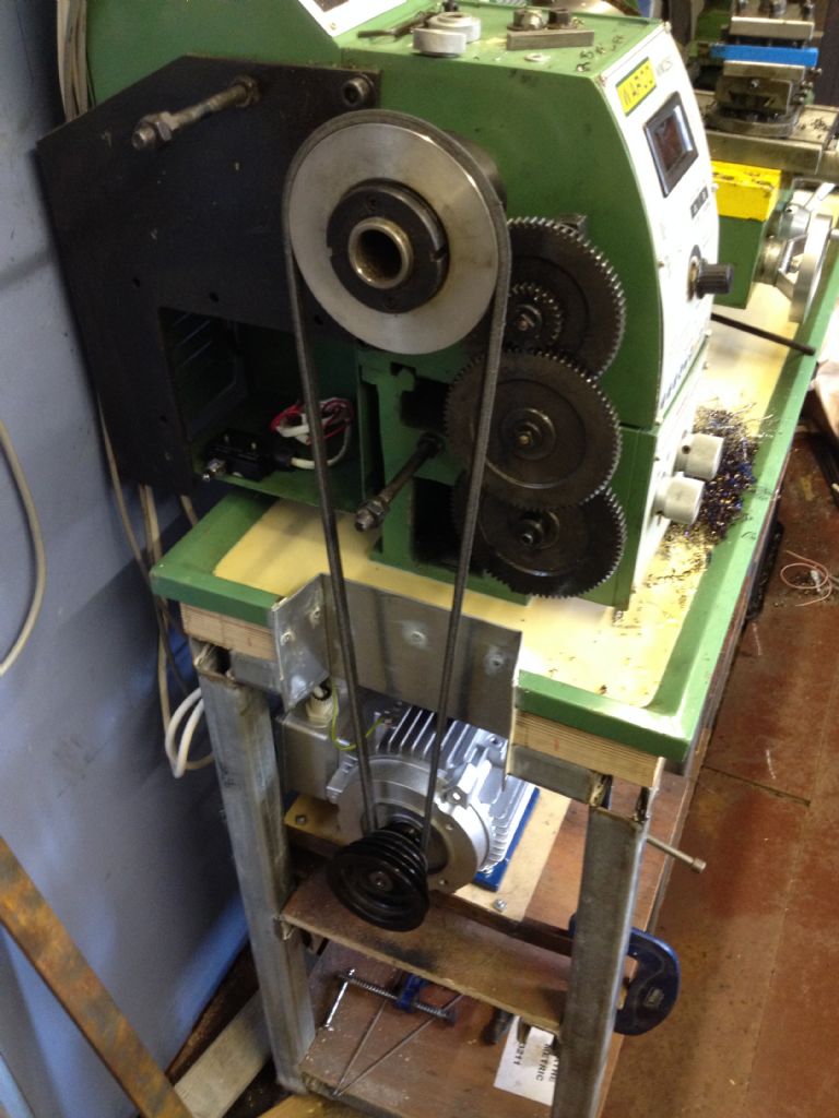

                            Got my new inverter and 3 phase motor fitted in the wm250. The motor is much bigger than the dc one it was replacing.
                            Didn't fancy hanging this lump off the back of the headstock. A bit of work with the angle grinder allowed me to fit it in a swinging cradle underneath. (you'll notice i forgot to thread the gland nut on one of the cables embarrassed)
                            Its all running ok now but was a bit of a game (for me) working out how to set it up using the lathes switch and speed pot. Must say I'm quite proud of myselfsmile d.005.jpg
                            The slowest pulley ratio I could get (not having a working lathe to make some) is 540 rpm. The picture shows it running at 20 hz, which in theory is 108 rpm.006.jpg
                            The next picture shows it turning 100mm dia steel with 1mm deep cut at 20hz. and the motor is as cool as a cucumber… I've got an electric fan for it which I will wire up on a seperate switch.
                            Got to say this is so much better with loads of torque for doing the odd large dia job. Was thinking of later making an intermediate twin pulley to halve the 50 hz speed to 270 rpm
                            If your dc motor is struggling,change over,you wont regret it…..
