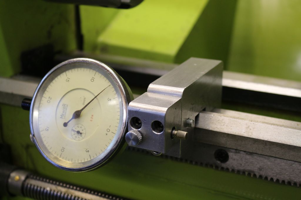

                  Decided to make a tailstock fitting to attach a digital tyre depth gauge to my tailstock, to get a better reading for depth drilling, a lot of members will have something similar no doubt. Used some ally from my scrapbinium box, some neodiminiminum…? …. 'earth' magnets & some epoxy resin. It gave me a chance to use my rotab' for the first time since I got it a year ago so it was a learning curve as well as making something from my 'toduit' list.
                  The only addition to the digi gauge was to fabricate a small steel plate on the back of the gauge at the front end which had 4 small magnets epoxy glued on & 6 smaller stacked magnets at the rear end (2 stacks 3mm x 1mm) this was then just placed onto the tailstock. I glued a 6 x 1 magnet onto the back of the clamp which when attracted to a small magnet I'd fitted to the stem of the gauge sometime earlier gave an extra strong magnetic pull.

                  #134133
                  Rik Shaw
                    @rikshaw
                    bed stop.jpgNovel way of using a depth gauge George, let us know how you get on with it.
                    I have made an improvement to your bed stop design. The "piggy backed" piece of ally is secured by 2x 5mm capheads.  I can now use a DTI without removing the original threaded stop.
                    Edited By Rik Shaw on 30/10/2013 16:14:26
                    Edited By Rik Shaw on 30/10/2013 16:15:07
                    #134151
                    mechman48
                      @mechman48
                      I like it, thanks for the update, much prefer to see nice large digi' numbers though what with my eyes and all, nice mod never the less, will keep in the memory bank… memory bank ! … where's that, & what interest rate are they paying?… ho hum, retiree's humour face 22.
                      George

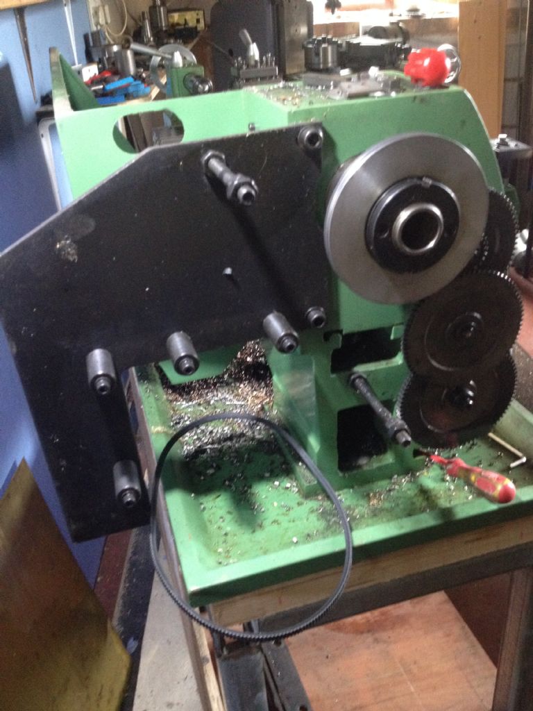

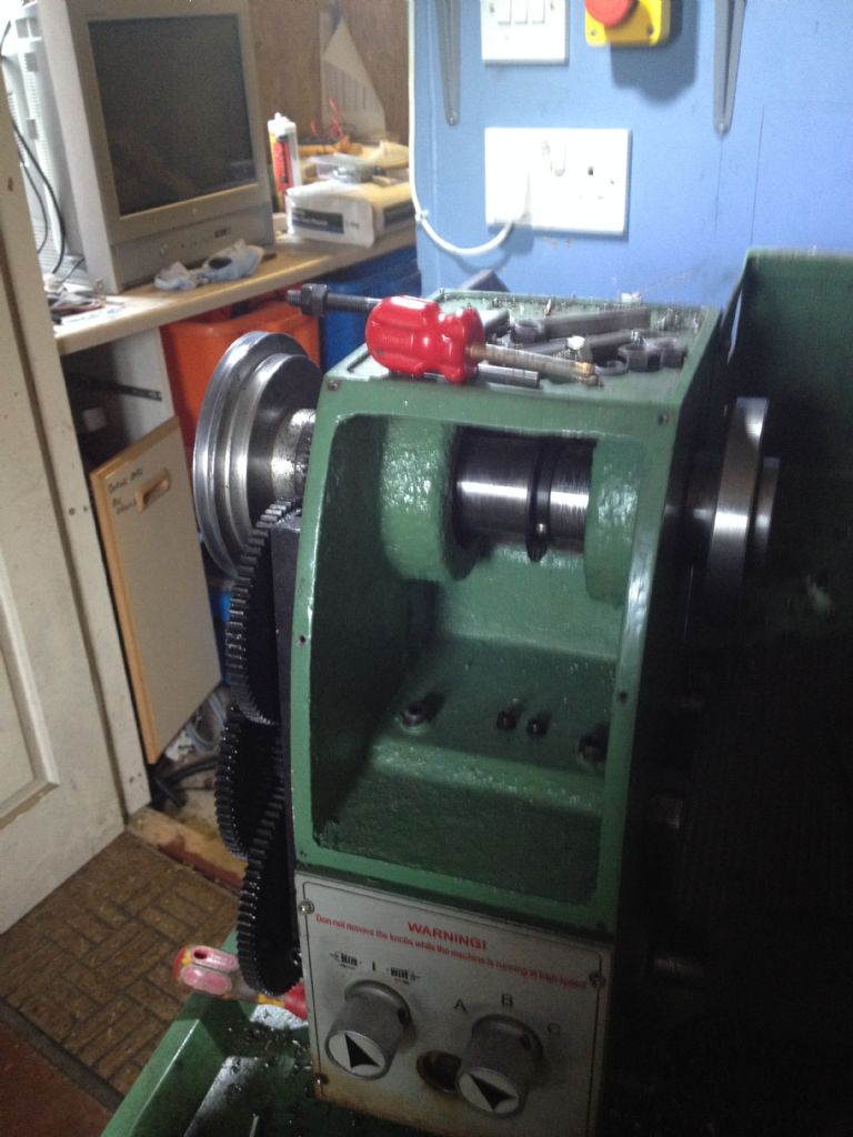

                                    006.jpgI've had my wm250 for over 4 years now and I've been happy with it other than the variable speed.Its hand being able to turn the speed up and down whilst on the move but the torque is pretty poor at low speeds.The motor soon gets hot with a low fan speed and you have to keep stopping when it starts to smell that unmistakable smell.
                                    I decided to splash out £100 and get a qctp from rdg.Beautiful bit of kit,but of course it needs slight modification. Following the way its done on this link http://www.cign.org/wm250qctp2.html I had to turn a short 84mm plinth for the post to stand on. All I had was a piece of about 4" so I started turning that down. What a joke could only put on 0.5 mm cut on the dial,that's 0.25 mm deep cut. The lathe would stall on anything less than 150 rpm so next thing I know the rcd tripped. My old Myford,as worn as it was would have made short work of it in backgear. Don't know if I got a bad machine or what. Is anyone getting any better performance ??
                                    what iv'e decided to do is go 3 phase with inverter as per my milling machine. Started stripping the dc stuff out.
                                    Went on ebay this morning looking for a suitable motor and inverter and after a couple of clicks my pp account suffered to the tune of nearly £300, but worth it I hope. 005.jpg

                                        Thanks Rik, Yes a lot better than mine was doing I think. Anyway I've gone past the point of no return now so fingers crossed the motor will squeeze in. I'll keep the gear ratio low, about 700 to 800 rpm at 50 htz so there will be plenty of grunt low down. In 4 years I've never felt the need to go into the 1000 to 2000 speed range. I'll put some more pictures up when the goodies arrive. John

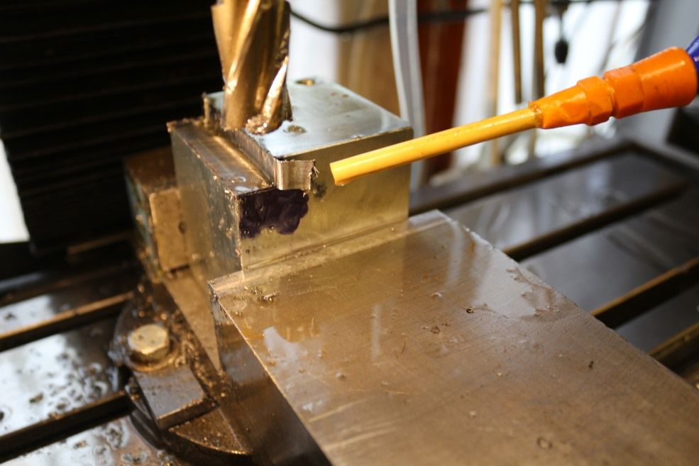

                                                  Started work this morning on a rear tool post for the WM-250-VF using this block of steel which will elevate the original tool post (I use a QCTP these days) to the correct height.
                                                  First thing to do was to remove 9mm from one end with the WM-16 milling machine. As you can see in the photo I have taken the first cut of what was going to be several.
                                                  Now for the main point of the post. By the time I reached the end of the cut the shed was filled with the pong of burning motor and several strange electrical "popping" noises came from the motor although it made it OK to the end.
                                                  The cut is approx. 13mm wide x 8mm deep taken with a fairly new and sharp 20mm dia. Dormer HSS end mill. Speed adjusted to 450 rpm I hand fed at a fairly easy rate and it took maybe twelve minutes to get from one end to the other. By this time the motor casing was very hot indeed certainly to hot to continue further work.
                                                  I have stopped trying to do this on the mill and intend doing the job using the four jaw chuck on the lathe. I do not want to destroy the mill.
                                                  I am not surprised by this overheating as it has happened before. My CY90 band saw also gets very, very hot when cutting through something similar – even with a new Bi-metal blade fitted.
                                                  It seems as though I might be expecting to much from my little mill – what do you think?
                                                  Rik
                                                  P.S JasonB – thanks for stopping me from selling my original tool post a while back its going to come in handy after all.
                                                  #145961
                                                    I'd say you are taking far too big a cut for that size of mill and judjing by the large burr on the block your cutter is blunt
                                                    #145962
                                                    Anonymous
                                                      A 20mm diameter end mill at 450rpm gives a cutting speed of 93fpm; very reasonable for low carbon steel.
                                                      From the dimensions given for the cut I estimate that the length of the block is about 60mm. That gives a total volume of metal removed of 0.38 cubic inches. If the cut took 12 minutes then that is 0.032 cubic inches per minute. A useful rule of thumb is that 1hp will remove 1 cubic inch of material per minute in low carbon steel. So for the cut in question the power required should be negligible, a few tens of watts. If the motor got hot then it would seem there's something wrong with the motor or drive?
                                                      As an aside I would suggest that the feedrate was at least an order of magnitude too slow. Assuming a 4 flute cutter the chip load was about a tenth of a thou. I'd be up at a few thou per tooth. I would think that the cutter might have spent more time rubbing than cutting; did it get hot too?
