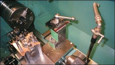

                    I want to buy a rear mounted tool post for my WM250V-F lathe which I would like to use with a parting off tool. As far as I can see WARCO do not list one as an extra. Do you know where I can buy one?
                    Rik
                    #127875
                    mechman48
                      @mechman48
                      JasonB/Thor… thanks for the tip.

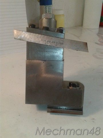

                      Rick… I made mine from a Hemmingway kit as I couldn't find one to buy either (non available for this machine) but had to modify fixing from that described in kit plans & the blade angle left too much sticking out to meet centre height causing blade to flex (not rigid enough) & parted off pieces to have concave /convex sides so have used ordinary parting off holder inverted in 12 mm slot on other side of block … lot more rigidity… works a treat now. Will post pic of alternative holder set up… when I find it ! other pics in album 'Rear tool post', will do write up on process later but pics will give you good insight.
                      Assembled tool holder
                      Cheers
                      George

                        Rick
                        For your info… from Hemmingway kits, this is what I bought…
                        Rear Tool Post for Larger Lathes Ref: HK 1071
                        Price: £49.30 (Including VAT at 20%)
                        One of George Thomas' simplest and most elegant designs, the Rear Tool Post, with its indexing turret, has become a vital addition to all Myford lathes for the past 30 years. And now, Hemingway is pleased to announce a new version, based on the work of both G H Thomas and E Riley.
                        Suitable for lathes with up to 3 ½" between the cross slide and centre, the kit includes the main casting and all material to complete a substantial Rear Tool Post for your Boxford, South Bend, Atlas, Chester, Harrison, Myford 254, Colchester, Warco, Grizzly. Plus many more. The Rear Tool Post is designed to engage with either a single T slot or a pair of tapped holes towards the rear of your cross slide. The turret is designed to accept a parting blade and an additional inverted tool up to ½" square. Picture shows the tool post armed with an inverted carbide insert holder and HSS chamfering tool.
                        Cheers
                        George

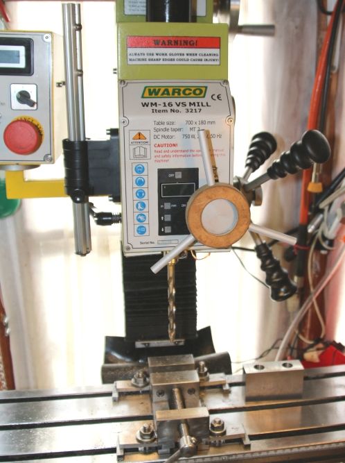

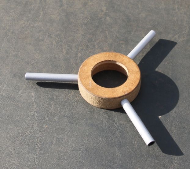

                                              I have found that the boring of deep holes on the WM16 to be an uncomfortabe task particularly as I suffer from bad cramps in my fingers. A slow two handed controlled feed with that little grey fine feed knob is not an enjoyable task.
                                              Decided today that I would make the job easier by knocking up a very basic prototype aid in the form of a larger hand wheel to fit over the millers knob.
                                              Hub is MDF bored out for a nice gripping fit on the knob and the ally tube handles are a tight push fit in their holes with added superglue.
                                              If this turned out OK – and it has – I had intended remaking it with an ally hub, a proper job, but as this works OK I'll wait until it falls apart (I have a feeling it won't.
                                              Rik

                                                nice handwheel, using the fine feed knob to move the quill down is not easy on my old fingers either. I usually use the coarse feed handles though.
                                                Thor
                                                #130322
                                                Sub Mandrel
                                                  @submandrel
                                                  On my X2, which has a smilar arrangement, I find that the length of the main capstan arms is so great, that I can adjust the head position to the limits of my DRO, however. it is very easy to overshoot.
                                                  I had planned to put a handle on the fine feed knob, but I might copy your design instead.
