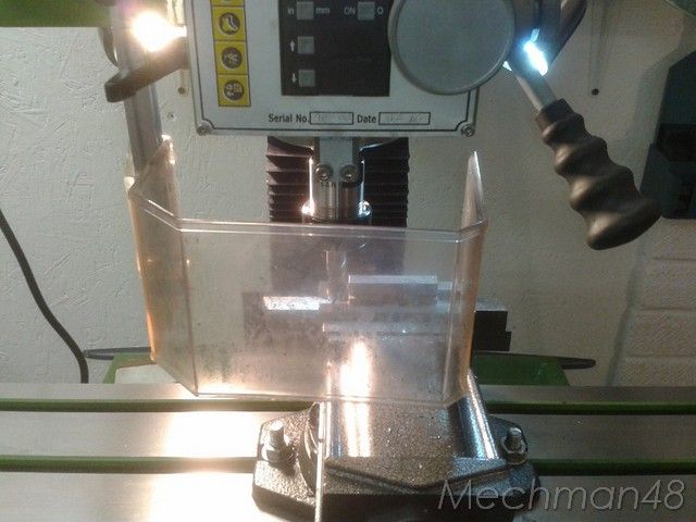

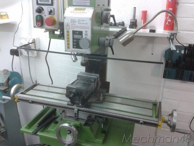

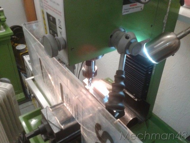

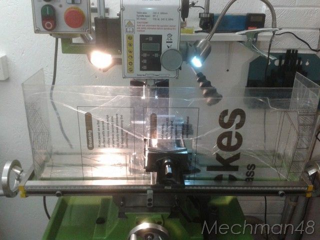

      Congrats on getting your 'new toy'' sorry to hear your initial probs, forunately I didn't have any electrickery probs with mine,but as with all these chinese imports QC leaves a lot to be desired & the 'test record' can be construed as much relevance as the proverbial chocolate fire guard! as proven with my 250V-F, a few not so small probs with that on delivery but that's another story albiet resolved by Warco, I can hazard a guess that 'Dongfa Yan' may be related to Hu Flung Dung..! wink
      As with Mark P I removed the guard as it was interfering with my vice too so I ended up fabricating another version out of 2mm Acetate bought from a local DIY store, I also removed the side post ,just leaving the microswitch bracket fixed & the switch permanently in contact so no bother rememberng to close the guard to energise the switch. The guard can be lifted on & off & is secured by a couple of small brackets with small nemo… neomid… neodim.. aah b*****cks! dont know a couple of small earth magnets which stick it to the table.
      Guard mods
      As supplied with machine..
      Guard mods
      2 mm Acetate fabrication..
      Guard mods
      Much better view..
      Guard mods
      Have yet to fit rear panel, can't decide whether to fit another panel or a clear PVC flexible sheet… I think The PVC sheet is the way to go thinking.. mmmm! maybe switch the front panel to the back & put the PVC sheet in front, held on with more neo..*******! earth magnets,  that way I can move the PVC easier than taking the acetate on & off, & it should act like a cricket net if anything untoward happens, absorbing any impact…?

        I must do the control box mod (ie put it on a stick) to my WM16 George, mine is the early model with the box bolted direct to the head make using the quill lock hard as it hits the reversing switch.

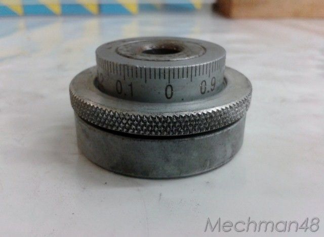

            Rik,
            When you get your WM250V-F I would carry out the same checks as the mill, backlash, snug up gib strips etc .NB. Make sure that you test the saddle for free travel all the way from tailstock to headstock without it binding anywhere, on the first delivery of mine this was a major prob' as the saddle was binding on the bed casting.. manuf /assembly / QA fault' this was soon remedied as I sent it back after a few phone calls, plus e-mail with pics to Warco, received replacement within the week so thumbs up to Warco for after sales response thumbs up.
            The compound slide gib strips are of MS & are not exactly what you would call a good fit so I intend changing them to brass… eventually ! I also checked the alignment of the tailstock & found it to be out approx' .006" ,how I found out was when using a drill once I noticed the drill (new one) pulled in toward the small center drilling, which indicated a misalignment of the tailstock barrel so out came the indicator & DTI's & after a bit of tweaking on the tailstock adjusters(I also noted that the scale on the tailstock rear didn't quite line up on the 'zeros', I've managed to get it to wtihin .0005" now & the scales read 'zero', also today when I tried drilling again the drill lined up with the centre drill so Bob's your auntie so to speak.. so check yours when you get it!.  I had a similar problem with the electrics on the lathe; no power on start up, checked around & found the tab on the drive end guard was bent & not pushing in the microswitch cut off to the motor, bent the tab out ..still no power.. found  the emergency stop retainer was loose & had also disconnected one of the wires, reconnected the wire, resecured the retainer,power on…bingo !  so much for QC, & supposedly also been checked by one of Warcos engineers… hmmm? ..dont know  so check out your electrics first when you get it.
            Another mod I did was to make a larger collar to fit over the compound slide friction scale as I couldn't get my (chubby) finger & thumb in to set a zero, obviously made to fit Chinese size fingers, dont know . Thought I had a pic in my album but not, will post it later. So that's it for now,will post again when I move pics into my album.

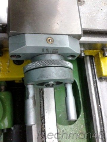

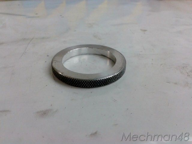

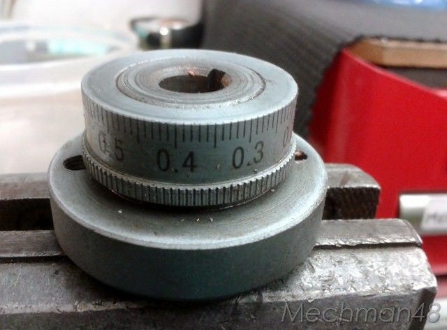

                    As mentioned in previous post; I made a larger knurled grip to fit over the friction collar on the top slide as I could not get a grip on it to set 'zero' due to 'chubby finger' syndrome. I was going to make it a shrink fit but couldn't quite get the dimensions right for hot water expansion method & had no hotplate in the w/shop so I made it a press fit.
                    1. Original as supplied with machine:
                    2.Manufactured new knurled collar
                    3. Press fitted to handwheel over original collar.
                    4. Reassembled to top(compound) slide
                    Obviously the OD can be made to suit your own dimensions but I made this to look cosmetically in keeping with the topslide scale & I can now easily grip to set zero.

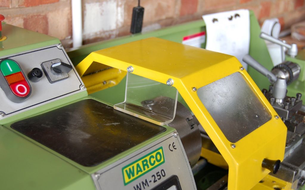

                                            My WM250 chuck guard would not stay up. Possibly stop/shear pin damaged by a small boy.. I bent up some 4mm perspex to fit. It will also stop anything rolling from the headstock into the chuck. Seemed a better idea than dismantling and probing deeper! Steve W
                                            chuck guard
