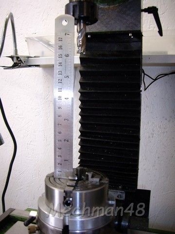

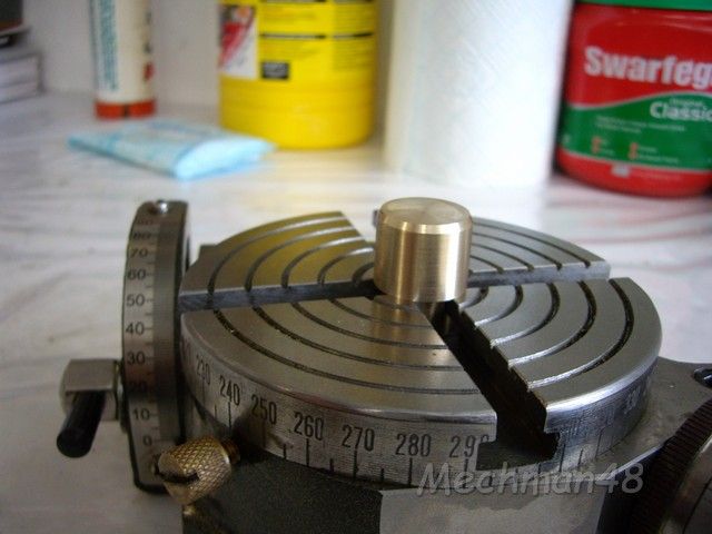

                                    Rik,
                                    I have a 4" Rotab' I bought some time ago from Chronos(usual disclaimer) that hinges to vertical, I have just fitted a 80mm 4 jaw to it this weekend & although it does look 'dinky' I think it will suffice for my needs..at the mo'. I like the idea of using my face plate as an addition to it (thanks for the idea Mark P), anyhow I made an adaptor to fit as when I looked in the centre to identify the taper I found it had a 5/16" BSW thread ..? anyhow I ran a tap down the thread & all the way through to clear out any crap & ensured the thread ended up full size and  an adaptor made to suit, which can also be used to center up the table. I have include a pic of the working height left; from the top of the chuck to the bottom of cutter, 6", with the head at max' elevation, so if I take half the length of the cutter again I will have 61/2" of working headroom, pics are available in my album but have included the main pics here:
                                    Adaptor fitted,
                                    Free headroom approx' 61/2" but will change with whatever is in chuck or if drill chuck is fitted but gives you some idea of set up & measurements.

                                      George, do you find that table will actually stay in any raised position during a reasonable-sized cut?
                                      I had one of those before my current 6" and no matter how hard I tightened the clamp screw the angle would always creep during a cut. I even tried viagra to make it stay up.

                                        Hi Sid
                                        Haven't actually tried it in the vertical.. nor the horizontal yet.. not had the need so far as been piddling about with making stuff to make stuff or replace stuff, if you get my drift e.g had to replace the supplied clamping bolts for my mill vice as they were the usual chinese crap as far as bolts go, inferior metal & too short, i.e. today when I finished making a vice stop & was aligning the vice along the 'X' axis, as I tightened the clamping bolts the threads stripped, no excessive leverage used just a normal open ended spanner so ended up having to make 2 new bolts.. out of proper steel! I reckon all of the far eastern machinery is supplied with the basest of clamps / bolts as far as steel quality/composition goes.
