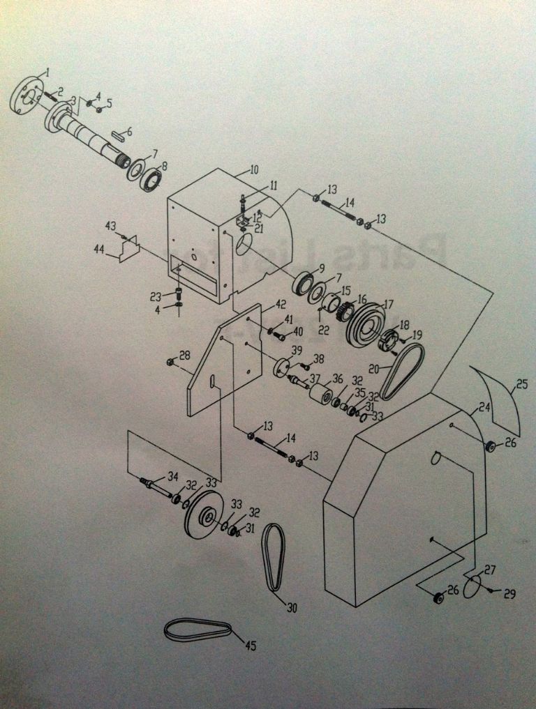

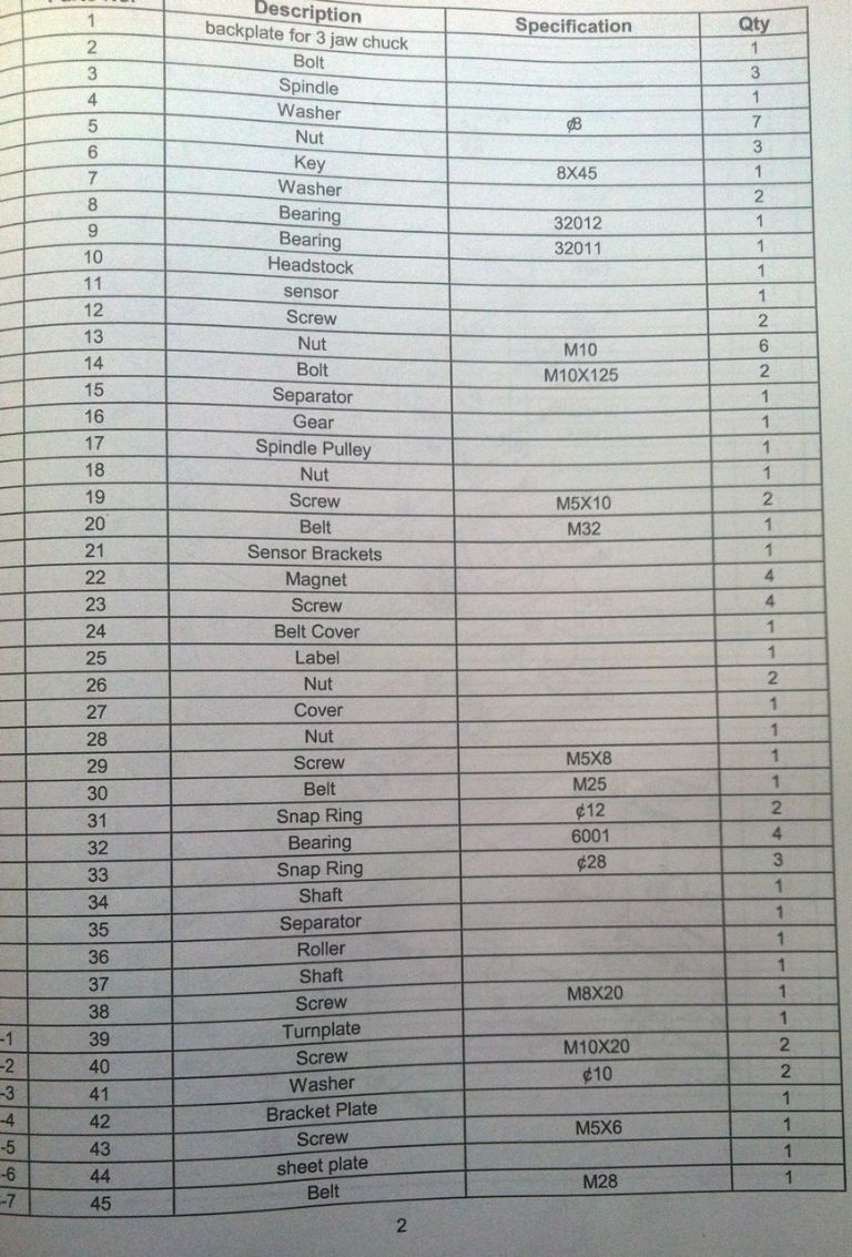

                                        In case this may be of help – for a Warco WM250V (headstock assembly)
                                        Cheers
                                        Garry

                                          Mike, I wouldnt blame Warco for that. The only reason I commented is becasue my previous main business used to be import and export of bearings, and I saw a Russian/Chinese bearing number in the thread from Jason. In any case, it looks Mark can figure out what he will need from Garry's post.

                                              Hi all,headstock bearings replaced.What a difference it has made,quiet as a mouse and a lot smoother running.
                                              Thanks for the info
