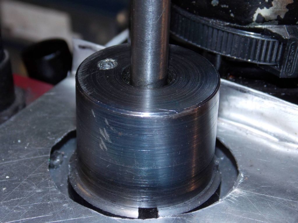

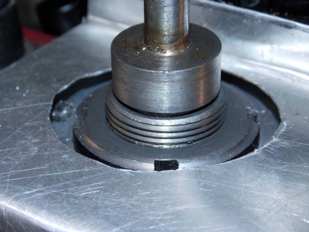

                                            This is my self-ejecting drawbar for an X2 mill. I don't know about the VM16, but the X2 has a left hand thread on the spindle. The drawbar has an 8mm square on the end for a spanner.

                                            dcosta
                                              @dcosta
                                              Hello Rick.
                                              The image in the Warco site explicitly calls it "Captive self ejecting drawbar".
                                              In my damaged Optimum BF20 Vario milling machine (which I think is fundamentally the same machine as WM-16) the draw bar had both roles. I never used the hammer to remove the MT2.
                                              I'm expecting the same or similar functionality in the Warco WM-16.
                                              Best regards
                                              Dias Costa

                                                    Defiantly a self ejecting drawbar on the WM16,don't clonk with a hammer otherwise you will damage the threads.
                                                    Mark P.
