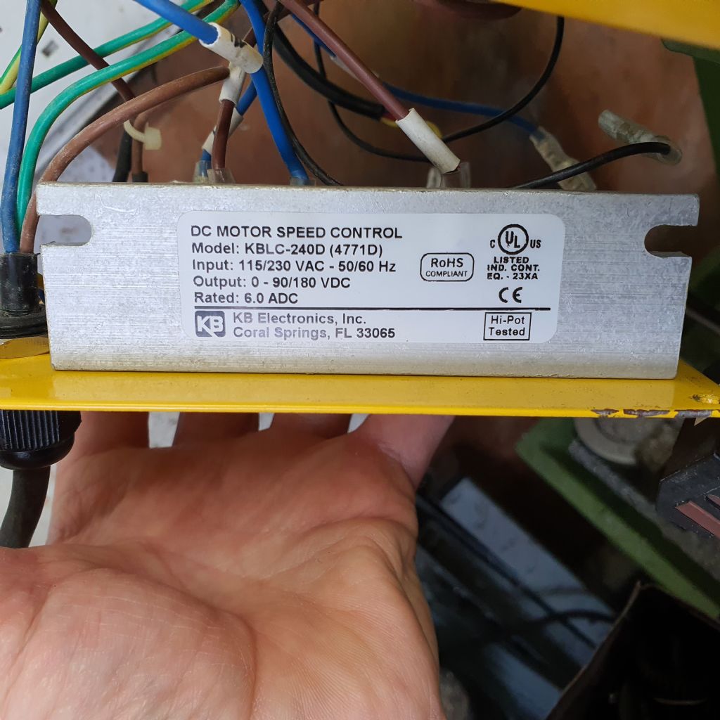

        Hi everyone,
        Thanks for the latest replies.
        Noel, I fitted new brushes some time back but unfortunately it wasn't the issue. I tried redoing the brush ends too. At work I usually use a half-round file with a bit of emery.
        The board I have is from KB electronics.
        Another thing I can check is the contactor contacts. I know these can arc over time and eventually fail. I'll report back with the findings.
        Ed.
        #647448
          Has anyone suggested freezing spray? Described here in detail. Intermittent faults are pigs to find because they're often due to micro-cracks in tracks or solder joints, or to poor contacts inside plugs and sockets. They open and close as the board heats up and cools, so testing with a meter doesn't find them.
          The spray is applied area by area around the board. It isolates the problem by causing bad joints to contract and misbehave when the cold hits them. Once the general area is found, a close inspection usually reveals a cracked track, dry-joint, damaged component, or bad connection.
