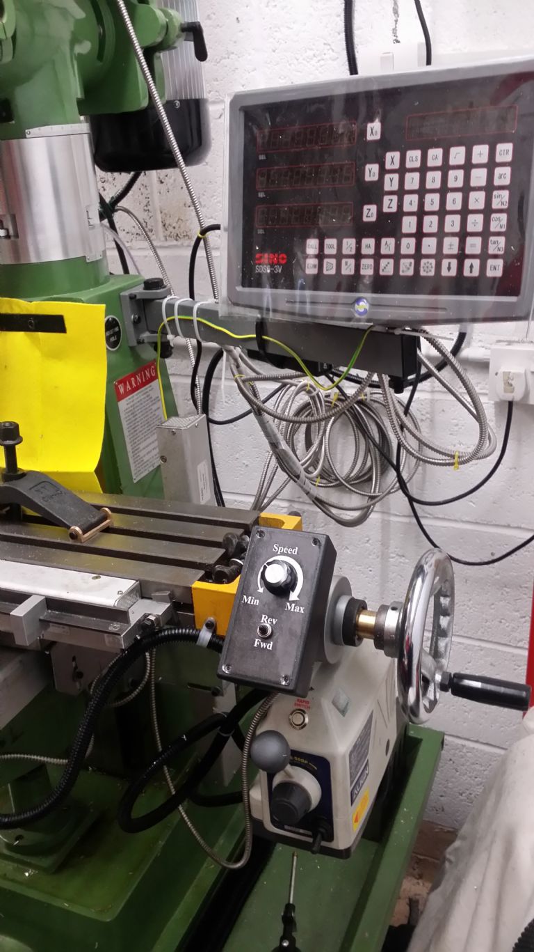

                    A friend has a VMC mill that he decided, before purchase, to convert to VFD drive. He specified he wanted a 3ph motor fitted which I converted from star to delta wind, and fitted a VFD. He also specified R8 spindle fitting.
                    In the photo you can see the control pad for speed and direction control, and the 5" raising block we made. With The mill works really well with the VFD.
