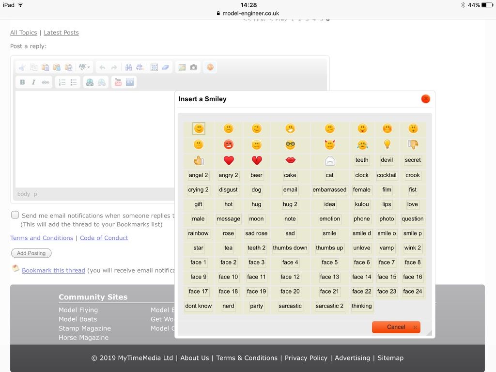

                                      Postscript: Why don't the smileys display correctly in the pulldown?
                                          I was wondering that, too …

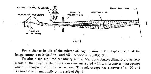

                                              Given that Robert was calling-in the experts from work : I would have hoped that they could detect angles of about 20 seconds using a clinometer … or considerably better than that with an autocollimator.
                                              'though the small size of the mill might preclude convenient use of an autocollimator.
                                              The Hilger Watts TA1 instructions include quite a good discussion:
                                              https://www.chipmaker.ru/search/?q=hilger%20watts
                                              … Vintage stuff.

                                                  How on earth do you find this stuff? Even with the link it took me a while to suss out the Russian website and find the pdf.
                                                  If anyone else is interested in auto-collimators, this is a sample:
                                                  This is the sort of instrument I dream of finding at a boot sale for a few quid.

                                                    Variations of these are used to check camera lens element alignments with similar accuracy.
