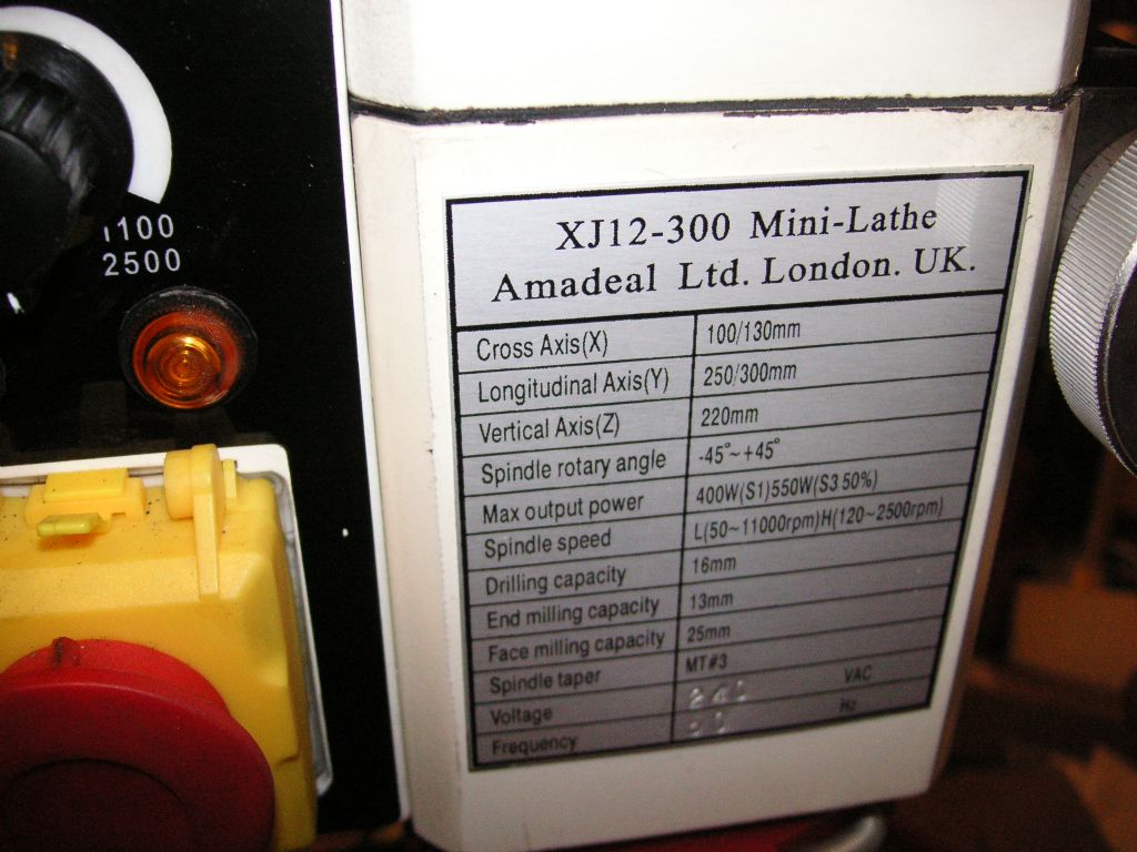

        MarcuSweden
          @marcusweden
          This is how it looks like and the first thing i saw was :
          “Mini-Lathe” hehe , atleast the other data is quite right.

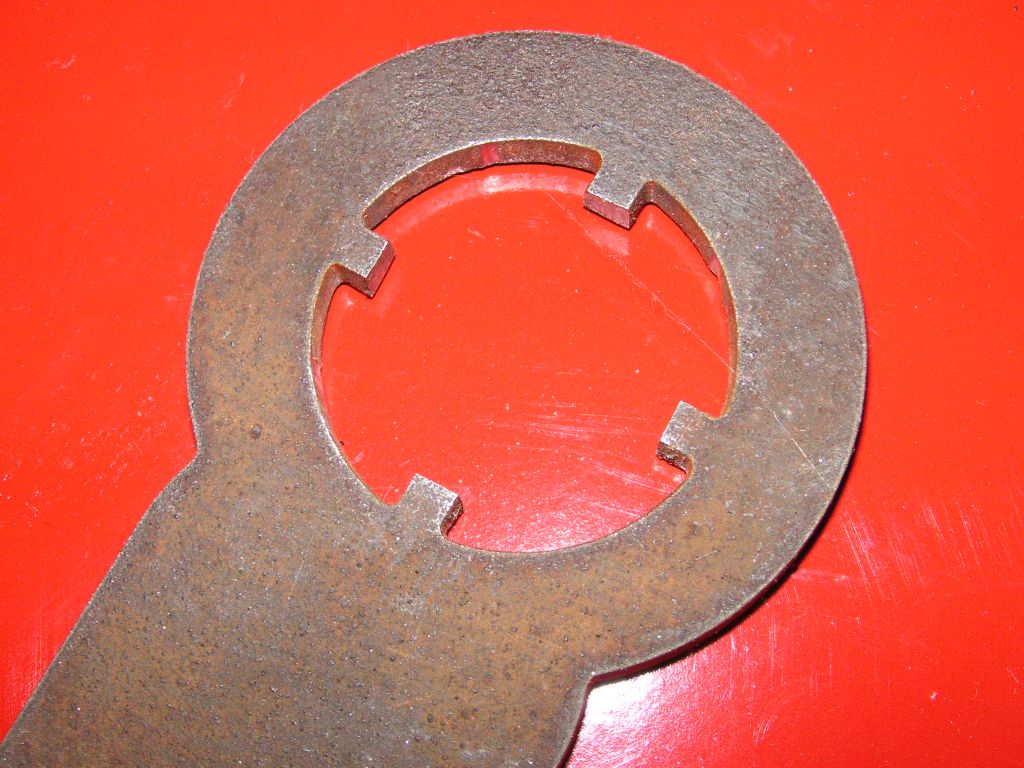

          Second thing i see is that the spindle locking bolt is damaged, so i make one special key in Hardox44 with a waterjet machine.
          I will mail Amadeal about the spindle locking bolt, hopefuly they will believe me if i send picture.
          The electronic board is equipped with the two semiconductors “D8010L” and “A69108” , i think thoose are not real semiconductors becouse i can not find their specifications or datasheet so it is impossible to know what to exchange them with or how to measure them and know that they are broken.
          i started the machine just for a few seconds to listen to the spindle and as i thought it sounds like it would be good to exchange the bearings to something better, maybe some better SKF bearings.
          I also noticed that the “fine feeding” on Z-axis didnt work , i dont know what is wrong and didnt had the time to examine.
