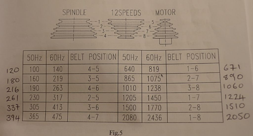

        Hi, I have an old warco milling machine with the belt drive. Can anyone please give me the speeds of the mill in each belt position. Thanks
        #568226
        DiogenesII
          @diogenesii
          The big one, with 12 speeds on three pulleys? ..the Major gives:

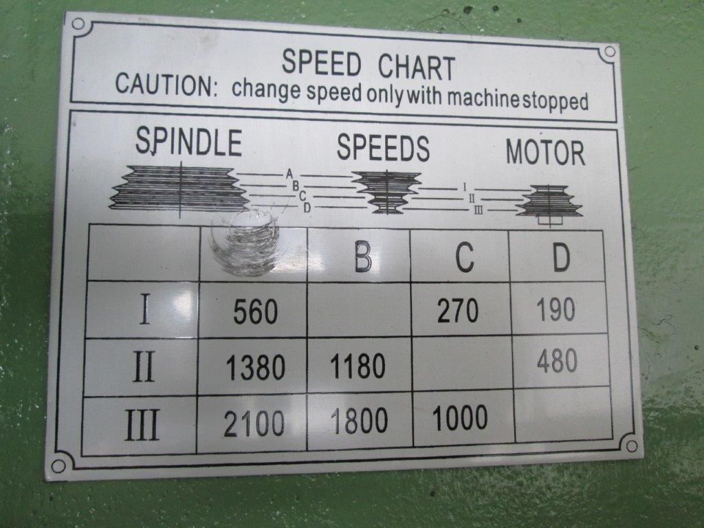

                  On my 2017 VMC, this is the speed sticker on the belt guard:

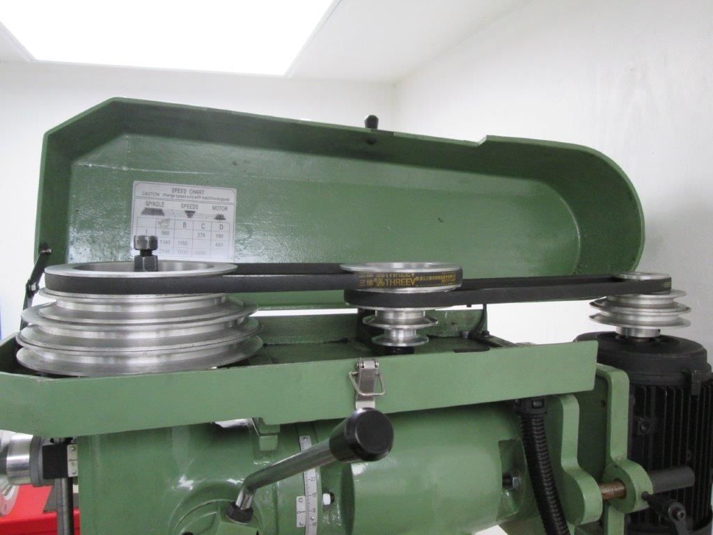

                  This is the pulley arrangement:

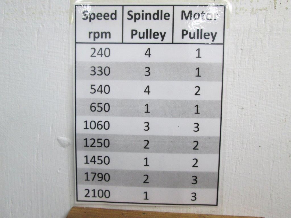

                  This is the speed table I constructed having measured each speed with a tacho:

                      Posted by Glyn Davies on 25/10/2021 20:51:08:
                      As the highest speed is correct it might be you are suffering from belt slip at the other combinations.
