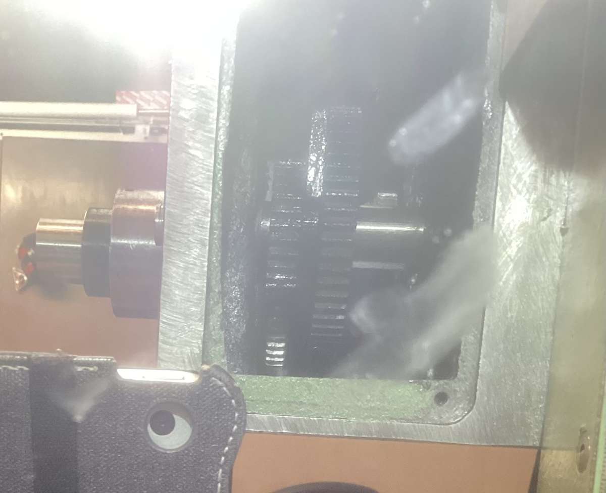

                                  It was a cause of woe for me – at the time. But actually, I learned quite a lot by having to rectify the problem (with the help of other forum members), and I’m pretty confident the mill is better in the gear department now than it was when new. I also quite enjoyed the challenge.
                                  I’m well versed now in what to do if the problem happens again, which it’s less likely to do because a). I’ve got a healthier understanding of the mill’s limits, and b). my repair involved rectifying a gear engagement issue (from new) that made the relative weakness of plastic gears potentially much weaker.
                                  The engagement problem was a result of poorly positioned (by the factory) detentes on the gear selector plate, which didn’t allow the low gear to travel quite far enough up the gear shaft to let the full thickness of the teeth on the low gear engage with the full thickness of the spindle gear. Acting on Jason’s advice, I drilled new and better spaced detentes on the opposite side of the plate and now the low gear as well as the high gear have full thickness engagement with the spindle gears.
                                  The photo below shows the inside of the gear case after fitting the new gear. Image quality is poor because it’s taken in a mirror; you see, I didn’t pull the bench the mill sits on away from the wall (too much faff!) to do the repair but did all work in the gear case from the front of the mill whilst reaching round the back and seeing what I was doing by use of a strategically positioned mirror. Difficult at first, but it got the job done.
                                  IMG_0845

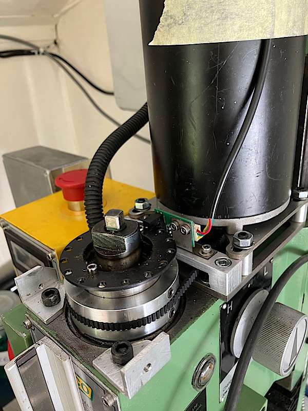

                                      I have Warco’s smallest mill WM12 & have a belt drive conversion on it mainly because of noise and stripping gear teeth , while I had it apart I looked to see a way to lubricate bearings but the best I could do was smear it where I could, I don’t do big jobs on it although saying that I have cut a few dovetails and made a tool holder for my Pultra, the belt drive conversion was the best thing I have done because not only quieter I get a better finish.
                                      DellIMG_1961IMG_2559IMG_1062

                                        So I assume that the spindle drive extension on the WM12 (the bit upon which the perforated speed plate sits that you can just see above the pulley) is all  one unit down past the top bearing?
                                        On the WM 16 (or at least on my version ) the part above the bearing supporting the speed plate is just a separate bush pressed into the spindle drive extension exactly at the top bearing with about 1/2mm of support metal. OK to carry the speed plate but certainly incapable of taking the drive from the motor. So belt drive retro fit not possible.
                                        And as you say, if you are fortunate enough to be able to implement a belt conversion, the ear shattering noise of two sets of steel gears hammering against each other 2500 times a minute is gone as has the associated vibration. The mill is much more pleasant to use and finishes are better.
                                        I assume the use of plastic gears in the train seen in WM18 was an attempt to solve the noise problem by introducing a potential failure issue instead.  Top marks design team!
                                        Advice to anyone considering this class of mill, make sure you get the belt drive version!

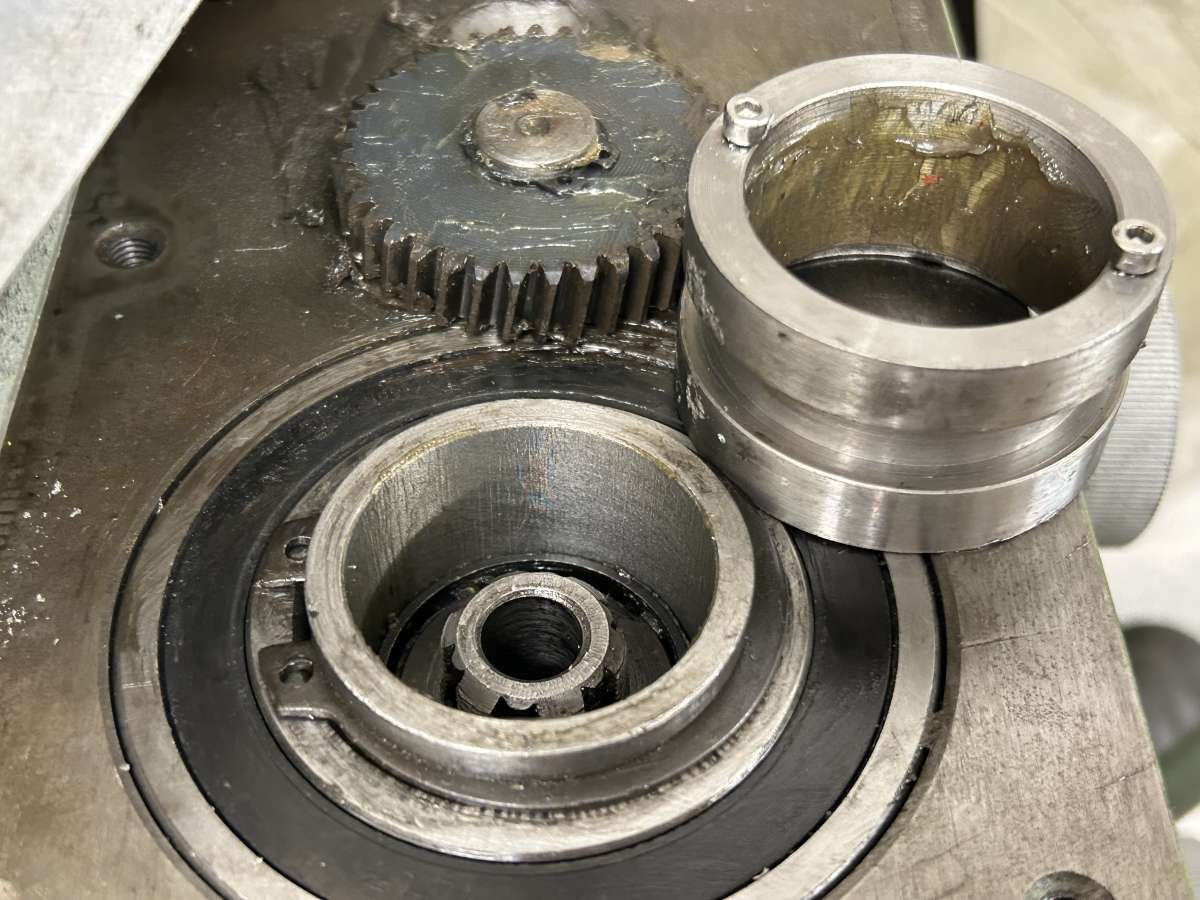

                                                  Jason, unfortunately, the spindle sleeve extension on the warco 16 I have is slightly different from the 0704, being both much shorter at about 3mm above bearing, having no vertical screw tappings.
                                                  I have thought about a bespoke pulley sleeve but to my mind there is just not enough metal from the spindle sleeve projecting above the bearing for a secure pulley fastening.  Had the spindle sleeve extension projected a few mm more I might have attempted a solution.
                                                  Some solutions I have seen use the spindle, or fit a pulley secured internally so quill movement is no longer possible and is not a solution of use to me.
                                                  The only solution I can envisage is one that replaces the spindle sleeve with a longer unit and would presumably be quite expensive as it must be pretty accurately ground and require total dismantling.
                                                  I think the picture sums it up…
