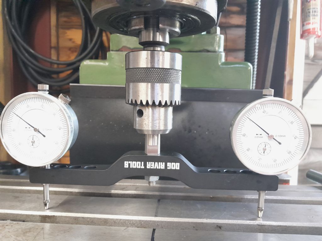

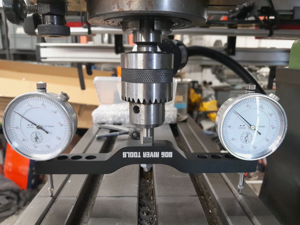

              Hi Nigel.
              I have finally got to the bottom of this.
              My Warco was built with just the one pinch bolt which is mainly found on the Ajax 30 model, some Rf30 and some Warco MD30's.
              The actual machine is made By a company in Taiwan Called Complex machine. and most companies including Axminster and Chester amongst many others.
              The tramming I have now sorted hopefully, was adjusted by loosening the four bolts holding the head to the the base X&Y axis table and sliding in shim sheet, It is now around 0.0005mm or what ever the metric reading of a dial test indicator outer digit should read.. Which according to one person is about as perfect as you can get without trying to find a shim sheet thin enough to actually make a perfect zero. It took a shim of 0.05mm and 0.01mm to get it to that, and to be quite honest if that isn't good enough then sod it! it'll do for me when I want to make my bits for my bike,I think that kind of discrepancy isn't really going to be noticed.

                20230406_131817.jpgI am not sure if this is going to work but I am trying to post a couple of snaps of my first Tram adjust.20230406_131647.jpg
                #640391
                DiogenesII
                  @diogenesii
                  The superfast broadband team finally completed their installation so there are some photo's in an album here;
                  Model Engineer Member Albums Warco Major MD30B
                  ..tram looks good..
