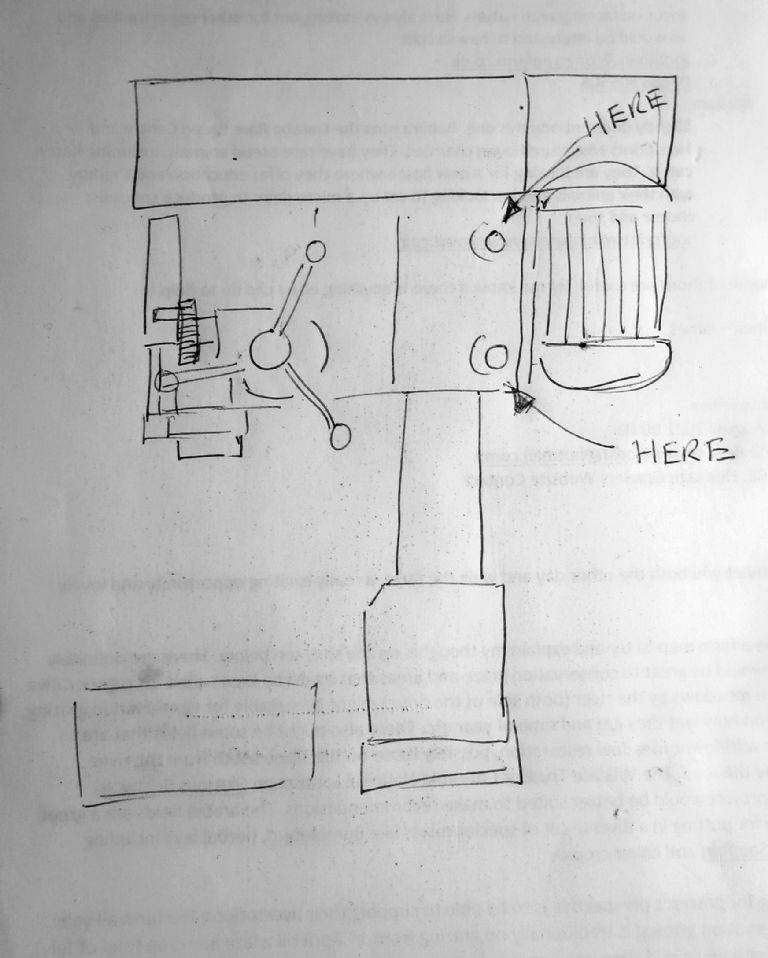

                    #639225
                    DiogenesII
                      @diogenesii
                      The nuts that clamp the head to the column are located on the r/h/side, right at the back of the head casting. Without going to measure I think they are M16 so prob. something like 24mm AF.
                      As far as I know all the Majors/RF30's have a pair of nuts / bolts to clamp the head, if yours is different a picture of what it looks like would help.
                      #639228
                      paul mcquaid
                        @paulmcquaid48093
                        Hi.
                        Thanks for the drawing Mine isn't like that. Where your bolts are, mine are just holes and dead in between those is a single nut which is used with a large chrome handle to undo to raise and lower the whole unit on a rack and pinion crank via a handle on the left side it is also used to swivel the unit right or left. That is the only thing it does though. but if it is out of line, So is this the only way to to adjust it? By unbolting the four mount screws and packing which ever side makes it out?

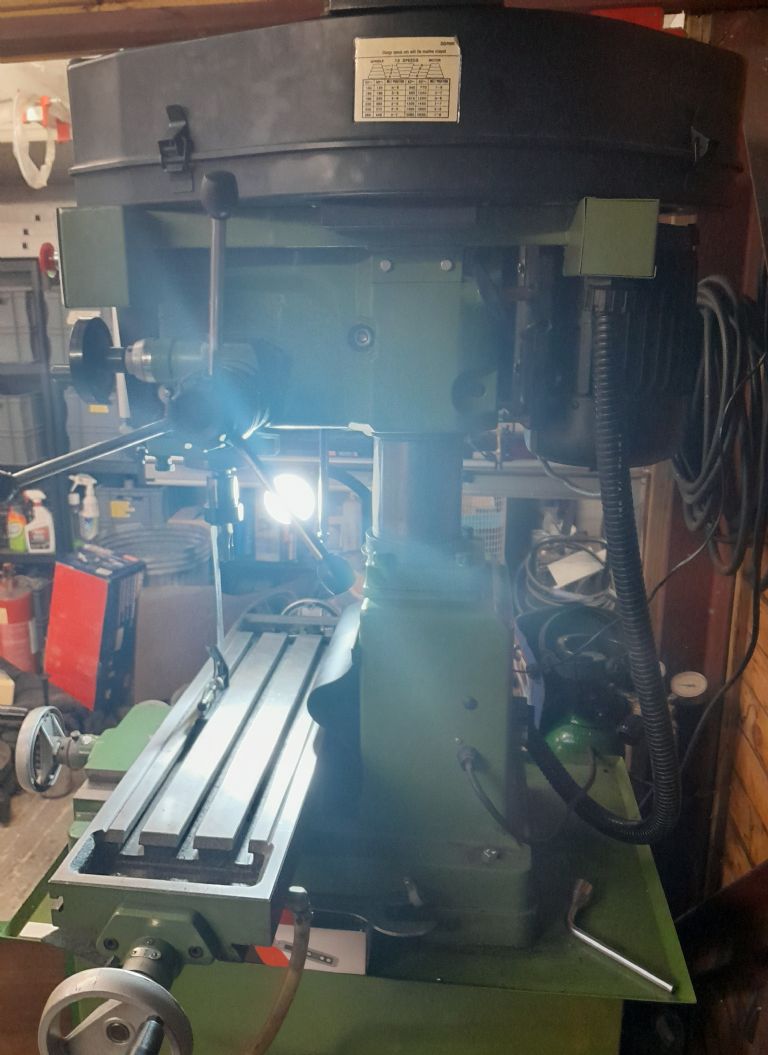

                                  #639343

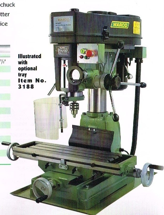

                                  DiogenesII
                                    @diogenesii
                                    So I have a picture of Paul's mill with the single-bolt head fixing, which with his permission I post below.
                                    It's interesting.. ..I've asked Paul to take a look up inside the head and see if he can make out what's what, and why/how this has been done.. ..were they made like this?
                                    The column bolt arrangement is also totally different to mine, which is bolted to the base at the bottom
                                    Edited By DiogenesII on 27/03/2023 21:19:04
                                    Edited By DiogenesII on 27/03/2023 21:20:09
                                    Edited By DiogenesII on 27/03/2023 21:22:06
                                    Edited By DiogenesII on 27/03/2023 21:23:20

                                      #639382
                                      Dave Halford
                                        @davehalford22513
                                        That explains why Pauls doesn't match the info from Warco.
                                        So can we now assume that the missing clamp bolts may be why the tram is off and why he's somewhat unhappy?

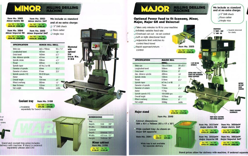

                                        #639387
                                        paul mcquaid
                                          @paulmcquaid48093
                                          Hi.
                                          Table size is 736 x 210 which is the mill drill on the left even though it says Minor.
                                          Mine looks exactly like this major even the X and Y handle bosses are the same Green colour the new ones seem to be yellow. But mine is a central Nut not two bolts.
                                          I have been communicating with Paul about this and have sent some more photo's hopefully he will put them on, As I have been finding it quite difficult..
                                          I have found a youtube link from Forme Industrious restoring a 1984 mode RF30 which also has this single bolt arrangement.
                                          #639388
                                          paul mcquaid
                                            @paulmcquaid48093
                                            Hi.
                                            I have found a Youtube video from Forme Industrious restoring a 1984 mode RF30 which also has this single bolt arrangement.

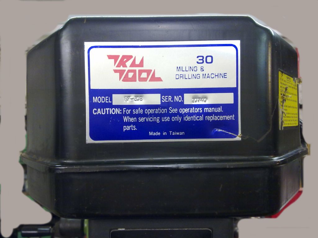

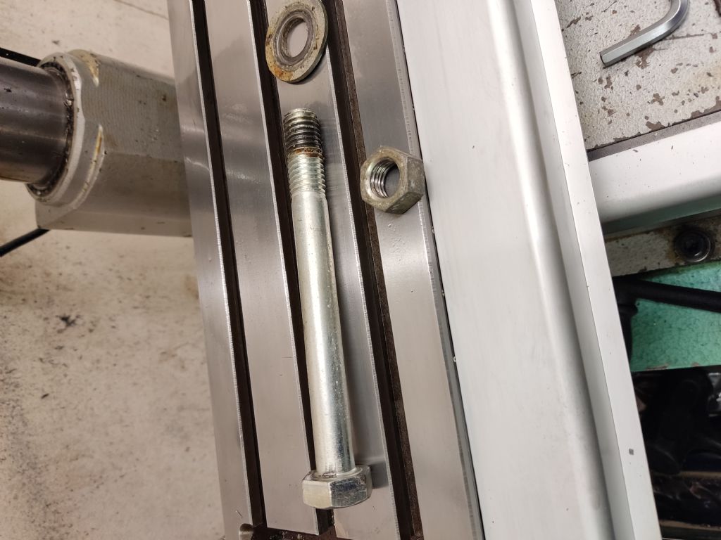

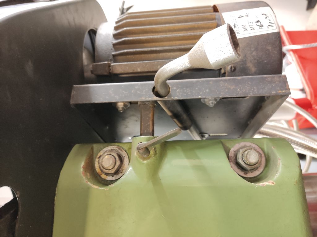

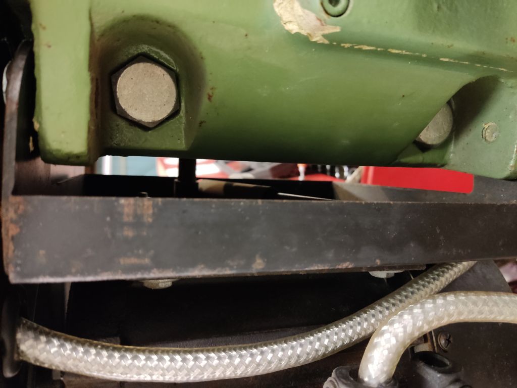

                                            Ex contributor
                                              @mgnbuk
                                              I have an RF30 mill / drill branded TruTool, whcih appears to be the same model as the Warco Major.
                                              The head is clamped to the column with two through bolts
                                              The bolts just push out, the bolt head sitting in a cast pocket in the head casting LHS (viewed from the front).
                                              The bolts on my machine appear to be 5/8"-11 UNC, 6" long. Switching units, the bolt head is 25.7mm AF & the nut 23 mm AF. The OE nut wrench sits in a purpose made pocket in the motor mounting plate.
                                              Sorry for the rotated mobile phone pics.
                                              HTH
                                              Nigel B.
                                              Edited By mgnbuk on 28/03/2023 13:32:42

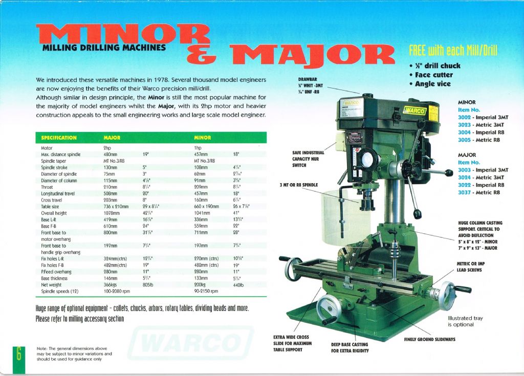

                                              Nicholas Farr
                                                @nicholasfarr14254
                                                Hi Paul, it is certainly a bit of a mystery, but I have found two other illustrations of the two different machines, the first one is from about 1985, and in this one it has Minor on the belt and pulley cover. The second one is from 2002, and both illustrations seem to show the same machine and both have Major on the cover.
                                                The only other dimensions you could check are the diameters of the spindle and the column and overall height, the spindle speed ranges are also a little different.
                                                Your central locking of the head arrangement could be similar to the type shown below.
                                                The yellow colouring on the handle bosses, seems to be started in their 2007 catalogue, and in which the Minor machine didn't appear, and I guess was discontinued by then.
                                                Regards Nick.
