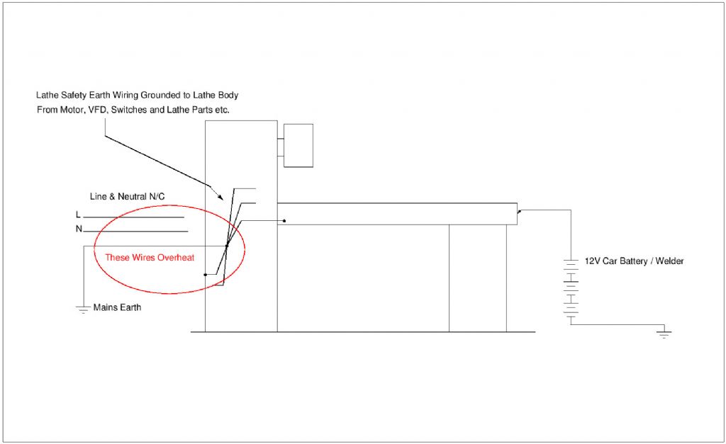

                                So here's a circuit diagram that I think would recreate the damage visible in Tony's photos:
                                All you need to do is connect something capable of delivering a 100 Amps or so for a few seconds between an earth and the body of the lathe. That something could be a car battery, a welder, Tony's "compact little box of capacitors capable of repeatedly jump starting a car or van requiring around 300 amps", or similar.
                                Current flows into the body of the lathe. It does no damage to the lathe itself because the lathe is a gert lump of cast iron. However, when it reaches the common earth point inside the lathe, the current passes into thin copper wiring. This isn't designed to carry much more than 13Amps. The current runs down the mains cable, into the mains earth and completes the circuit back to the source.
                                The wiring inside the lathe (and perhaps the earth wire in the ring main) heat up like the filament of a lamp. I would expect it to cause exactly the sort of damage seen in Tony's photos. Live and Neutral are not involved in this scenario, other than that they are close to the earth wire in the mains cable. I think it possible that the lathe could survive the initial incident, and then work briefly despite the damage.
                                This is just supposition; to really know what happened an expert would have to look at the real thing. Still, if I ever need to deliberately damage a lathe's electrics, I think this is one way to do it.
                                I'm glad it's not my lathe!

                                    yes that could explain the damage but suspect there would be an almighty bang + signs of a weld as the 100A hit the lathe bed
                                    Tony – yes I understand there is no visible damage outside of the lathe + its powerlead – I’m assuming that the cct testing was done post lathe problem – if the current was fed down the earth wire within the ring I wouldn’t expect to see any significant change in resistance or insulation between L (or N) and E lines if the ring is tested in the normal way. I suspect any fault will be found elsewhere and that the lathe was an innocent casualty however untidy its internal wiring was – I do hope Warco report back on what they think the failure mode was.
