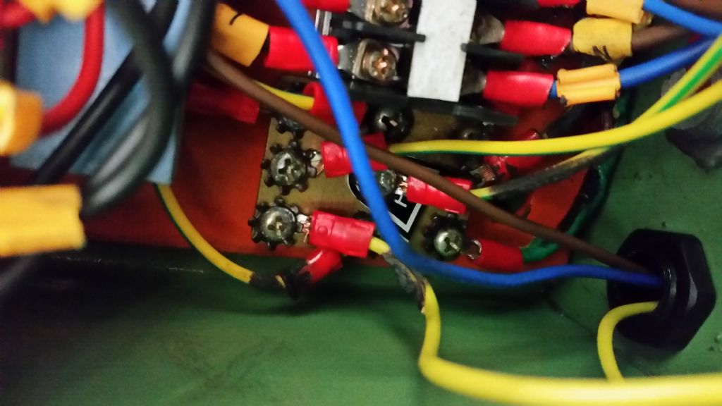

        #294938
        Antony Powell
          @antonypowell28169
          Hi Nick
          Nothing hidden or underhand here everything I have posted is fact and can be proven.
          I will post images of the damage that can be seen as soon as i work out how to do it !!
          Whilst taking the photos I did find a loose earth wire but do not know if it was loose prior to the short or not, or if it was the cause or even involved, either way it can't have been in tight or it wouldn't be loose now.
          I am not an Electrician and all the parts mentioned have been condemned by an Electrician who inspected the lathe after the problem as either damaged or not trustworthy for future safe use.
          tony
          Edited By Antony Powell on 25/04/2017 19:52:01

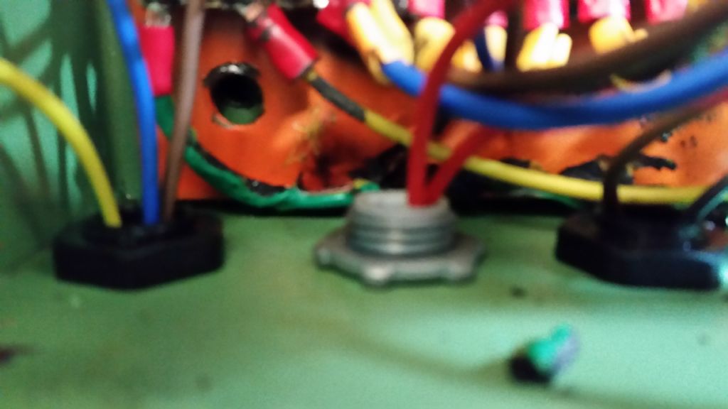

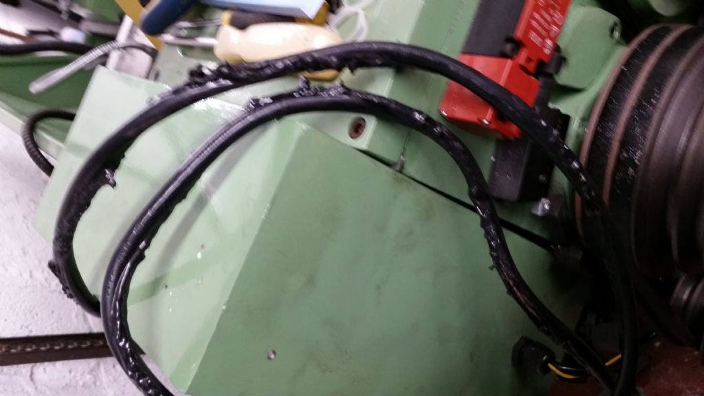

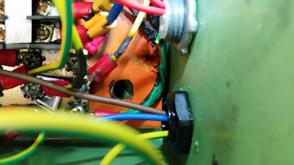

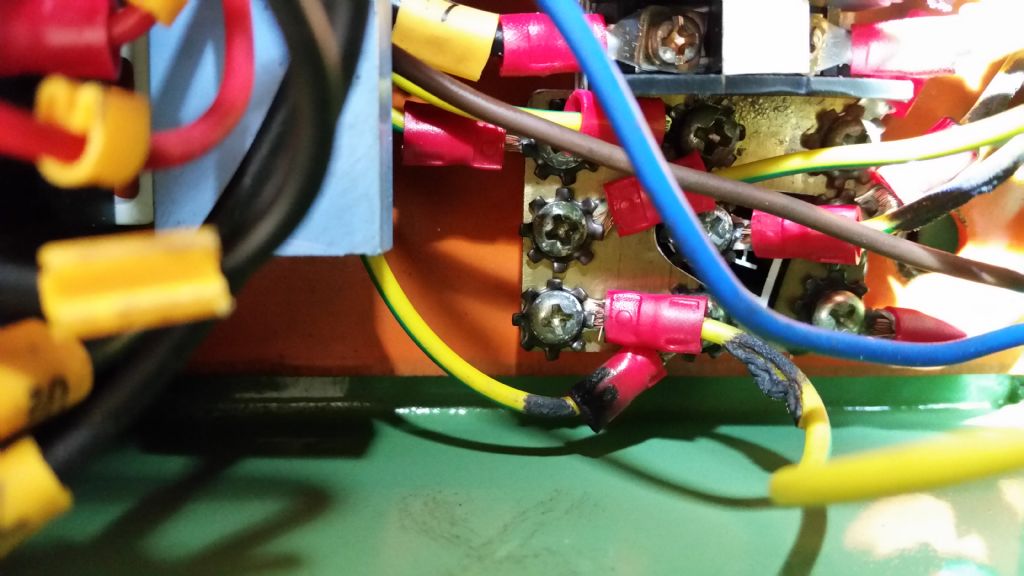

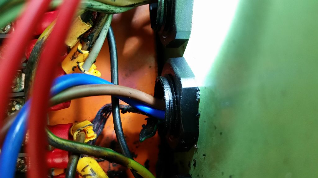

          #294940
          Antony Powell
            @antonypowell28169
            Look closely and you can see black burn marks on most earth wires and in the last picture you can see the extent of the damage to the main power cable.
            please bear in mind I am not a photographer …
            Tony
            Edited By Antony Powell on 25/04/2017 19:48:44

            #294942
              dont know
              There was some enthusiastic support, on another recent thread, for the use of crimp terminals.
              … Whilst I fully accept that DONE PROPERLY they can be excellent: Tony's photos demonstrate just how shabby crimped wiring CAN be.
              Edit: Once upon a Time: http://www.dairiki.org/hammond/cable-lacing-howto/
              Edit: The full document can be viewed here:
              https://babel.hathitrust.org/cgi/pt?id=mdp.39015002052887;view=2up;seq=28;skin=mobile
              Edited By Michael Gilligan on 25/04/2017 20:18:41
              Edited By Michael Gilligan on 25/04/2017 20:24:36

                  #294948
                  Mike Poole
                    @mikepoole82104
                    I remember looking in a Quad amplifier, the wiring was beautifully neat. Having also looked in quite a bit of Japanese big brand gear they take a rather different approach, spaghetti comes to mind, I believe the justification is it reduces pickup but I haven't heard many complaints about Quad's gear.
                    Mike
                    #294950
                      Really interesting photos and many thanks to Antony for publishing them. I'm still baffled : the striking thing is that only the earth wiring is damaged. In best CSI style, and with thanks to Les Jones' who got in first:
                      1. A heavy current passed to earth causing severe damage to the earth wires
                      2. The mains fuse did not blow, nor did anything else protective on the lathe
                      3. Line and Neutral wires appear undamaged.
                      That combination suggests that the source of current was not the lathe itself. If it was the then other wiring should be damaged too. Is it possible that something else earthed through the lathe? Being struck by lightning is my best guess. Any more sensible ideas?

                            #294961
                            Les Jones 1
                              @lesjones1
                              It looks to me like the high fault current passed through the earth wire that comes in through the cable gland in the fifth picture. (Next to last.) I think the burn marks on the other earth wires have been caused by being close to this wire as the marks are only in small patches on these wires. Tony, Is the cable coming through this cable gland the incoming mains ? Or does it go to something else ? (If so what does it go to ?)
                              Les.
