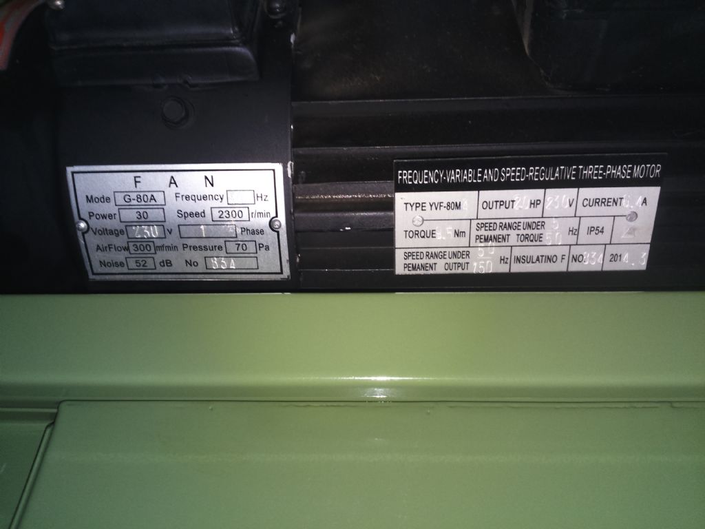

        You were right, it is 3 phase, it's the fan that's single phase.
        They must have decided to run the fan separately to cool the motor better when it is turning slowly.
