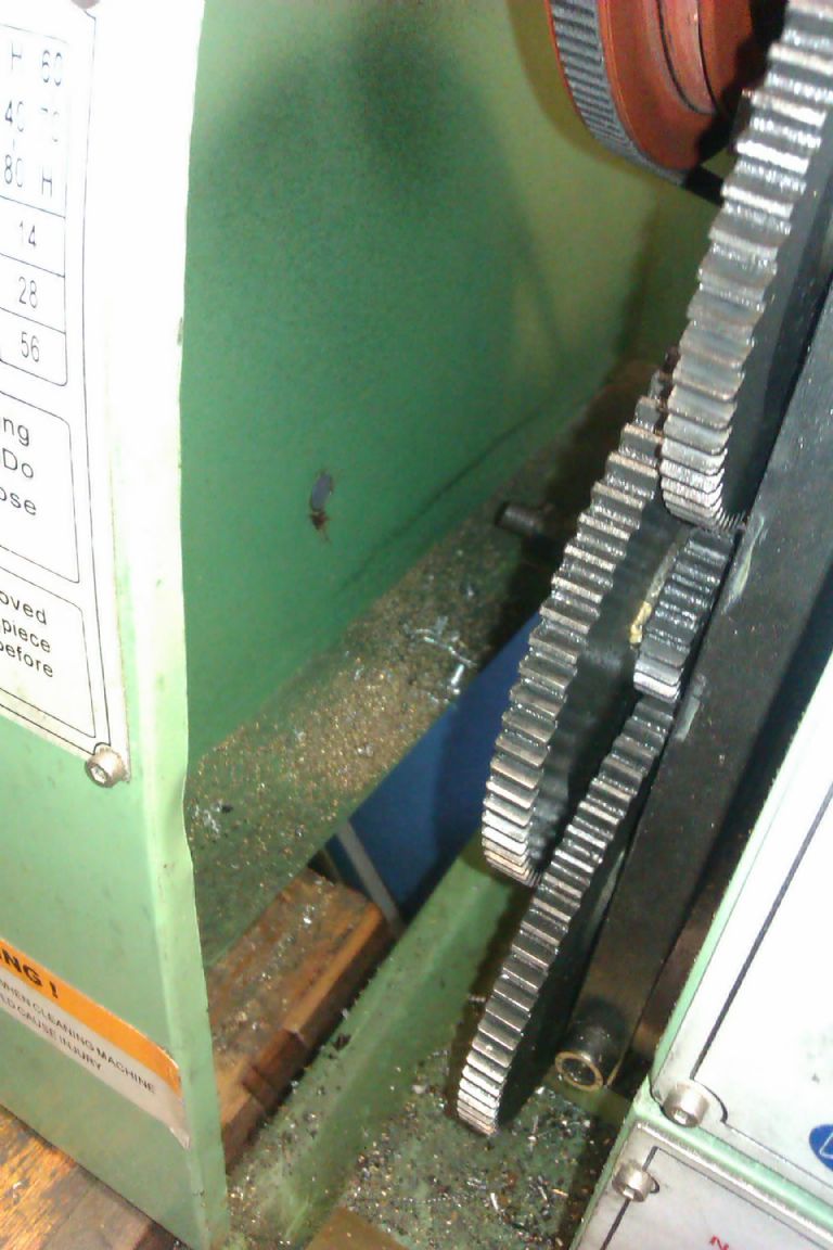

        Well took my cover off and noticed that there is actually a short return to the bottom of the cover, this means you need approx 100mm to the left of the lathe to allow the cover to be removed enough to slide it up. If you wanted to shorten teh studs and put a notch in teh return then this could be reduced to 50mm but you do need room to get yout hand in to unscrew the knobs,
        #111836
        Takeaway
          @takeaway
          Thanks for that Jason, exactly the detail I need to make final decision, very much appreciate your efforts and pics. – Best regards – Stuart
