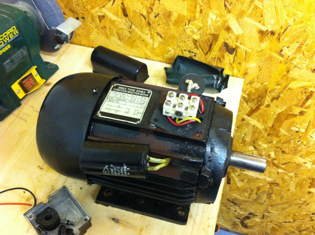

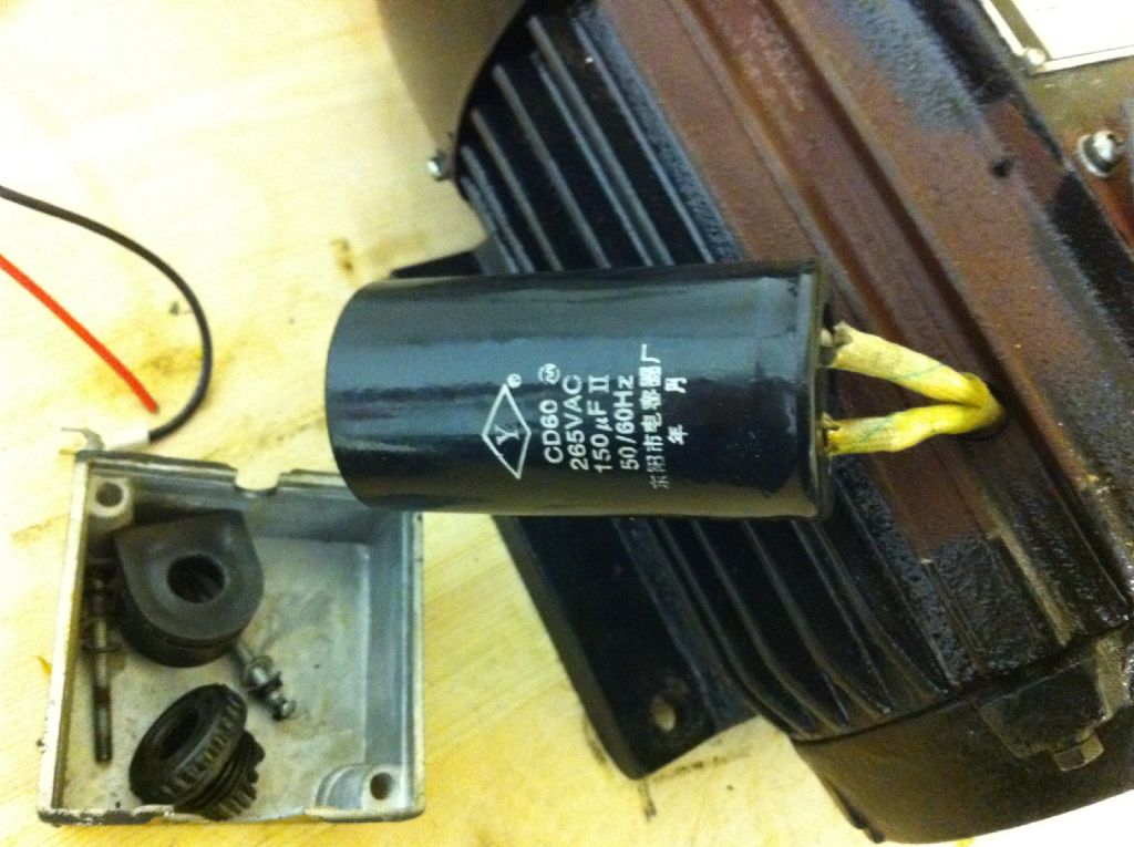

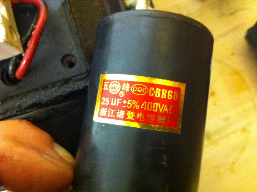

                                      Ok
                                      Just a little more help required.
                                      Think it might be worth changing these capacitors on the motor.  I have pics of the two on the 2hp motor they are the same on the 1.5hp motor.  Could some guide me too the product code of the capacitors from a supplier?  CPC, RS, Farnell?
                                      Thanks,
                                      Ant

                                        Ant,
                                        Your best matches are:-
                                        for 150micro 265Vac  RS 117-221
                                        for 25 micro 400Vac    Rapid Online 10-2952
                                        K

                                          Anthony, Hi,
                                          Checkout this link:- (copy and paste into your browser)
                                          These are  ‘proper’  Run/Start caps they are self healing and have built in safety  in an aluminium case.
                                          They are a bit fiddly to fit but you can CAREFULLY cut the stud off the case to make them fit into the existing box on the motor.
                                          I picked the appropriate ones and replaced them on my mill motor 1.5hp same as yours.
                                          Regards
                                          Deric
                                          #61638
                                          Deric
                                            @deric
                                            Anthony,
                                            I forgot to mention RS have their own equivalent s for these Caps (a bit cheaper) – look over on the right hand side of the screen
                                            Regards
                                            Deric
                                            #61656
                                            Anthony Salisbury
                                              @anthonysalisbury72898
                                              Deric,
                                              Just to make sure I understand correctly I need to buy:-
                                              1 x RS 377-8829 for 25 micro 500Vac  (will this be ok because I only need it for 400Vac?)
                                              1 x RS 117-221 for 150micro 265Vac
                                              Also when you rewired the unit did you go into the motor or just use the cables of the other capacitors?
                                              Thanks,
                                              Ant
                                              #61730
                                              KWIL
                                                @kwil
                                                If the cables are in a good state you can attach the new caps to the old wiring, it is the easiest to do, insulate the connections to prevent contact with the covers.
                                                #61743
                                                Deric
                                                  @deric
                                                  Anthony, Hi,
                                                  Sorry for delay in replying – I am laid low by the ‘lurgy’ at the moment
                                                  If you are careful you can use the existing cables – don’t open the motors!
                                                  I cut the wires off as close as I could to the tags on the caps then crimped on new 1/4″ shrouded lucar terminals available at local motor factors, which gave me enough length to get the caps in position and the box lid back on. If not you will have to get the ssoledring iron out and very carefully lengthen and insulate the extended cables.
                                                  KWIL’s selection for the Start cap is good and my selection for the Run cap is also OK.
                                                  You can open account with RS online and purchase there and then.

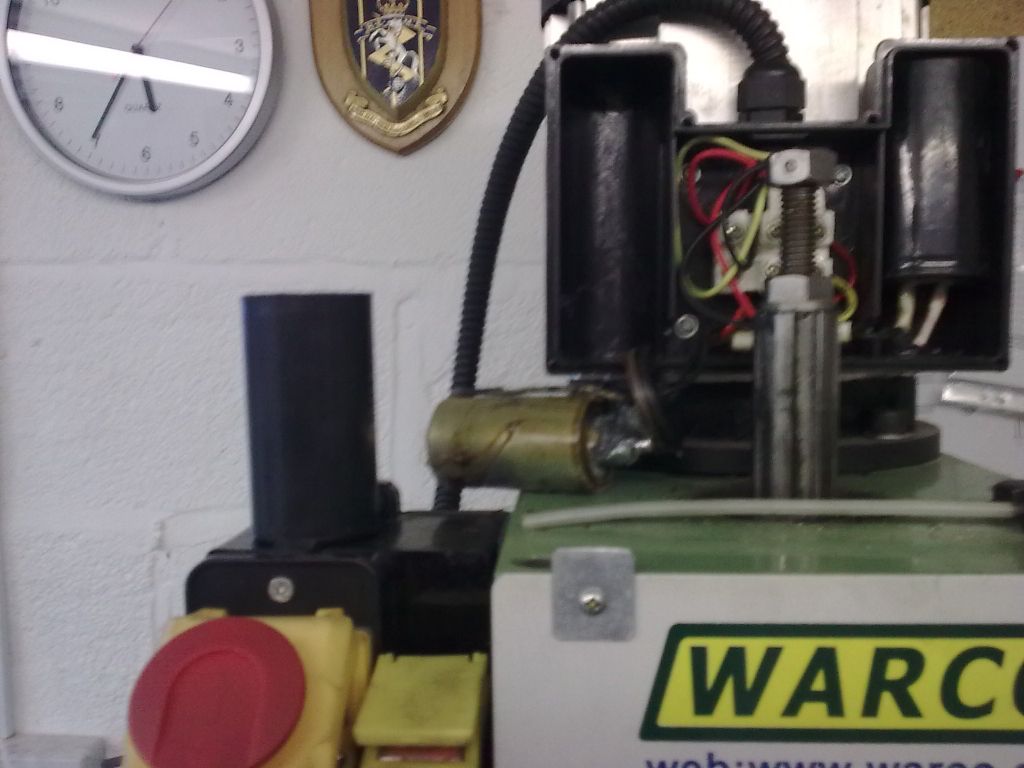

                                                  If you decide to fit the 1.5hp motor to the lathe you must fit the motor overload from the mill. If I remember right you said the Lathe motor is 2hp? therefore the overloads on the lathe will/should be set slightly high for the 1.5hp motor.
                                                  Just for interest:-
                                                   And
                                                  Not as good as they could be – taken with my old phone!
                                                  Regards
                                                  Deric
