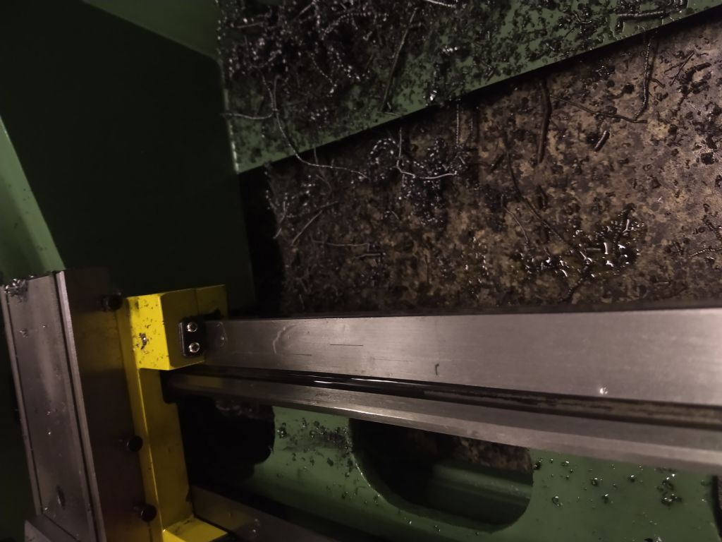

      Hi all, I'm looking for some advise.
      I purchased a WM250V lathe from Warco back in December. It hasn't had as much use as I'd like since then, but I've used it a bit. I noticed some deep scratches on the rearmost flat bedway, and on further inspection found that the nut on the cross slide screw had split and a large chunk fallen down on onto the bed way inside the saddle. This was then occasionally getting jammed as the saddle was moved and causing deep scratches. Warco were very good and sent me a complete cross slide screw and nut, no questions asked. It's left me with some deep scratches which I had to run a stone over to take the sharp edges off, but since then I've noticed that rearmost bedway in particular also seems to have lots of very tiny little scratches or pits, it's hard to describe. I could be being pedantic and making a fuss over nothing, but I wondered could get swarf get stuck under the saddle and get slid up and down the bed, or are the tolerances too fine for swarf to get in there?
      I keep the entire bed well covered in slideway oil, mainly for rust prevention, but is that the right thing to do, or should the bed ways be dry, with only the oiling points on the saddle oiled? I've noticed that swarf seems to stick to the bed when it's very oily in a way that I haven't noticed on any youtube machining videos. Could that be part of the problem, swarf sticking to the oily bed and then getting ground into the bed as it's pushed up and down by the saddle?
      I'm grateful for any advice.

              More oil the better and an induction hardened bed shouldn’t get damaged like that.

                      Much depends on where the damage is. Under the chuck and at the extreme tail-stock end it won't matter at all. Might matter under the sliding surfaces. However, these lathes have prismatic beds in which quite large areas are never touched. The non-bearing areas of the bed can be mauled horribly without affecting the lathe at all. Even moderately scratched slides are unlikely to reduce accuracy, because the bearing area is large compared with the scratch.
                      Scratches and swarf aren't to be encouraged because they speed up wear and tear, and that eventually causes the bed to lose accuracy. Takes a lot of work to wear out a lathe bed, but many end up scrap because wear is often concentrated close to the chuck where most work is done. How prone a lathe is to bed wear depends on how it's used, what the bed is made of, and the design of the bed. All things being equal an induction hardened prismatic bed that's kept clean will last longer than a neglected flat bed. A lathe that cuts metal all day long needs more TLC than one that does half-an-hour every alternate Sunday.
                      I oil my bed as an anti-rust measure, but it's more important to remove swarf and protect it from abrasives. Best done at the end of each session. All oils tend to catch swarf, so wipe all the surfaces and re-oil. Slideway oil is good because it sticks where it needs to be under the slides, but it too should be cleaned off and replaced after a few hours cutting, more often if the job is dirty.
                      The saddle probably has small factory fitted brushes to stop swarf getting underneath. They work moderately well, but clean underneath occasionally.
                      Beds can look badly knocked about but still perform well. It's deep wear that matters, not superficial damage at the surface. Many a second-hand lathe has been bought because it has a shiny flat bed, the new owner blissfully unaware the flash good looks were achieved by aggressive abrasion. Grinding out cosmetic damage like scratches and rust pits causes severe wear to the bed, and it's unlikely to be flat after Bodger Bill has 'fixed' it.
                      My advice, don't worry about looks, what matters is how well the machine cuts metal. If it fails to cut with reasonable success, something is wrong. Might be due to a scratched bed, far more likely it's something else like loose gibs, difficult material or operator error. Most of the trouble in my workshop is operator error.

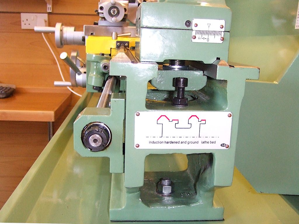

                        The bed on these lathes is advertised and sold as 'hardened' so possibly this missed the hardening process. A discussion with Warco perhaps.
                        I am not sure exactly how hard it is and have no idea how you might test this. I might though have expected it to have put up a little more resistance to scratching than it has done so far.
                        #637649
                          Posted by Journeyman on 14/03/2023 11:47:01:
                          There's no specification, so I understand the notice to mean only that: 'this bed is somewhat harder than it would have been had we not bothered'.
                          I have a Warco lathe claiming an Induction hardened bed, and it's noticeably harder that my untreated Warco mill-table, which is rather soft. The lathe bed isn't hard in the sense a file bounces off!
                          Only way to find out what's what is with a hardness tester. Does a ding put into an unhardened part of the lathe bed go deeper than the same ding put into a red section?
                          I don't worry about it. Although neither are perfect, the mill and lathe both do what I want of them.

                                img_20230314_222254926.jpgThanks for all that info, I appreciate the responses. I do always clean down the ways after using the lathe, but unless I cleaned it constantly while working, I'd never keep swarf from sliding along the bed. I may look at one of those concertina covers to catch the worst of the swarf, but it's good to know that I'm not doing anything wrong anyway.
                                I've attached some photos, it's hard to see what I'm talking about, you can only just see the worst scratches in the photos.

                                  Just as a random update, I dropped the chuck key yesterday evening, and it left a small dent in the bed, so it really doesn't seem to be very hard at all. I'd be curious to check it with a hardness tester someday, although I'm sure it will be fine, I'll just have to look after it and be more careful!

                                    I think the key takeaway is that “Induction Hardened” as a claim made without further description is almost meaningless … perhaps as informative as “Washed” might be !

                                      I would contact Warco, the bed in my opinion has missed a process in the manufacturer. My 920 lathe is about 7 years old ,it's been well used and the bed has a polished sheen on the most used parts of the bed . I've dropped chuck keys and other stuff on the bed by mistake over the year's but no marks. I'm not sure but older Myford lathes were not hardened, but I could be wrong.

                                                  When I bought my Warco 290V this ‘induction hardened bed’ issue did trouble me as I thought it was just shall we say, ‘not true’. Although my lathe has been OK over the last 3 years this thread reignited my curiosity and I had a further look at the bed, there is absolutely no sign of an induction hardening process being applied, no sign of heat discolouration even on the bed end where it hasn’t been ground and parts of the supposedly hardened bed are as soft as the unhardened parts. From nearly fifty years experience in engineering including performing hardening/induction hardening processes my conclusion is that my lathe bed has not been induction hardened at all. Disappointing I know but I’m not surprised at all.
                                                  Tony

                                                      I have a Chester Conquest 7 x 13" mini lathe that has the "hardened bed" sticker on the end of the bed, I also have a set of Tsubosan hardenss testing files – 6 files of varying hardness that are used to test surfaces for hardness between HRC40 and HRC65. If the file is softer than the surface, it doesn't "bite" and skates off without marking the surface. Working up through the files until one does mark the surface gives an indication of how hard it is.
                                                      On one of the vee surfaces on the lathe bed shown on the sticker as hardened, the HRC40 file easily marks the surface, suggesting it is less than HRC40. Not really that hard. Whether or not it is harder than any unhardened areas I don't have the facility to check.
                                                      How big a deal is a soft bed on a light hobby lathe ? Probably not much. Do you use it hard and often enough to risk localised wear (usually near the headstock) ?
