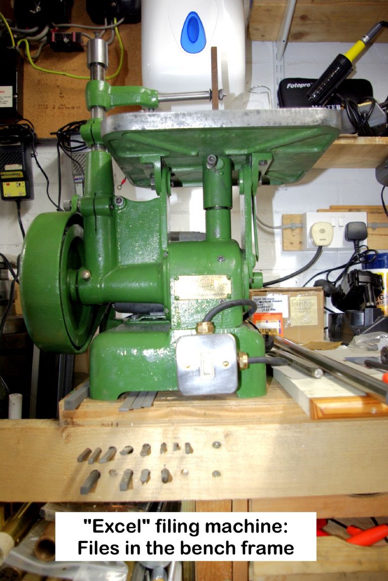

                              Excel Filing Machine
                              Mixed by my local builders supply outlet.
                              Used a part off of my BH600G for them to scan.
                              Geoff – Somewhat cooler thank goodness

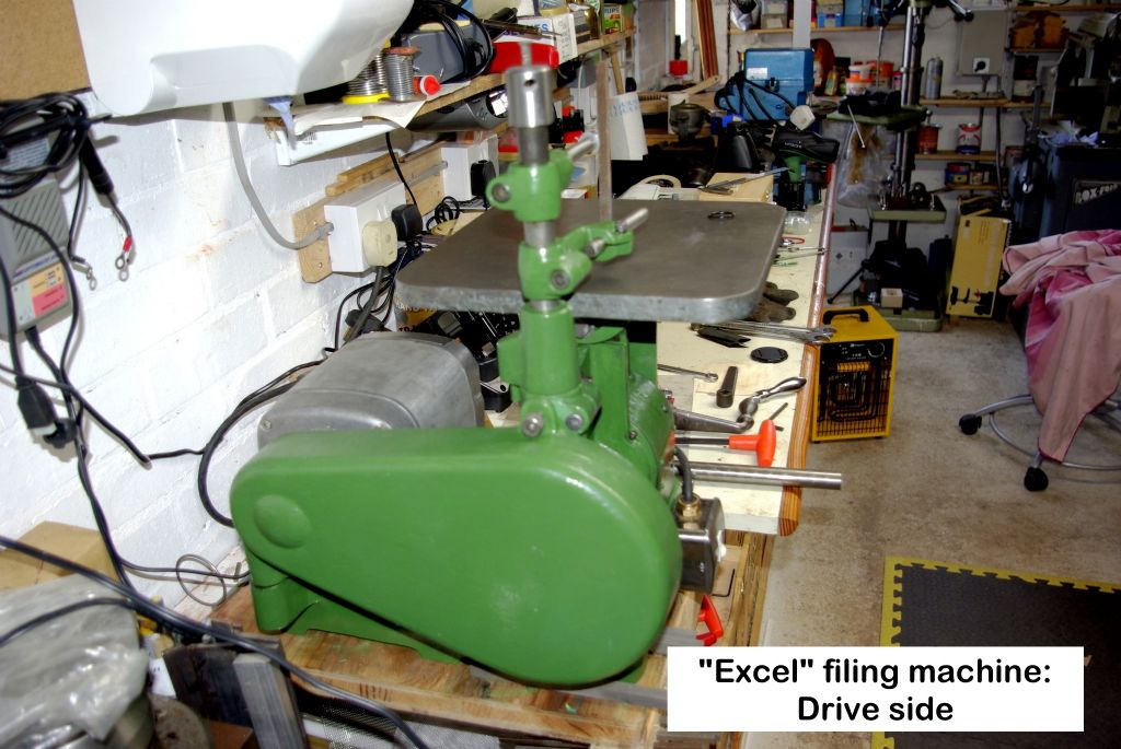

                                    Excel Filing MachineExcel Filing Machine
                                    Very pleased how it turned out as it looked a wreck when received.
                                    Works a treat.
                                    Full set of photos of it totally stripped down in my Album.
