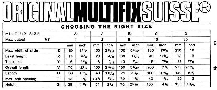

                                              Hoping someone can help me out.
                                              I have a GH600 on order from Warco, should be here end of November apparently. I'm looking to order a Multifix QCTP probably from Create as they seem to get good feedback. I'd like to get one ordered and need to work out the correct size…
                                              I need the following info please:
                                              1) How many millimeters is the distance between the surface of the top compound slide and the middle of the chuck?
                                              2) How wide is the top compound slide?
                                              Thanks in advance

                                              BC Prof
                                                @bcprof
                                                Hi Steve
                                                Distance from top of compound slide to c/l of chuck is 23mm
                                                Compound slide is 80mm wide ,
                                                PM me if you want any more info .
