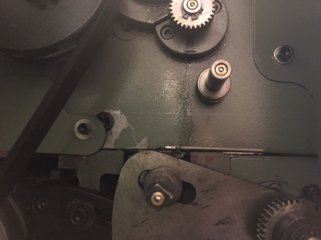

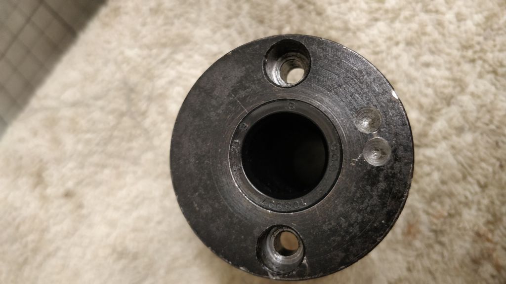

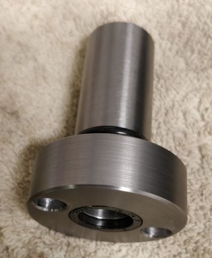

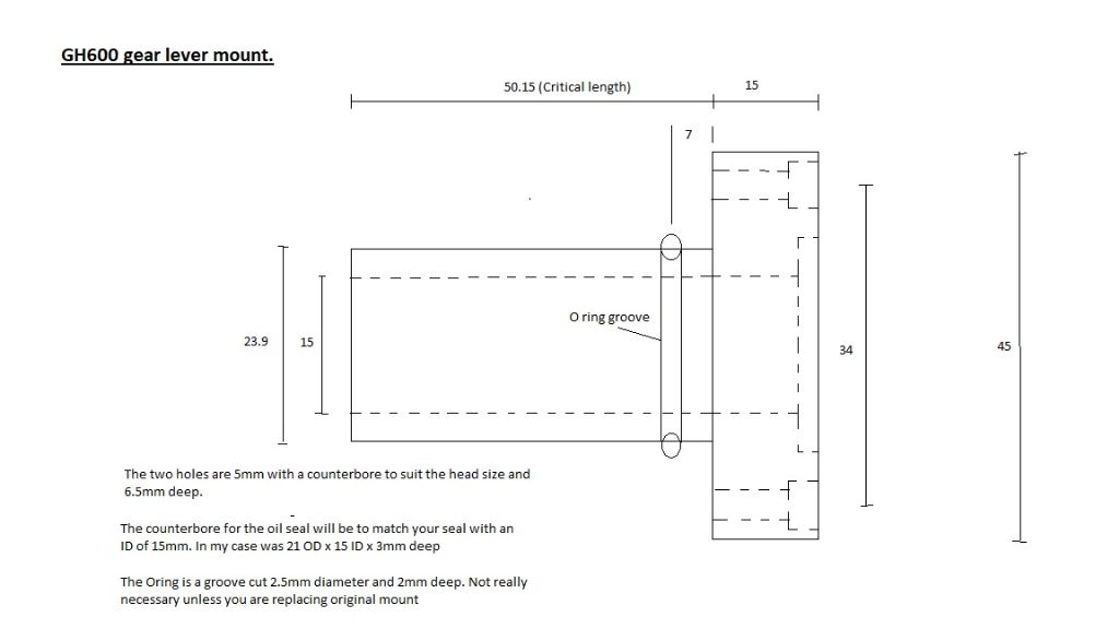

            GH600 Lathe Oil Leak Repair
            After my previous rambles about oil leaks, I finally completed the detection, thought process and solution for this, the largest of the leaks.
            I have produced a PDF document explaining the process I used to sort out this oil leak. I tried to attach it here but I couldn't figure out if you could or couldn't add attachments.
            If anyone is interested, I can email it to you and if you decide you want to go ahead, I can post the replacement lever mount that needs fitting to allow you to modify your unit, as a loan unit while you machine yours.
            All of this took many hours and became a project that I / we shouldn't have to do but there you go!
            Hopefully, these steps will provide help to someone that identifies the same issue on their machine.
            The O ring prevents a bit of the leakage but most of the oil was coming out of the lever hence the oil seal.
            All the dimensions are in the PDF.
            Note:- The O ring is a 2.5mm cross section 19mm ID (Slightly stretched) and the front Oil seal is 21mm OD x 15mm ID x 3mm thick.
            Best regards and good luck. Triumphboy. J

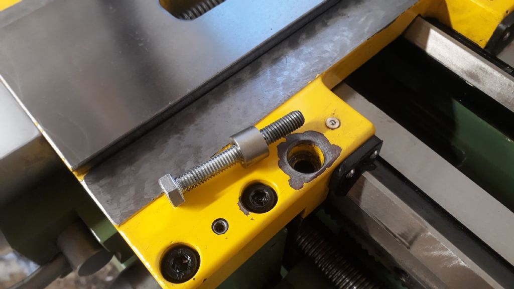

                      Has anyone modified their GH600 to lock the cross-slide yet?

                        I have been looking through Grizzly lathe manuals seeking better instructions than the Warco manual and came across a cross slide lock screw on a similar looking setup. It is the usual format of gib strip lock screw.
                        cross slide lock example
                        I have had my GH600 two months now and still have a few teething issues to get through as i haven't had much time to fiddle yet.

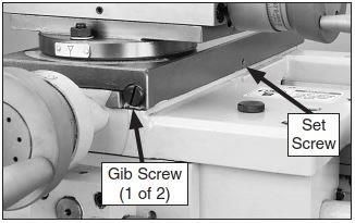

                        I have reset all of the gib strip, i would say that i have the top slide too tight, the cross slide perfect and maybe an issue with the saddle.
                        I have set the gib strip at the rear of the saddle and snugged it up quite a bit from the factory setting. I tested with a DTI on the top of the saddle to see if there was any lift and measured 0.01mm. Should i attempt to tighten this gib further?
                        If i move the DTI and test the saddle at the front i can measure 0.025mm of lift but don't see anyway to adjust this? Here is a diagram, it would be parts 45 and 46 that would need to be adjusted. Is this normal?
                        saddle diagram
                        My other thought was spindle preload so with a DTI on the top of the register flange and a large drill for leverage I measured 0.01mm of lift. I could equally measure a further 0.01mm in the downwards direction from neutral so i'm not sure if it is deflection rather than bearing clearance. Again does this sound OK or is the movement excessive? I didn't expect any movement so close to the bearing.
                        Any advice on what to try next or where I'm going wrong would be appreciated.

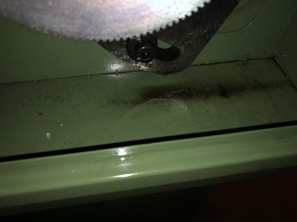

                                      On to my next problem – oil leak from the spindle. Just looking for opinions really, am I being fussy or is this just too bad. For me the fact that the oil can and does get onto the belts really dictates that I need it fixed. Other than the belts it doesn’t bother me as it drips onto the tray and hasn’t been enough to justify a top up. Thinking negatively though it’s likely to get worse. Haven’t noticed any other leaks but this one is possibly all of the gearbox shafts, quite hard to tell but definitely at least the main spindle.
                                          kind regards
                                          Dan
                                          Hello Dan
                                          I am dealing with an oil leak here too. Along with one from the saddle spindle which I have machined another oil seal just today as it happens. See my other post in this article about an oil leak from the front of the machine. It's a similar way of dealing with it.
                                          The one you are referring to is a bit difficult to solve because, at the moment, I can see no way to stop it with any degree of professionalism, so to speak. At this time, I have got a series of O rings filling in the gap behind the gear wheel. 3 of them to be exact. I'm hoping that will work but it's a shonky fix to be honest.
                                          Still trying to think of a way to do a better job of it.

                                            I read your post about the saddle fix. Luckily mine doesn't leak here yet but i will refer back to your fix if it does. The spindle is definitely the number 1 oil leak issue.
                                            Have you dismantled your spindle and tried a replacement seal? I assumed it would be a lip seal fitted behind the cover but don't fancy taking it apart to look. Have you approached Warco about it?

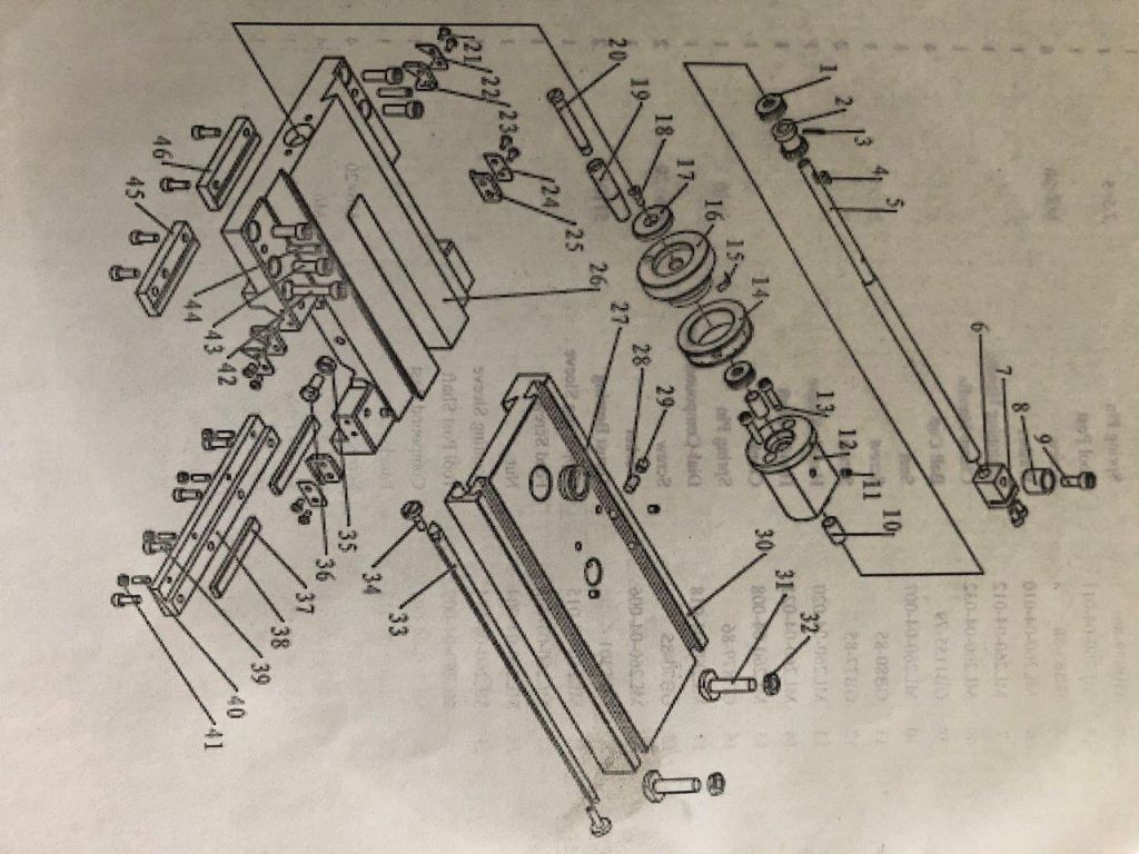

                                                  Apologies, I may have the terminology wrong here, but I'll do my best The GH600 has a single powered shaft / leadscrew. For threading, the half-nut engages with the thread on the leadscrew to drive the carriage. For power-feed, there is a long slot milled in the lead-screw, which a key engages with.
                                                  The apron is easy to remove – I had to tackle that when fixing the saddle lock. From memory there are 4 bolts that go through the the top of the apron – remove those (and have some support underneath the apron so it doesn't drop on the floor) and you're done.
                                                  edit : this photo shows two of the blots. The top right of the three bolts (removed in this photo) is for the saddle lock. The other two secure the apron. There are a matching pair on the other end.
                                                  Jed

                                                      Dan
                                                      Hello Dan
                                                      There appears to no seals anywhere on the gearbox or the saddle so it's been leaking from at least tree places so far. The shafts would appear to be the only thing going through the casing. No lip seals!
                                                      I've just machined the part on the saddle block and fitted a seal last week. The part machined was the silver cast iron round piece behind the handle mounted on with 3 screws. I clocked the hole before cutting the seal and found it was out by about 12 thou so used shims in the chuck to keep it concentric.
                                                      The one you are referring to might be a really tricky fix. It's a bit annoying in a way because it would cost pennies to make a proper seal during manufacture and make the machine a better quality product.
                                                      If your feedshaft direction changer leaks behind the front panel ( The top silver knob) I made a document about doing the fix. I can email it to you if you want to look at it. I've no doubt it will leak from there too at some point. A small amount of oil leaking wouldn't be a problem but in my case, it was excessive so I had to do something about it. I wrote about it earlier on in this thread.
