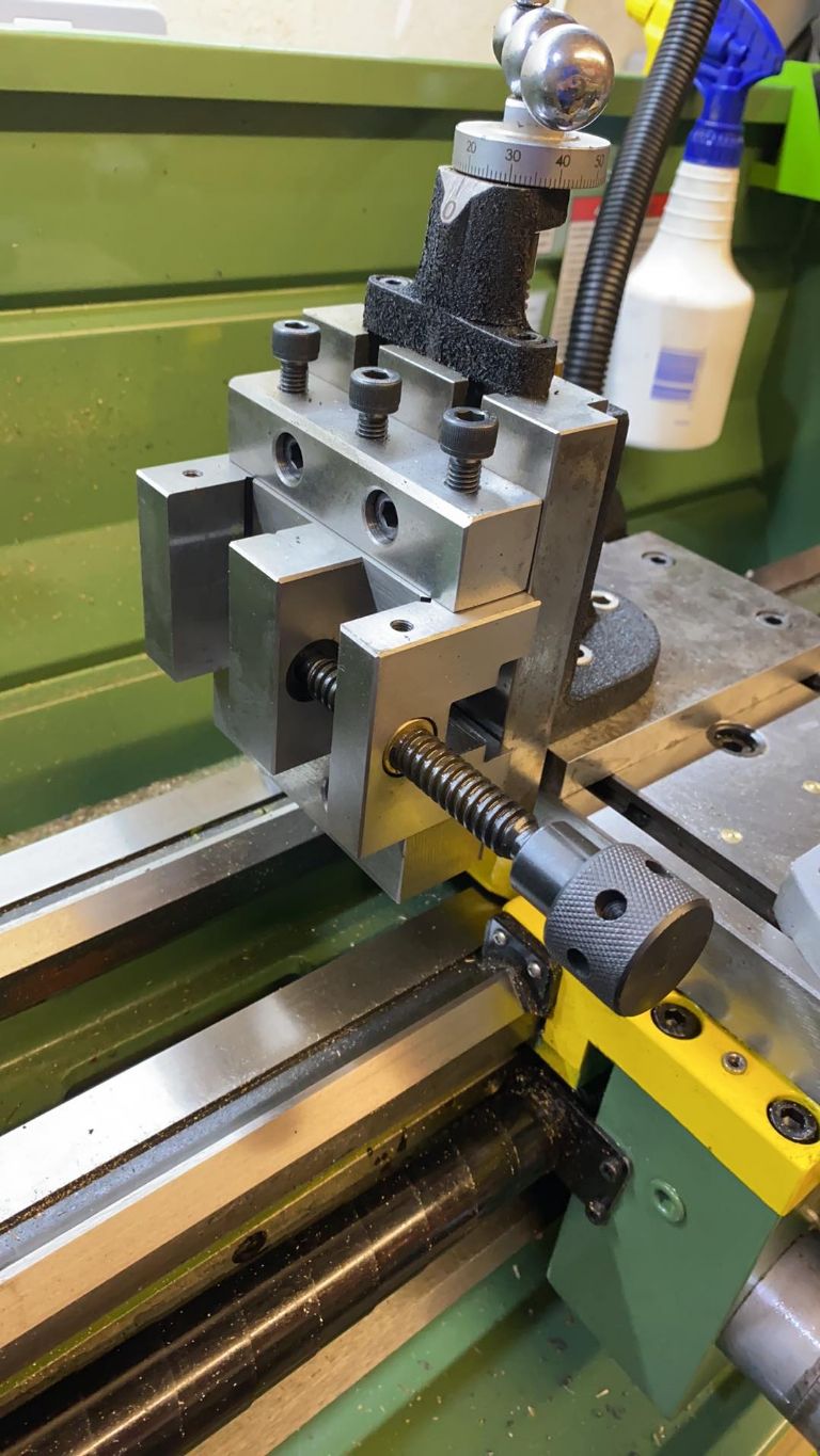

      Thanks for the post of the tool post! angel
      I see you fitted a GIB (I think it's called) type rather than a piston lock.
      What size did you use please? I don't want to screw up and order the wrong thing and have to return it.
      Nice work with the spindle.
      Thanks in advance.
      #450652
      Warren Wakeling
        @warrenwakeling14550
        hi Triumphboy
        no problem heres some links
        **LINK**
        **LINK**
        **LINK**
        and any molel 100 tool holders you wanna use. Im useing the silm!

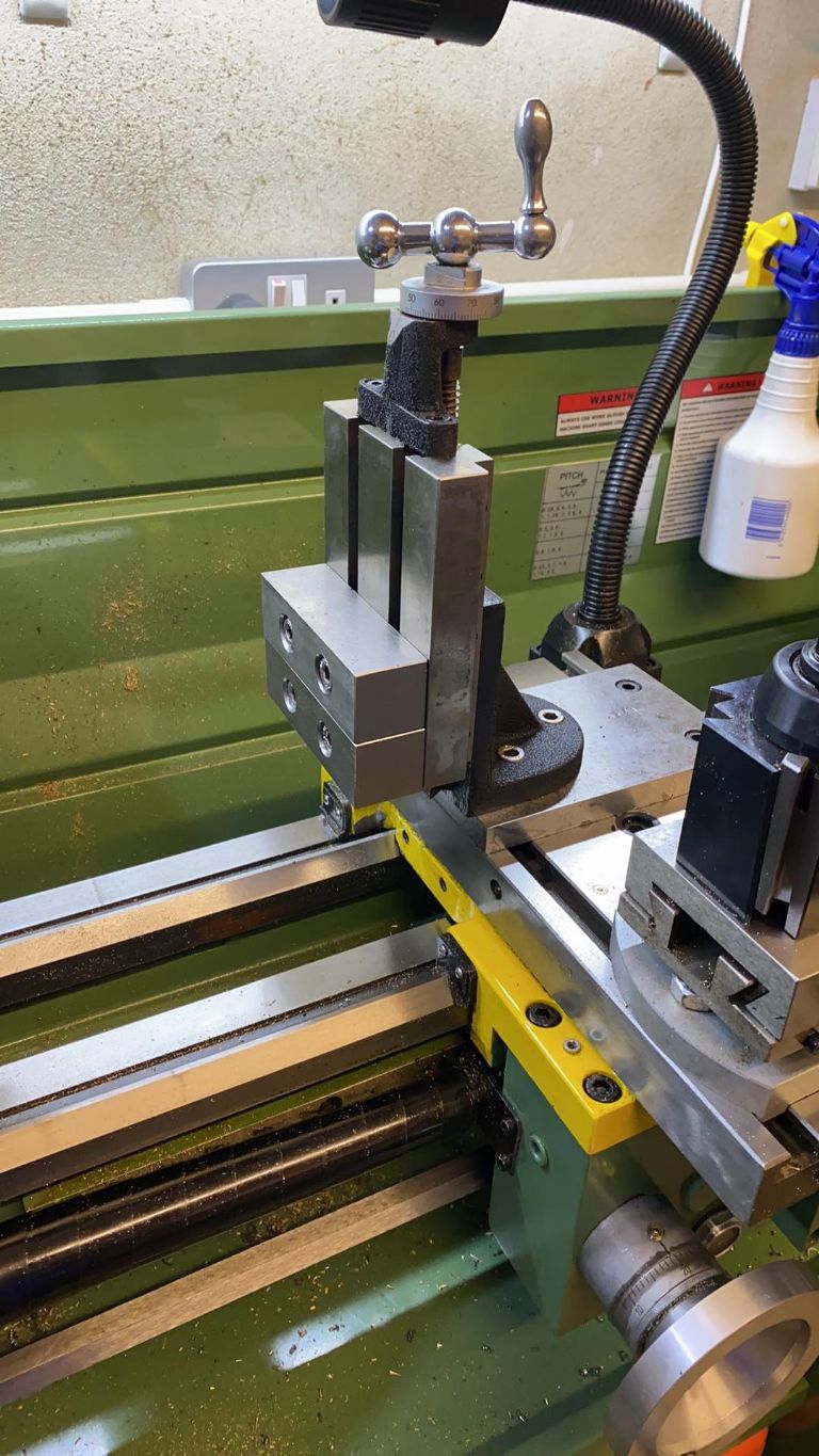

          Hi all added this today

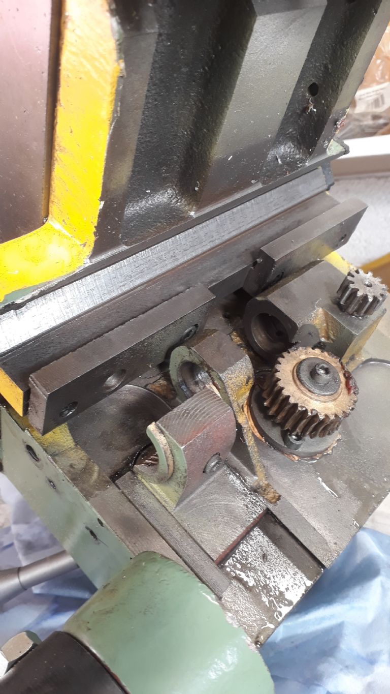

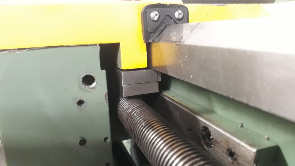

                A wee update, really enjoying the lathe, and still very much on the steep part of the learning curve, but starting to make some useful and accurate (albeit simple) parts.
                However I now have to make my first repair, and I don't think it was my fault…
                I've belatedly discovered what a good idea it is to lock the carriage when parting or making facing cuts, so the locking bolt (discussed earlier in this thread) has been getting a work-out. I noticed that it seemed to lose holding power, and then the cap-head bolt stopped tightening. It looked to have minimum thread engagement, so I replaced it with a longer bolt, which worked for a while, but now it's clear that I've stripped the threads.
                The threads are in a steel plate that sits under the lathe bed, behind the apron, and is pulled up when you tighten the locking bolt. I can see a few ways of fixing and even improving the mechanism, but the big challenge is getting at it. I suspect I might have to remove the lead screw and/or the apron.
                So first question – has anyone modded the locking plate or had it off? Any tips on how to get at it?
                I managed to get a nut between the lead screw and locking plate, run a long bolt down to it, and tighten it all up. The saddle locked up rock solid. So I'm happy that the basic mechanism can work, it just needs some decent threads to you can really tighten it up.

                  Based on my experience with one its belt driven predecessors, some of the capscrews seemed to have been made from a very high grade of plasticine, rather than steel!
                  On that, the saddle lock was a piece of plate, short enough to be removed towards the Tailstock once the clamp bolt had been removed..
                  If you don't fancy making a complete new locking plate, you could either drill and tap it larger, say M12 and then bush it back to original size, locking it with an anaerobic, or Helicoil the stripped hole
                  If you do have to remove the Apron, it is heavy.
                  Following the good advice provided by Geoff Halstead, I lowered it t, using two M8 studs, and nuts. (Find my article in MEW on repairing my smash up, which details the method )
                  I may even be able to find Geoff's instructions. PM me with an E mail address and I can send over a picture of the Apron part way through its descent! The Clamp Plate is visible in the background. Possibly even "lift" some of the words from the article, if you ask nicely, although the picture is pretty self explanatory

                    Hello Jed
                    The easiest way I can see is to use an M8 Helicoil / Recoil repair.
                    It's possible to drill straight down from the top and all the way through with the tapping size drill
                    Drill the clearance size of the OD for the helicoil in the yellow block and fit it from the top.
                    You'd need to make a shoulder bolt, or it may be possible to sleeve the yellow block to reduce it's size again.
                    That is all I can think of after looking at it.
                    As a bonus, I've used recoils to increase the strength of the threads in plastic and other soft materials in the past so it should be more robust.
                    Failing that, a lot of work I think.
                    Best of luck.

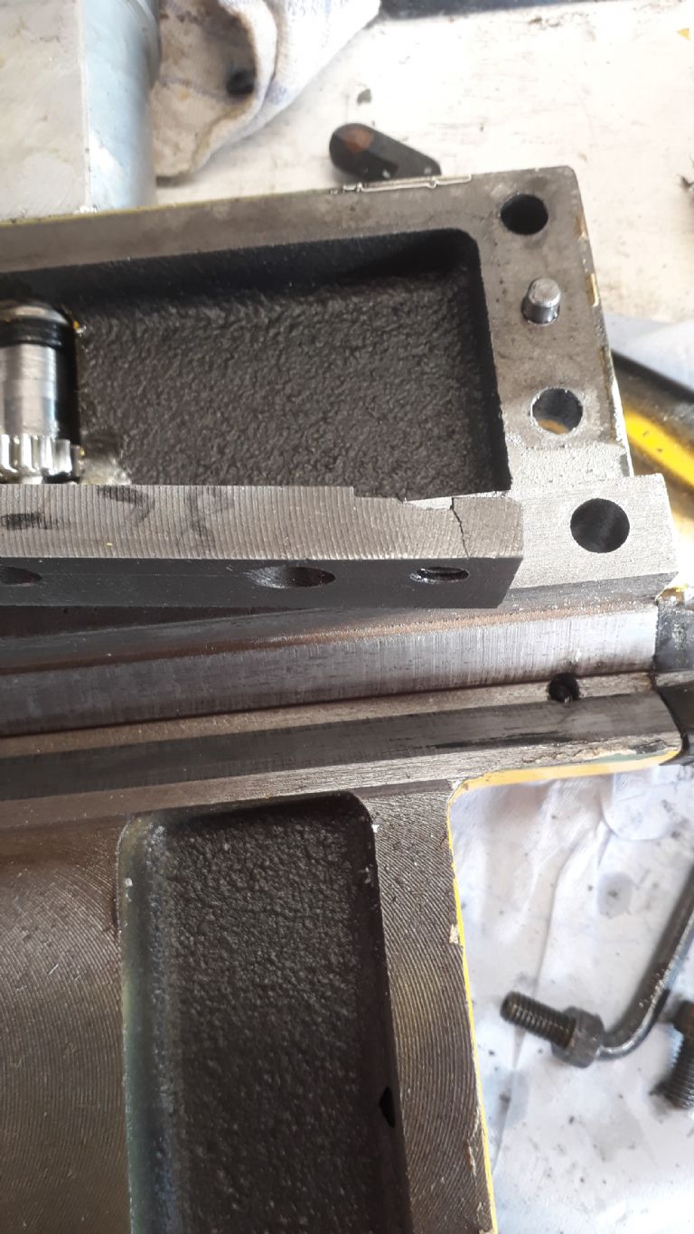

                        So I managed to convince myself that removing the carriage would be easy enough…
                        And it was! Not as heavy as I feared either.
                        That was the good news. Bad news is that I still can't get at the locking plate…
                        One of the fixings is hidden behind a cast-in lug…
                        So nothing for it but to take the apron off. Which is easy enough with the carriage already off the lathe…

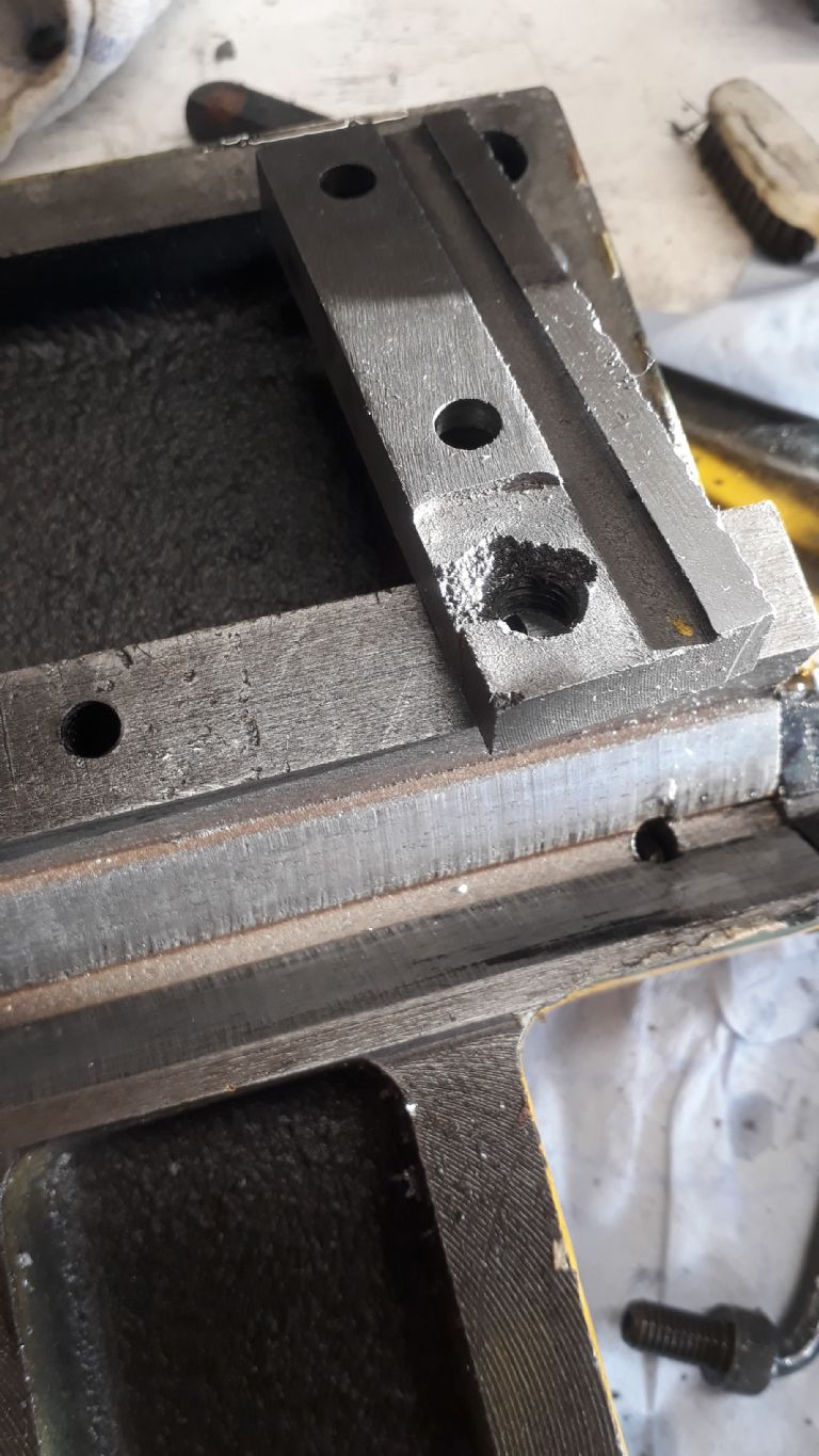

                        So the offending part. Not just a stripped thread, but a chunk of the casting has chipped away…
                        And to complete the picture, it has cracked through…
                        So I'm glad I went to the trouble of removing the carriage and apron to get at the part, as it clearly needs properly repaired or replaced.
                        What to do?
                        * I can ask for replacement part and wait for it to arrive. Will the new one be any better than the old?
                        * Make a new one from scratch. I don't have the cutters to do the counter-sunk cap-head screws. And the mating surface with the under-side of the bed looks to be be ground, so perhaps this needs to be finished beyond what I can manage on the mill.
                        * Repair the part – there is a fair bit of clearance between the underside of the part and the lead screw – enough space to bolt on a chunk of something to give the part rigidity and drill/tap it to provide the locking function…
                        Any thoughts? I think I'm leaning towards repairing it at the moment…

                          A big well done for having a go to remove the carriage and finding the offender.
                          It may just be that it was broken all along hence the reason for the thread failure. Also. Thanks for the pictures! It helps me if I ever have the same problem.
                          As for the cap head countersink, I have done this recently by drilling to the near depth that is required. If you then grind that drill bit of the same size, maybe a worn out one, flat on the grind wheel, It will do the job perfectly well. Probably best to clamp the workpiece before both operations.

                            I would make new out of mild steel flat stock. With regards to counter bored holes pre drill with diameter required.
                            Grind drill with flat bottom then finish pre drilled hole to depth. You could mill a relief on clamp end and fix nylon or brass strip. I ordered the GH600 and its due to be delivered on Monday. I will strip my machine down before using as from your pictures looks like sharp areas everywhere .

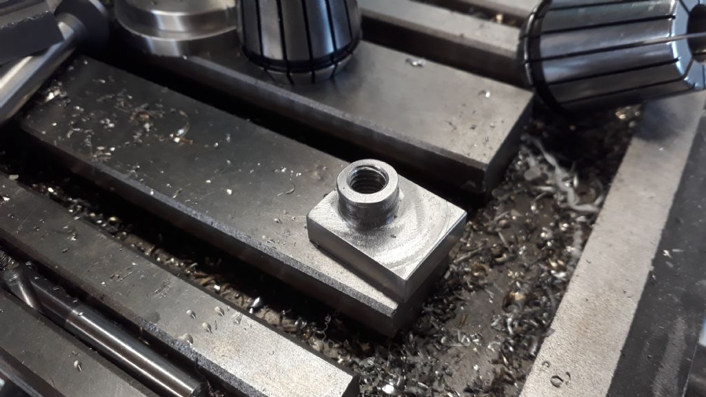

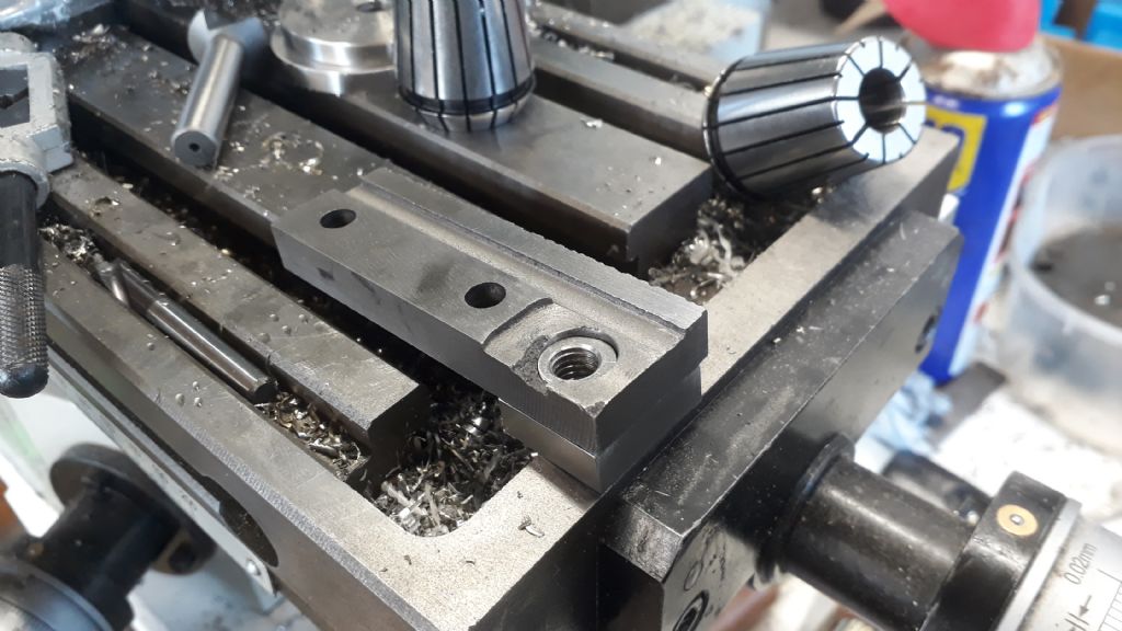

                                TB and Martin – thanks for the suggestion re: drilling the counter-sinks for the cap-head bolts. I think that in retrospect I should have done this (God knows I have enough chewed up drills to grind flat) and made the part from scratch.
                                Sadly patience isn't one of my few virtues. I spent the day going with my first idea…
                                I started with some stainless square stock that was about the right size, and used my rotary table to mill out a 12mm round shoulder. I would have used the lathe for this, but…
                                The shoulder was drilled and tapped to M8 (which I didn't get concentric, as you can see). The setup was a bit shonky, hence the poor finish. And the collets everywhere, and the swath…. it was one of those days…
                                Note to self, when I can't find the spotting drill tomorrow, it's hiding in the t-slot…

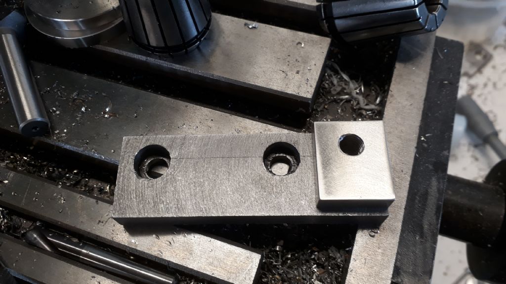

                                As for the original plate, the chewed up M8 hole was drilled out to M12, and the new part inserted…
                                The idea is that the thread engages where it did previously, but there are many more threads than before, and the plate underneath spreads the load, hopefully relieving pressure on the crack. I did manage to get a nice tight fit.
                                The piccy above was before I ran some M3 screws through the part to fix it to the clamping plate. I added loctite for good measure, since I hope never to see this part again. Here it is fitted…
                                It looks close to the lead screw, but there is plenty of clearance.
                                Here's the new "shoulder bolt" for locking…
                                Ok it's just a regular bolt with a bushing, but it works well. It goes from loose to totally locked in less than half a turn, and it's a lot sturdier than the original.
                                There's still a lot of reassembly to do, but I've called it a day and opened a beer. In retrospect…

                                Howard Lewis
                                  @howardlewis46836
                                  Altogether, sounds like the job's a good 'un as JS would say.
                                  You know a lot more about your machine, it less likely to scalp or skin you, and best of all, the lock now works.
                                  So not a day wasted, but one of useful learning, and increased confidence
                                  Sounds like WIN, WIN, WIN. Nothing succeeds like success
