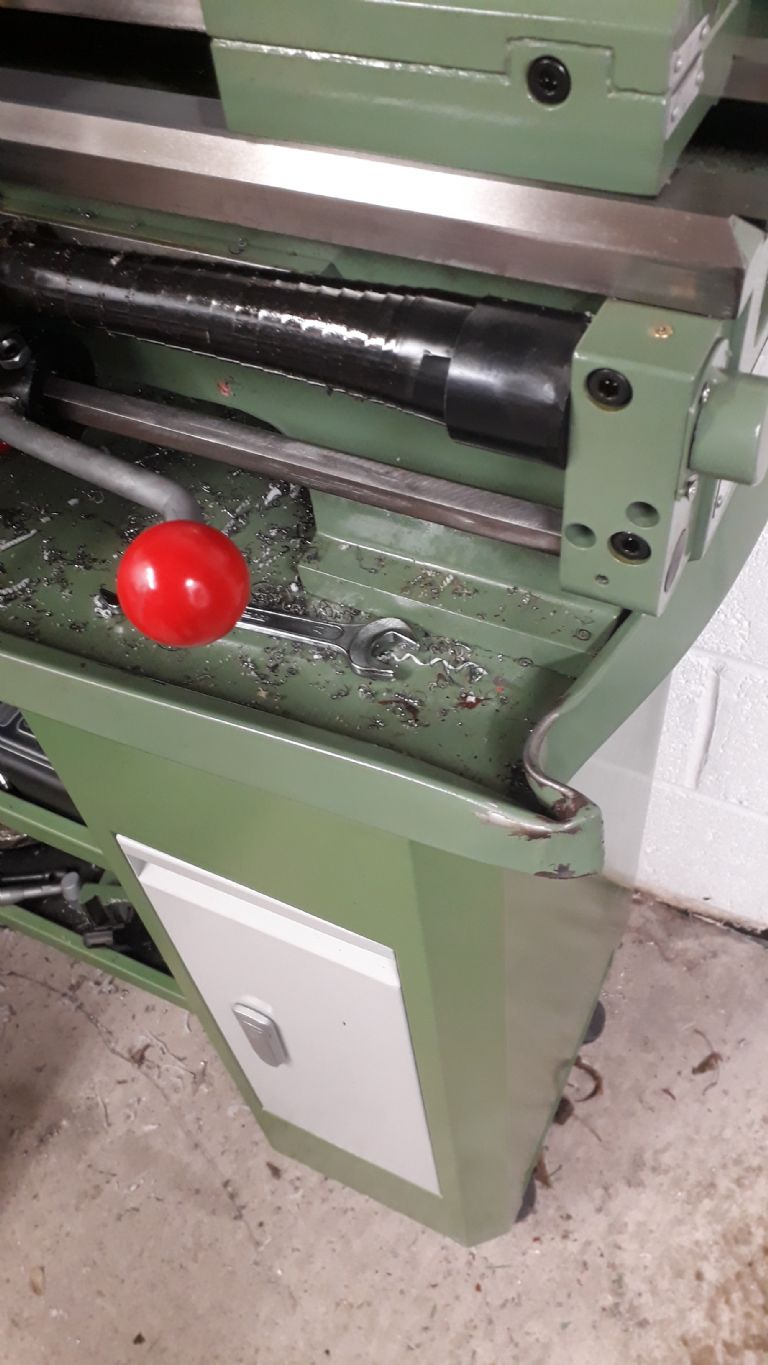

                    In other news, I had my first major oopsie with the lathe. I'm not sure if this a classic beginner's mistake, or my ineptitude is unique, but here's the result…
                    It's just bent sheet metal, that I might just be able to persuade back into shape. Does anyone care to guess how I managed it?

                        While i was typing, it looks like you managed to roll it back on the castors, pretty hard into something with a sharp corner. Do apply the brakes!
                        Seems as if you are going add some sheet metal working skills to your port folio!
                        I can only suggest using a 4lb lump hammer on the inside of the tray, as a starting point to try to return things towards where they started. The outer rim will be last in the queue for panel beating. You may need some bits of sturdy steel to back the sheet metal while you panel beat.
                        Start off with fairly heavy blows, and as the metal approaches the original shape lighten the blows to take out the hammer marks.

                          Good guess, but the lathe is immobile. There was no other object involved, all damage was self inflicted.
                          The metal beating advice is much appreciated, as it's something I've never attempted before. As you say, yet another skill to master

                                Did you start the lathe with the red ball hanging over the end of the splash tray and start power feeding towards the chuck?

                                      Ian wins the prize, that red ball in the middle of the picture is the culprit. I had the carriage close to the tail-stock end of the lathe, turning a piece that was about as long as the lathe can manage. The lever was depressed to start the lathe (with power feed towards the chuck), and since I was watching the work, I didn't notice the ball hooking under the edge of the stand.
                                      @Triumphboy, very grateful for the offer of help, but I'm up in Scotland
                                      @John I think you're right, the top sheet of the stand is lifted a little around the front right corner of the lathe bed, which will likely have an affect on how straight the bed is. The irony is that the work I was turning was supposed to be a test piece to help get things into alignment – I've yet to seriously tackle getting the lathe set up properly. So at least I haven't undone any previous work in that regard. But now I need to do some metal-bashing before I can get back to checking if everything is true.

                                        The red ball on mine is 4" above the tray when the lathe is running.
                                        Have you got something else wrong that allows the lever to drop so low?
                                        #438788
                                        Jed Martens
                                          @jedmartens56976
                                          Yes, the mechanism that attaches the lever to the control shaft is shoogly, and it can be depressed beyond the detent if you're not careful.
                                          I hadn't thought this an issue as the tray itself stops you pushing it too far, but failed to considered the case where the lever is beyond the end of the tray…

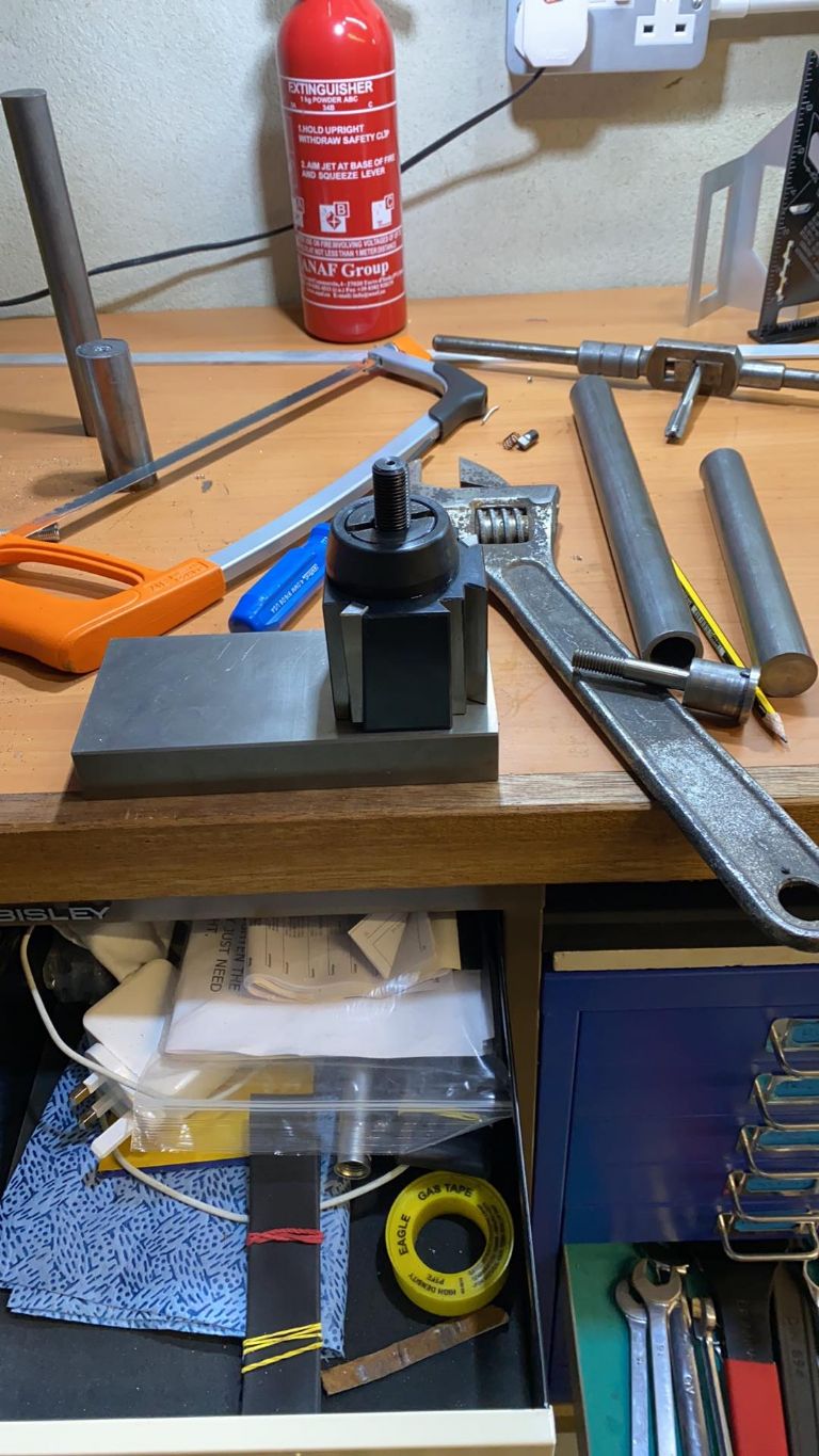

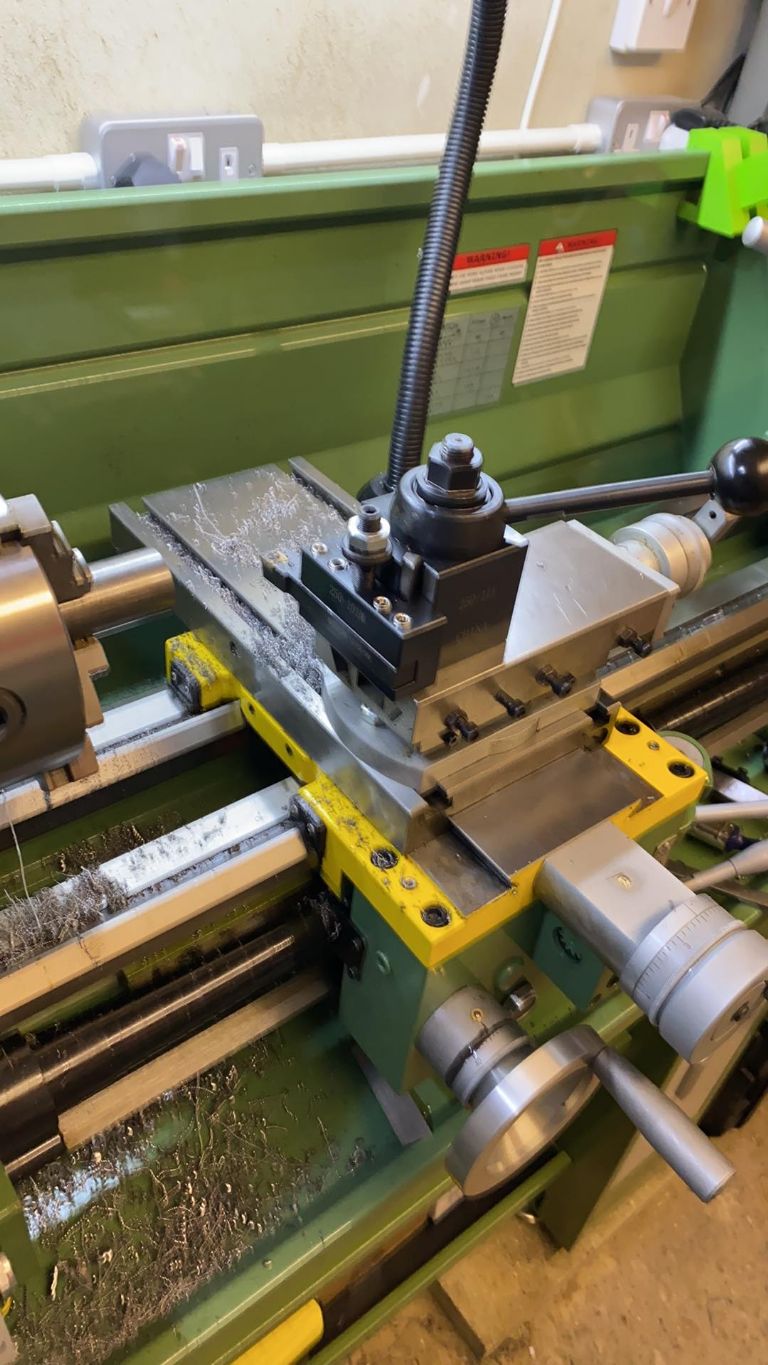

                                            #450143
                                            Warren Wakeling
                                              @warrenwakeling14550
                                              hi guys finally got my gh600
                                              first job changed the tool post to a quick change tool post!
                                              Easier then I thought.
