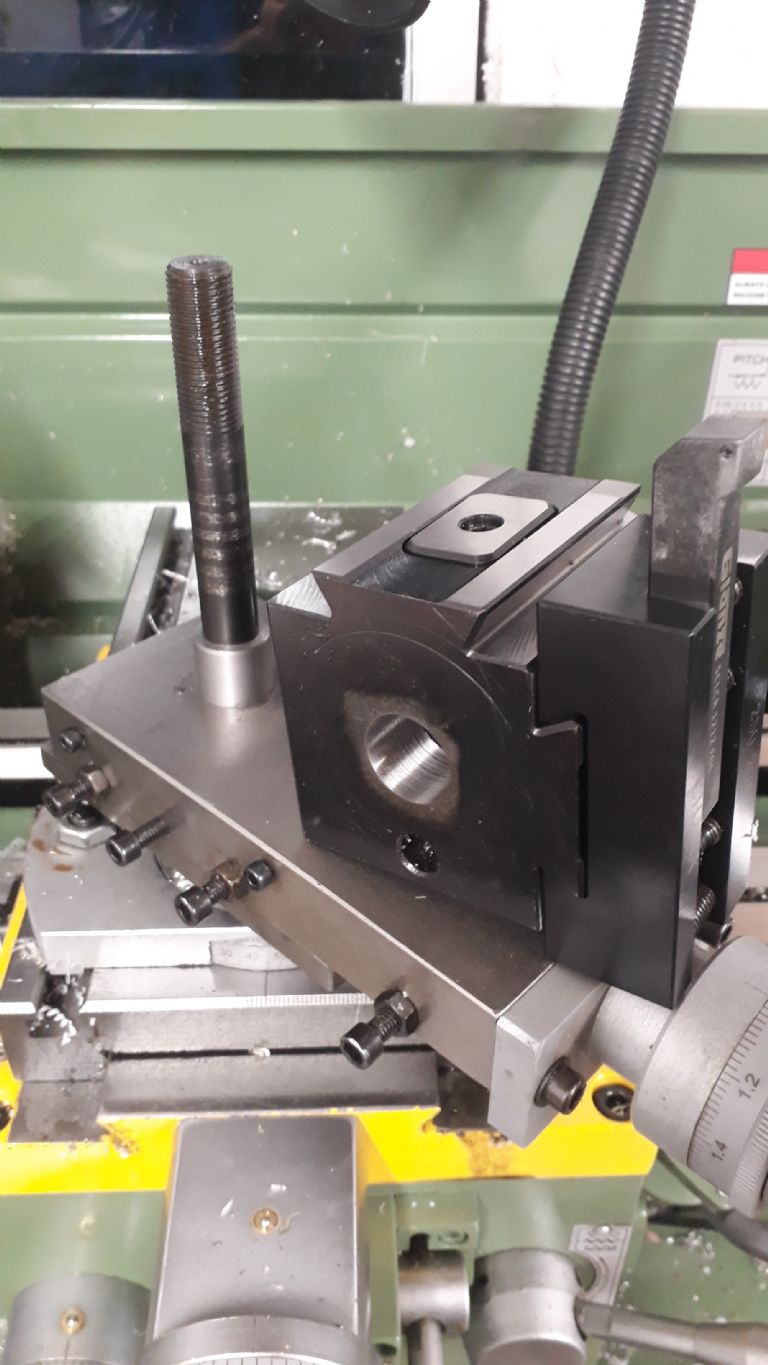

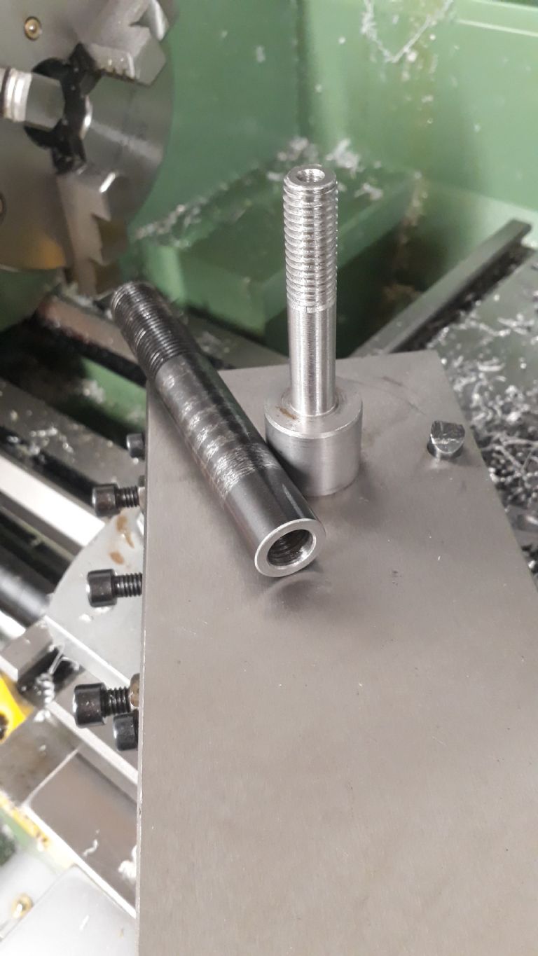

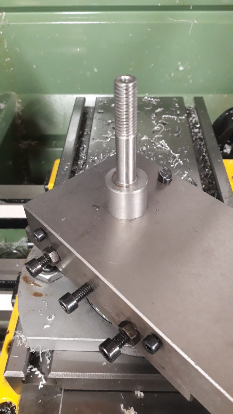

            Here is the GH600 compound – it has a fixing post that is M10, and has a shoulder at the bottom that is wider (22mm from memory)
            The tool-post fixes via a 16mm rod, and it comes with a base-plate that the rod screws into. I believe the idea is to machine the base-plate and slot that into the compound, but my compound has no t-slot…
            So instead I cut the 16mm rod to an appropriate length and drilled a deep hole that was internally threaded M10 at the end….
            This screwed down onto the compound post. Next, I had to bore the base of the tool-post so that it cleared the 22mm shoulder.
            That was no fun at all. My mill was struggling with the cheap boring head and chattering like crazy. I got there in the end, and the surface finish is rubbish, but it's a better fit than the original tool-post holder.

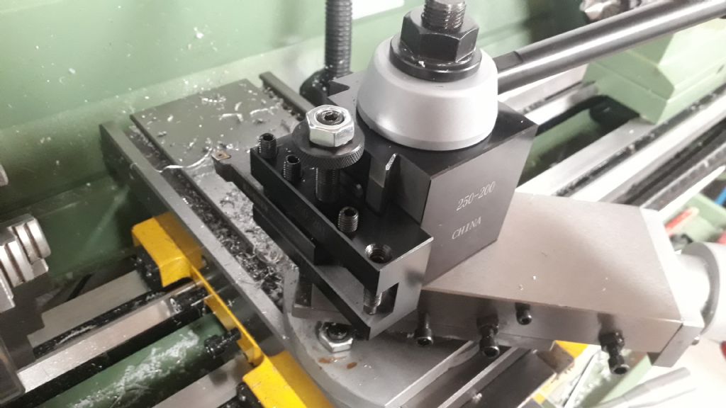

            And here it is fitted…

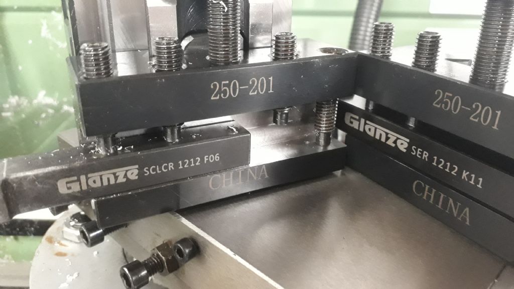

            There was one last problem. Some of my tooling was still above the centre-line, even with the holder at its lowest setting, so I had to mill a few millimetres from the bottom of the holder.
            It all appears to work as expected. My nerves were shot after drilling the rod and boring the tool-post, as it was my first time doing those kind of operations, and any mistake could well be costly. But I am happy with the results.

              If you don't mind me saying so, you have much more than desirable tool protrusion with that setup in the penultimate photograph, and are only clamping the insert holder with two screws, which is because you have to pull the tool holder out to clear the other tool holder dovetail on the tool block.
              If you turn the toolpost 90 degrees and use the other tool dovetail, you will have around 10 mm or more reduced tool protrusion, and a more rigid setup, with correspondingly better results.

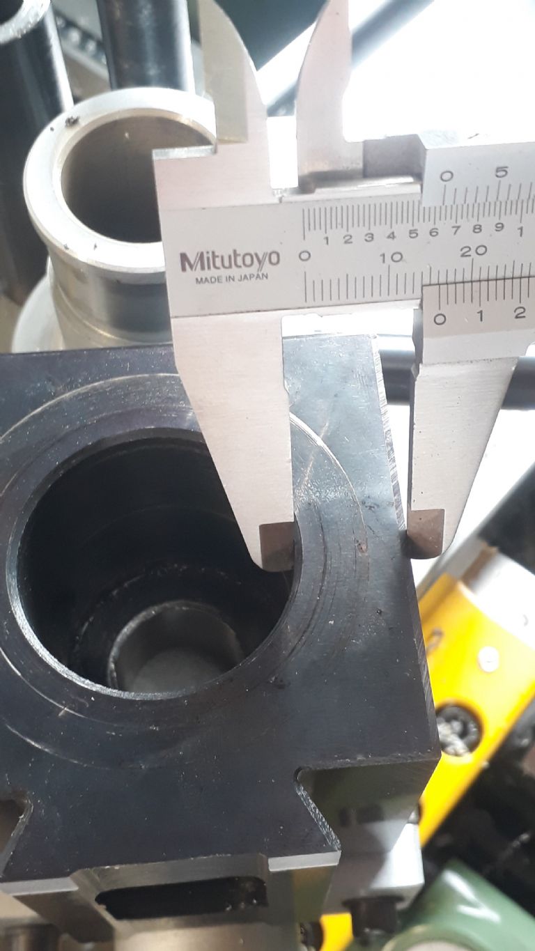

                Be interested to see how you get on with it.
                The arc model 222 wedge option is one of the toolposts I have been considering.
                Can you confirm that they are made of steel?
                Is there plenty of material for machining?

                  @David, I don't mind you saying at all. I'm new to this and any advice is gratefully received. The tool had been fitted for the purpose of evaluating the centre-height, and hasn't been used for any real cutting. I'll adjust it before I do so.
                  @Ian, I don't understand the difference between the two models, so I just went with the one referenced in the MEW article.
                  I'm pretty ignorant about difference material types. It certainly isn't aluminium. I don't think it's cast iron. I guess it must be steel
                  I'll take some measurements for you, but I'd say that there is plenty of material to machine. The base which I had to bore through is a little thicker than the height of the compound post shoulder.

                    Here's the main body of the tool holder
                    The square body of the holder is 66mm across. The bore is 38mm. That leaves 16mm of wall. The base is 20mm thick

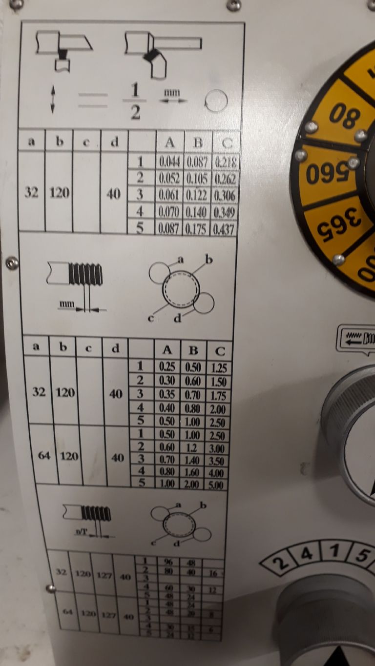

                                                    I'm probably missing something simple here, but it's bugged me long enough to risk embarrassment on a public forum. I have no idea what the numbers in the top left table mean…
                                                    I'd always presumed they were feeds. In mm/s I would guess. There is a suggestion that facing is half the speed of turning, when using power feed, and that is indeed the case. But I can't make sense of the 0.044 figure (setting A1) for example.
                                                    What does make sense is the next table down, which is for thread cutting, and has a value of 0.25 for setting A1. The saddle does indeed move 0.25mm for each rotation of the spindle, I've checked with a dial indicator. I've also cut threads that work, so I'm pretty happy that the thread cutting table is correct.
                                                    But is 0.25mm / revolution the minimum feed rate? I was watching a youtube video where the machinist used a feed rate of 0.03mm / revolution, and checking the specs of his Emco 13 lathe, that is indeed the lower limit of feed rates. Is my minimum feed rate really ~ an order of magnitude higher?
                                                    It almost feels like there should be a change wheel or lever to switch between thread cutting and regular feeds. But I can't find a facility like that on the lathe.
                                                    Hopefully I'm just being daft and missing something simple. Humble pie is my favourite flavour
                                                    Edited By Jed Martens on 23/11/2019 20:52:12
                                                    #438497
                                                    Ian Parkin
                                                      @ianparkin39383
                                                      Jed
                                                      the top table is the feed per rev when using the power feed or cross feed
                                                      the lower tables are when using the lead screw and half nuts
