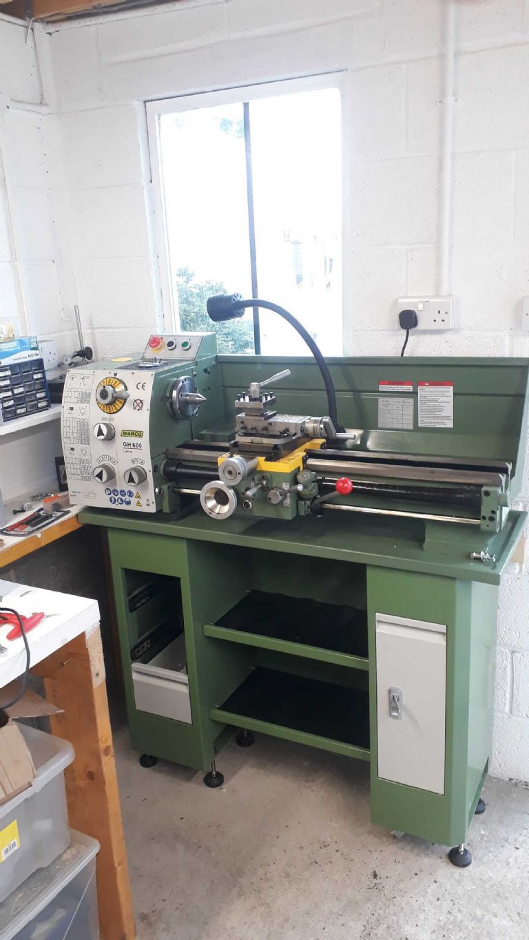

                Here it is in place…
                Still a bit of work to be done. I'be put some machine feet on the stand so that I can bring it up to a comfortable height. I'm not happy with how high they are. I'm going to put some concrete slabs under the feet so that they are at a minimal height, but still offer some adjustment. Then I need to ensure everything is twist-free.
                But I couldn't wait any longer to try it. My first project is a part for a friend's motorcycle stand. It's simple and in aluminium, so a good starter project. Here it is half-done…
                I've taken it out of the 3 jaw because I need to flip it. I'll put the 4-jaw on the lathe tomorrow and see how much fun it is getting it to run true.

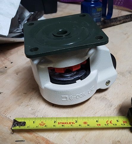

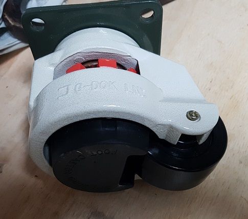

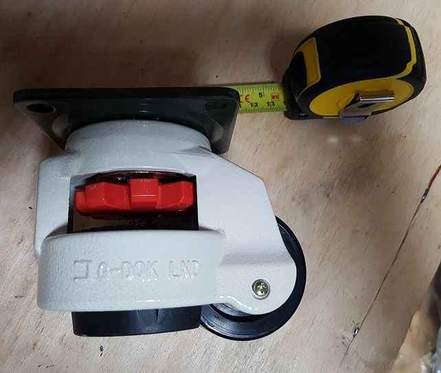

                  I am planning to use these machine casters:
                  103mm high and rated at 500kg each / 1000kg per 4.
                  They have a large central rubber foot that screws down.
                  Probably overkill, but I am going to use 4 on each pedestal to allow for fine tuning the leveling.
                  They will allow the lathe to be easily moved should the need ever arise.

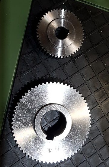

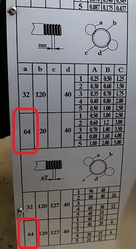

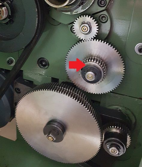

                    There are 2 extra gears supplied in the toolbox:1.jpg
                    One marked 64. I guess it goes here:
                    To cut these threads:
                    What is the other one used for?
                    #423508
                    BC Prof
                      @bcprof
                      Looks to me as if it is the alternative gear for the screw cutting indicator on the apron. Look at the chart on the splashback
                      Brian
                      #423515
                      IRT
                        @irt
                        Thanks Brian.
                        I have removed the splashback to make lifting the lathe easier, and it is resting currently resting on my workbench face down.
                        I missed that chart.

                          Posted by Ian Thomson 2 on 04/08/2019 10:26:38:
                          Ian, where did you get those castors from? could do with some like that for one of my grinding machines.
                          Gray
                          #423538
                          IRT
                            @irt
                            Hi Gray,
                            They are off Ebay. I think they are a clone of the originals.
                            I do not know if I can post links on here, but a search for Heavy Duty Machine Levelling Castors will find them.
                            I made a bandsaw stand earlier in the year to see how good they are, and they worked well. It is a pain to wind the feet up and down so they are not a solution for anything you expect to move regularly, but for a machine that you may have to move occasionally I think they are ideal.

                              Posted by brian curd on 10/08/2019 17:21:54:
                              Brian
                              Thanks for that Brian, I'd spotted that the spurious gear (as opposed to a spur gear) had 48 teeth, as referenced by the splash-back diagram, but it also referenced a 42 tooth gear, and I had no idea where that was. The threading indicator explains it all (unlike the diagram, or the manual)
                              Cheers
                              Jed

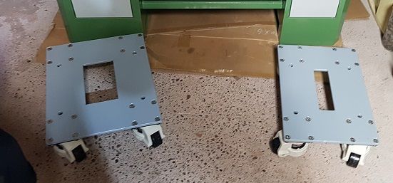

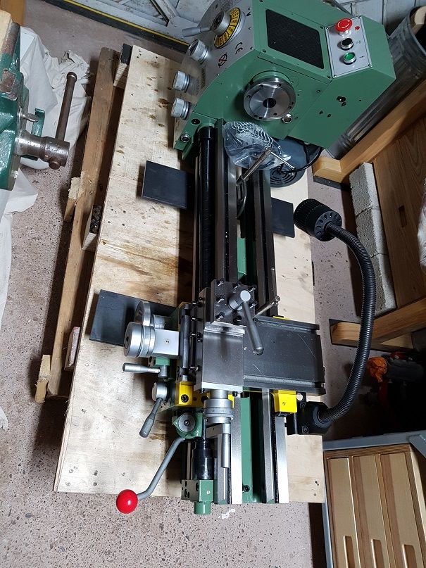

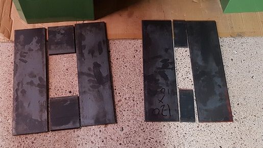

                                I have had a good week…
                                Steel for bases arrived:steel1.jpg
                                The bases were made and bolted to the cabinet.
                                Covers and guards were removed and steel was clamped under the lathe for lifting handles.
                                With help, the lathe was then lifted onto the cabinet:
                                It is good to see it on there.
                                I also purchased some grub screws and nuts to replace the bolts that hold the chucks on. Now there is no guessing which hole to use and fiddling with allen keys. Much easier.
                                Edited By Ian Thomson 2 on 11/08/2019 13:40:06

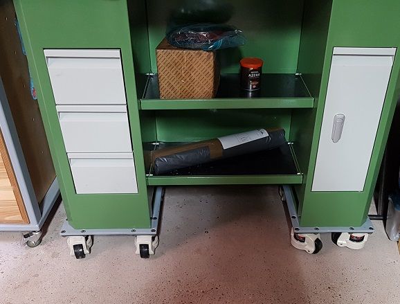

                                      A bit of an update in the casters: The lathe is now in the final position with feet wound down.
                                      I have adjusted the feet to remove twist using a cheap Engineer's level.
                                      If I push the lathe backward, there is a very slight wobble on the rubber feet – probably to be expected.
                                      It is very little movement, and the lathe appears to return to no twist when I stop pushing.
                                      I will evaluate over the coming weeks if this has a noticeable effect in use.

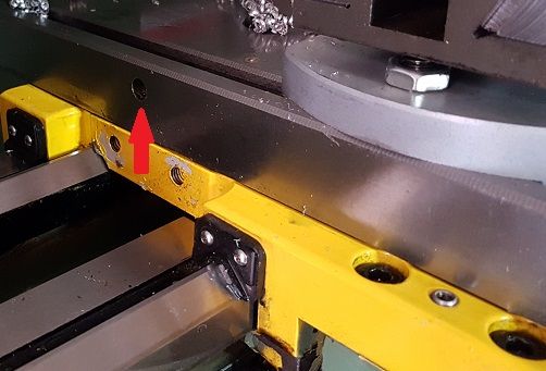

                                            While you are counting your ball oilers, can you find the cross-slide lock?
                                            Is it at the bottom of that hole on the left hand side of the cross slide?
                                            I tried poking in one of the supplied allen keys and it didn't reach the bottom.
                                            If it isn't there, where is it?

                                              There's a cross-slide lock??? I found the compound lock, but I didn't realise there might be one for the cross-slide (stop laughing, it's my first lathe). If there is, the combination of a lock and power feed spells trouble…
                                              #423665
                                              BC Prof
                                                @bcprof
                                                Cross Slide lock should be on the right hand side , Three cap heads , Counting in towards the bed the first two are for the apron the third , closest to the bed it the lock. Turn it with the allen key. Well that's the theory .Mine tightens up does not enough to firmly clamp the slide !
                                                Also note that I have advised Ian and Jed to remove the screw at the end of the cross slide feed screw. It acts as a stop to prevent the slide winding off of the thread but it forms a hard stop. The system has no shear pin on this axis . The gear on the feed screw is held in place by a roll pin . I considered changing it for a shear pin but felt that the shaft diameter was a bit small to drill out for a larger diameter pin.
                                                Brian

                                                BC Prof
                                                  @bcprof
                                                  Brian is Brian of very little brain ( again )
                                                  The cap head locks the carriage not the cross slide . Th comment about the lack of a shear pin on the cross slide feed still stands

                                                  IRT
                                                    @irt
                                                    I would hope there is a lock.
                                                    I think there are loads of opportunity for disaster. Wouldn't this be a similar risk to the lock on the carriage?
                                                    My guess: this is it, but it could be a backlash adjustment:
                                                    I would have expected it to be on the other side though.
                                                    I will investigate tomorrow, unless someone knows?

                                                    BC Prof
                                                      @bcprof
                                                      Just done some measuring . The blind hole shown is JUST above the level of the top of the dovetail so even if it went through and was tapped it would not lock anything. It would however act as a drain for any cutting fluid going into the left hand T slot since it opens out into it before going deeper in .
                                                      Brian
