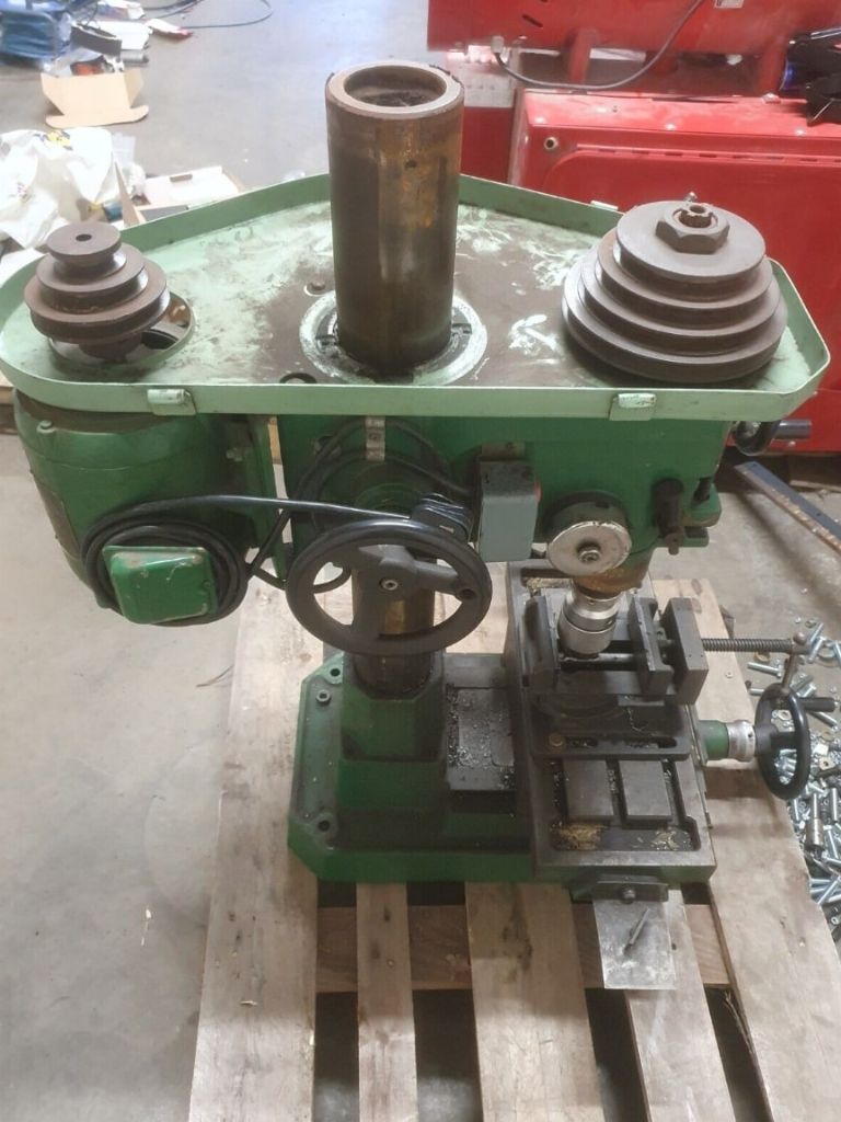

      I have just got a decent looking warco economy mill for £50 but needs a few things.
      1. no belts
      2. height adjustment handle missing.
      3. possibly might need other things fixing like bearings etc
      Anyone know where or what type of belts and handle i would need.
      Thanks

          I'm afraid the standard belts won't be of much use without the missing pulley set.
          Edited By Dave Halford on 05/09/2023 19:55:06
          #659257
          DiogenesII
            @diogenesii

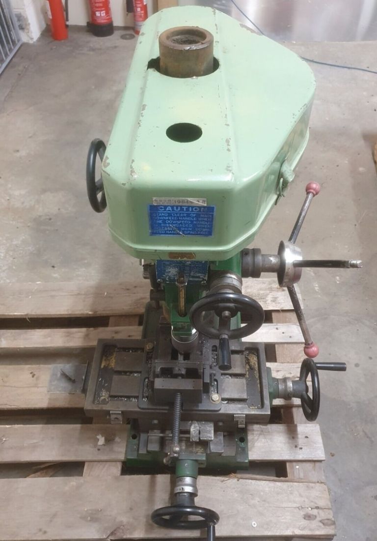

            A couple of more important bits that are missing are;
            ..the intermediate cone pulley and it's bracket (which fits around the column)
            ..and the rack for raising the head..
            Do you or the previous owner have them?
            Edited By DiogenesII on 05/09/2023 19:52:10
            #659259
            Bizibilder
              @bizibilder
              You also seem to be missing the entire jockey pulley assembly. This is a four step pulley that is mounted so it can swivel round the main pillar and give you all 8 speeds. There is a manual for the RF20 and 25 here: MANUAL that should help you as this is the "generic" machine type that you have.
              Edited By Bizibilder on 05/09/2023 19:53:40
              #659264
              jay g
                @jayg67738
                Thanks guys for the knowledge. I don't have the missing parts and i doubt the seller does as it's sold as is. Did i just waste £50 smiley or you reckon it's still worth trying to get it fixed up if possible to find the parts.

                  Well worth getting some power to the spindle and fix the rest with some TLC.
                  Emgee
                  #659272
                  Bazyle
                    @bazyle
                    It is worth way more than £50. Any 4 step pulley and a bit of engine-uity can sort out the drive. Measure the belts needed once you have that sorted out.
                    I would use a scissor jack for lifting the head for the time being. You can make a rack using your lathe as an horizontal mill because it can be very low precision and even made in sections.
                    #659273
                    jay g
                      @jayg67738
                      Looking about i see 4 step pulleys around the £30-60 and could knock up a bracket with some plate so not as bad as i thought.
                      Will keep you all updated as it moves along.
                      Thanks everyone that replied

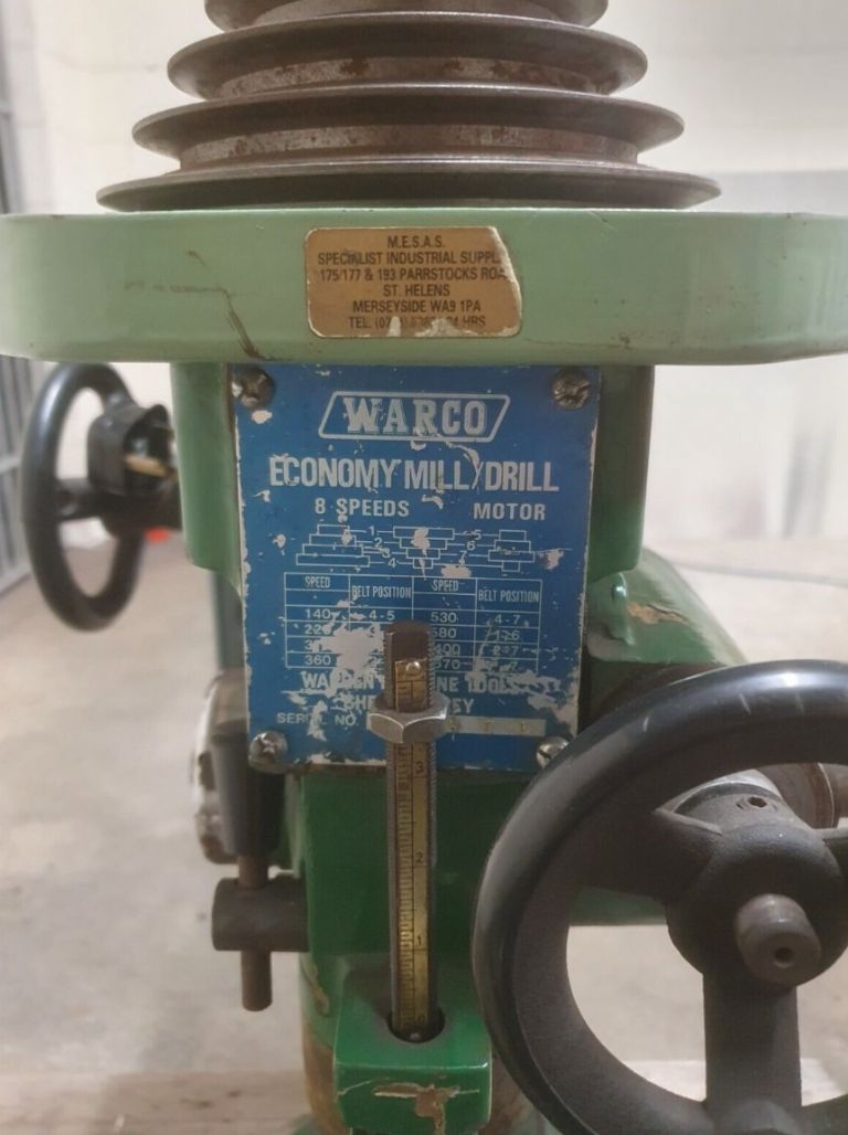

                              The belts listed for the RF25 Mill Drill are Primary is an A31, (A790MC ) and Secondary is an A38 (A990MC )
                              Presumably the figures in brackets are the Metric size equivalents.
                              But you need nthe correct size pulley for the Intermediate Jockey.
                              The pulley sheaves are numbered 1, 2, 3,4 with 1 as the top sheave on the Spindle pulley.
                              The top sheave on the motor pulley is 5, with 8 being the lowest.
                              Having measured the pulley sizes, the speeds may enable yhou to workout the sizes of the Intermediate pulley, from the speed ratios.
                              Belt Positions / Speeds for RF25 Mill / Drill follow in the next two posts
                              Sorry that the table overlaps the page. Wasn't like lthat when copied.
                              Howard

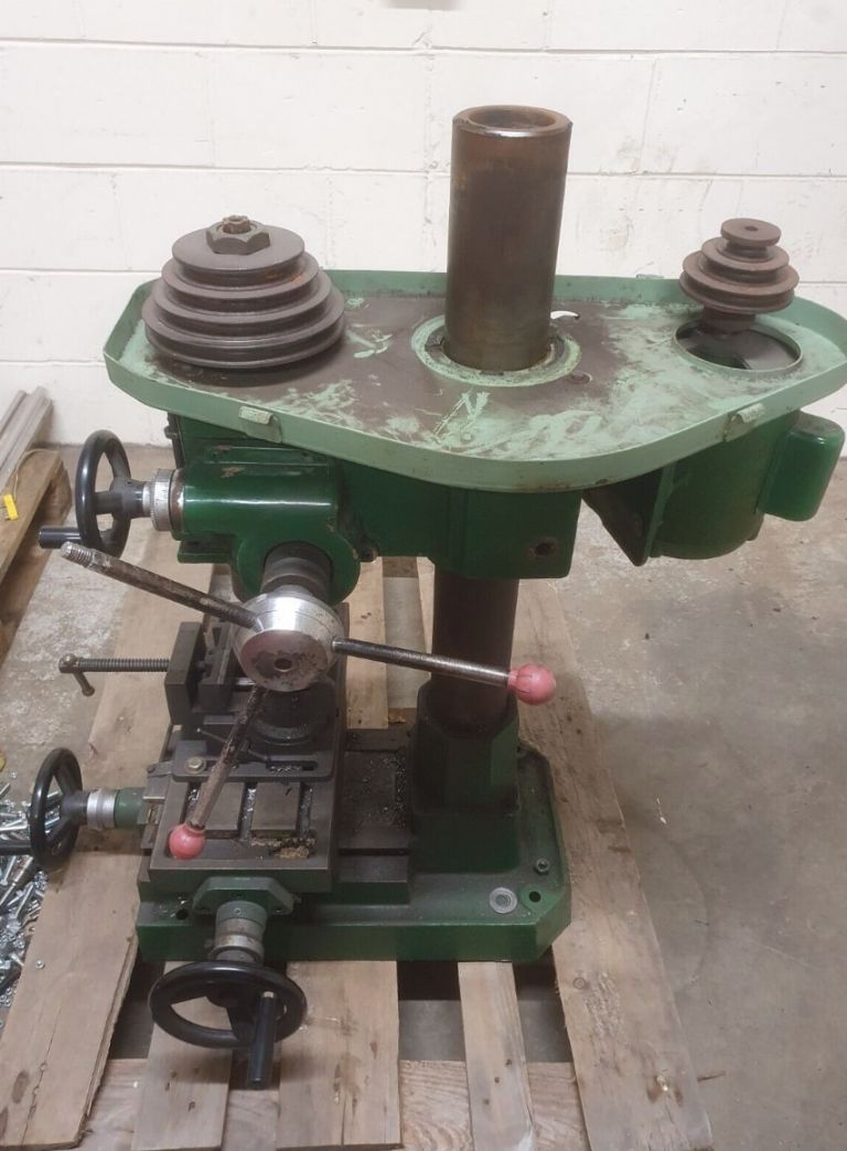

                                                As i am needing a few things done and researching more on these generic mill's i thought about doing a few upgrades.
                                                instead of getting the pulley replaced might go 3 phase with vfd and single belt with matching spindle pulley. That should bypass the column.i have seen a few other guys do the same and saves me changing belts.
                                                Most of the time tbh it will be used as a drill press and have capabilities of milling when needed to save on space.
                                                Thanks for the extra info some of which i have found and other's i have not.

                                                  You sound like you have a plan, but look carefully at motor spec' and ratio's carefully if you want to retain a useful slow-speed milling capability with just one direct pulley-pair..

                                                      Looks to be older than mine, which is 20+ years old, and a slightly different design.
                                                      But as long as it does what is needed!
                                                      The bracket for the intermediate pulley is cast iron and can crack if overtightened.. I put lerge washers under the bolt heads to spread the load more.
                                                      The RF25 appeared in many colour schemes for a variety of importers.
                                                      Rong Fu might even be able to supply the pulley, bearings and bracket, perhaps?
